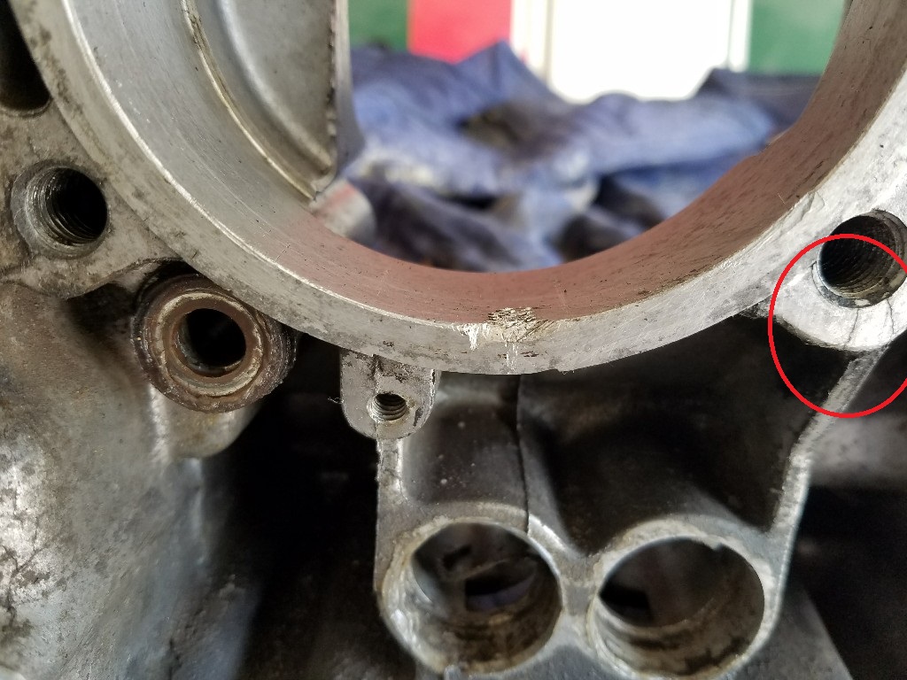

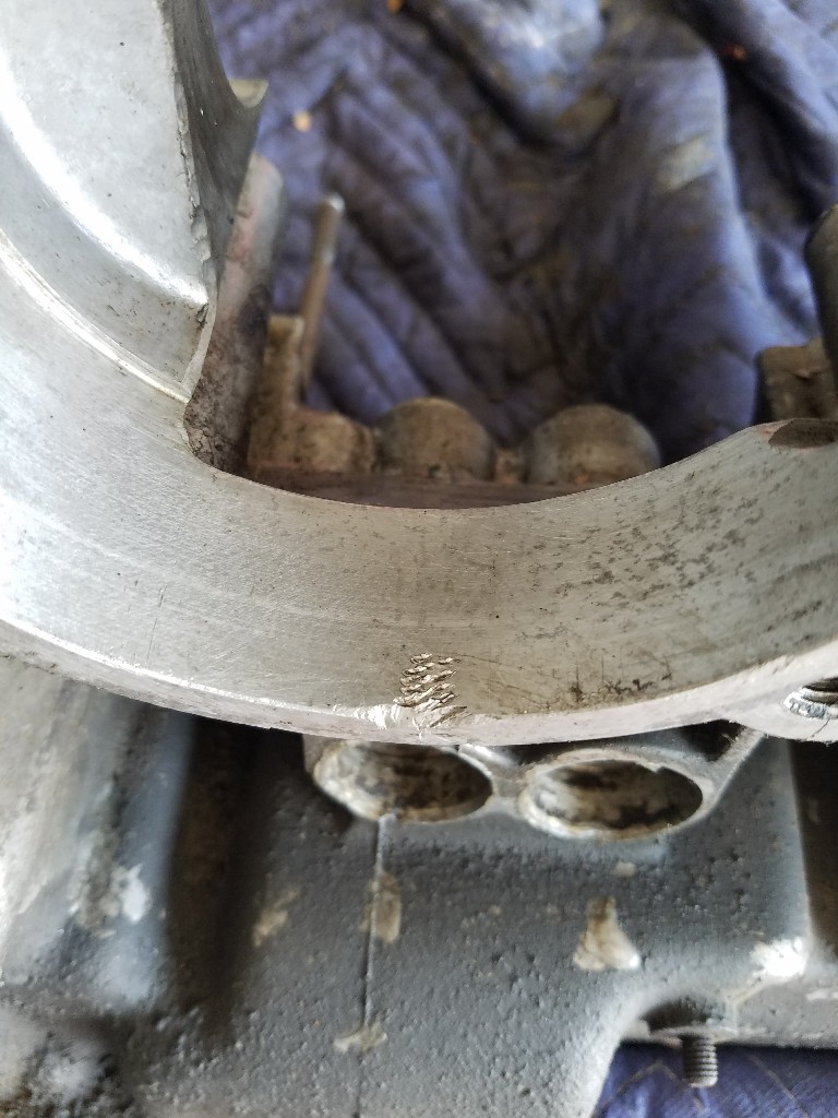

Wanting opinion from the engine builders here. Is this case shot now with this metal gouges on the barrel mount? Piston was completely rusted solid in the barrel so had to cut the rod to get it off. Woops!!@$@*

No,that area could be cleaned up with a small half round file.

For the ID of the hole, I'd work the metal slightly with a small hammer then run a bearing knife , single edge or similar around the ID to clean up any loose metal. I would not try to remove metal in an attempt make it smooth again, all you need is for the barrel not to catch.
For the sealing surface face I'd tap down any high spots, scrape off any loose metal and leave it at that.
The goal is to reform metal not remove it.

You would only be carefully removing the high spots,I didn't say to hog the area out with a file ???
McMark recently did the same sort of thing on a damaged piston...he knows what he is doing.

Thanks guys for the professional advice here.. Awesome website. I was about to toss the case to the recycler and salvage all the rest of value and thought the biggest value is that damned engine stamp on the case in the event I restore this thing to numbers matching later. You helped make that decision easier for me. Heck it might be my first Type 4 rebuild on the horizon.

A little JB weld to fill in the low spot won't hurt either. fill and smooth...no more worries.

The face is the main sealing surface. Tap the high spots down to smooth and use a sealant like yamabond when putting the jugs back in.
I am becoming a bigger fan of the JB Weld products and that is a great suggestion. Thank you.

I wouldn't use JB weld there. With time vibrations and heat cycles, the JB weld pieces will brake loose and work the soft metal.
Just make it flat and use a sealant. There's nothing to worry about.

JB weld it, remove all the case interior studs and take it to a good machinist, have them deck the bores just enough for cleanup.
I'm finding just about every case needs this service anyways, 40 year old cases sink in the middle between the bores.
Even if the JB weld was to fail it's trapped and won't go anywhere.

You might want to look closer at this area
crash914
Sep 5 2017, 08:08 AM
Looks like casting flash to me. Best to inspect to be sure.

got to be careful, we can't recommend it too often.
Although I have used it in my case to build up some low spots on the jug registers and other places. I have also used it to repair a front spindle on a truck for a the wheel bearing. Still running strong.

I said to tap down high spots to reform then remove loose metal by scraping. ( IE flakes )
You only said to remove metal. " No,that area could be cleaned up with a small half round file. "
