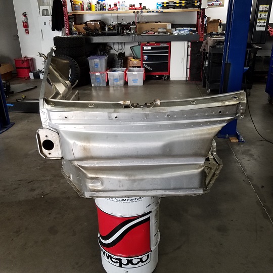

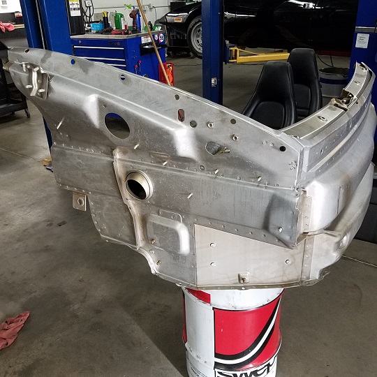

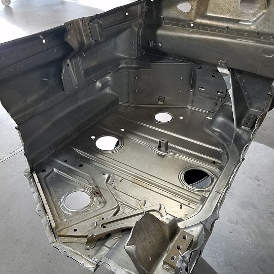

I just scheduled the third Rothsport 964 rally car for dipping in November.
I had a trunk/spare tire nose test dipped for $200. They got all the new PVC undercoating. But it too about twice as long. Which is more money $$.
I'll shoot a picture in the am when I drop off Doug's 914-6 engine tin.
Stunning when compared to to the 100's of hours spent on doing it manually after having them attempt a strip with walnuts. Walnuts don't touch the PVC.
Wont be e coated, just epoxy primered.

cary
Oct 7 2017, 08:56 AM
Stripper Porn
Here is a few shot of the nose section we sent in for a dip.
Click to view attachmentClick to view attachmentClick to view attachmentThat entire section was coated with the new generation PVC undercoating.
