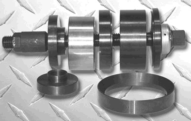

We're going to give it a shot. I have the late model 911 tool.
We'll if I can use some of my other bearing tools to create the pull and push I need.
I too don't want to pull my trailing arms.

Shift into neutral when you hear the noise. If it disappears it's your transmission. I bet it's the wheel bearing though. If it disappears when you turn one way or another, then it's very likely the bearing. And yes, you can change them without removing the trailing arm. I made a tool using an allthreaded rod and a bunch of big washers/bolts to press out the bearing. I replaced both bearings for continuity sake. Removing the first one was a huge PITA, but after figuring it out, the second one was easy.

Yes. Just did two two them. Biggest problem is getting the axle out. Not enough room. Pulled the hub them the bearing with a slide hammer, pulled the new bearing and the hub back in one at a time with a big threaded rod and washers we made the right size.

You probably don't remember selling me that tool that removes the bearing. lol-2.gif Just a piece of all thread rod with some nuts and a plate, IIRC. I think I sold it at an old G&R after I purchased a press.
