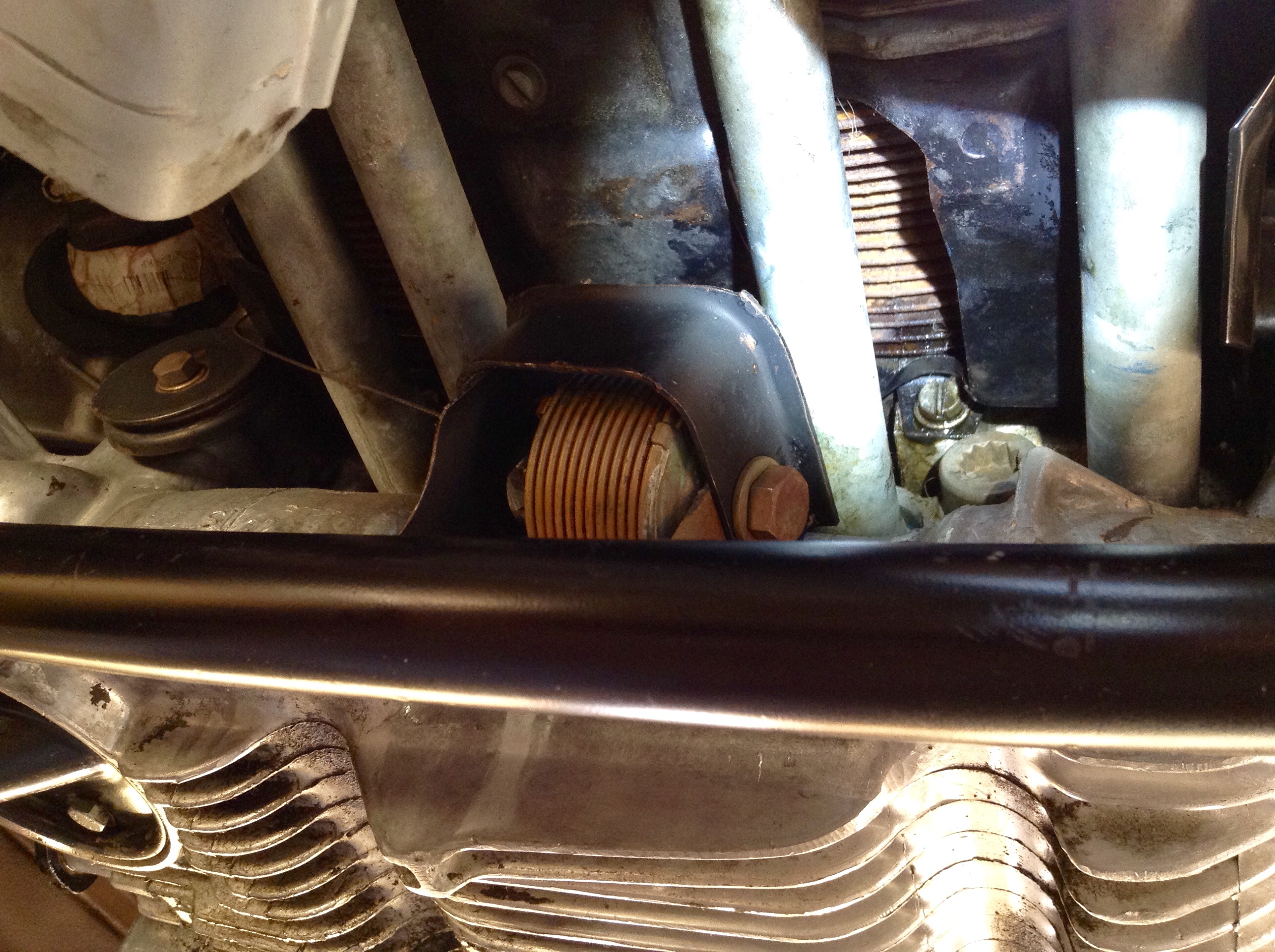

Thanks for the additional comments. I pulled some of the tinware to get a better look and found very little accumulated oil. Two of the outboard pushrod seals appear to be slightly weeping. I did find what may be the source near/above a pushrod. Here is a photo.

(1) It looks like the leak is from the base of the cylnder barrel, not from the pushrod tube from those photos.
(2) The cable for the thermostat has come off the big pulley and needs to be put back on the pully for the cooling system flaps to function properly.

Ha! I was wondering I'df someone would catch the wire off the pulley.
Thanks for the comment. Looks like the leak is very slow and not likely to start spewing.
Given its location. The head is well secured and I torqued all the nuts when I had the engine out.

agree.gif looks like its leaking from somewhere above and running down,clean it till spotless,start engine warm @ idle ,the oil will run pretty much downwards from the leak,I place a piece of white cardboard under the engine when trying to trace difficult leaks.
