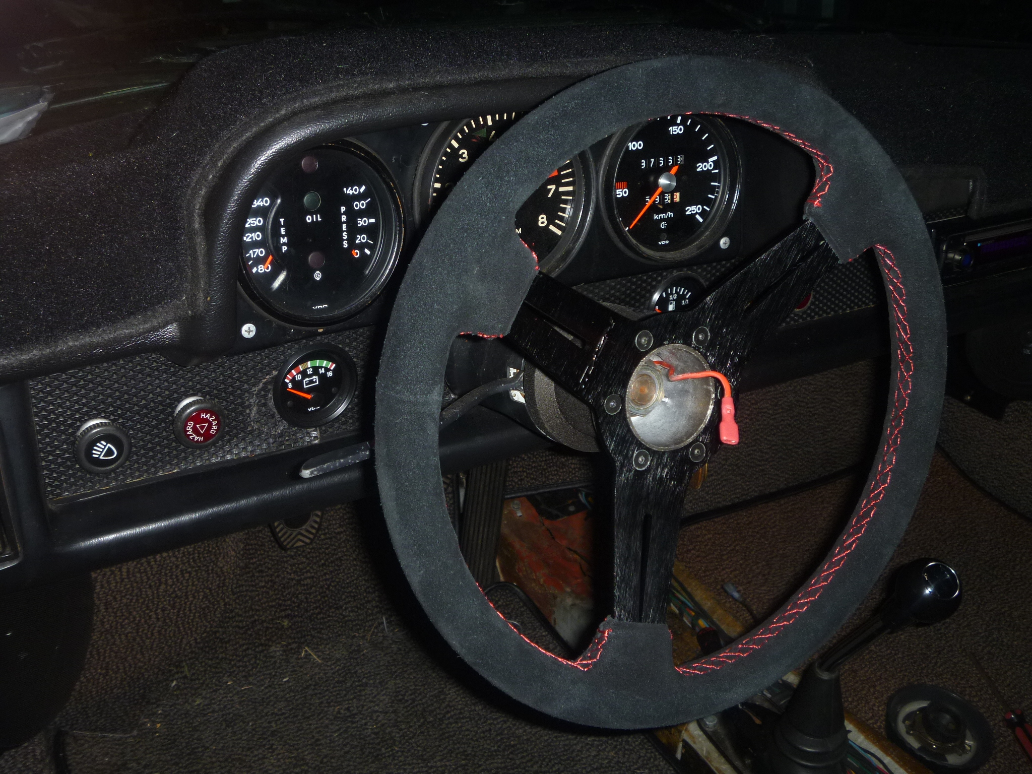

My original wheel removed to give my long legs some room with the smaller aftermarket wheel ;
Its just not hard to see its poorly made,atleast without adding spacer I had the horn sounding without contact ring until the fuse was pulled ....says it all sad.gif .
