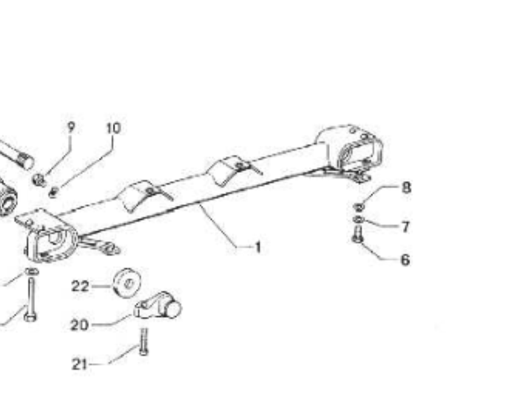

Seams I'm missing bolts on my new project ! Number 6,7,8 any one know what will fit and do I need a shoulder boltClick to view attachment
Don't remember the size but i have seen them missing many times since that's where the belly pan attaches to and a lot of people remove it for easier access and forget that those bolts also hold the suspension tabs in place.
falcor75
6: M10x20
7:Lock washer
8: Washer

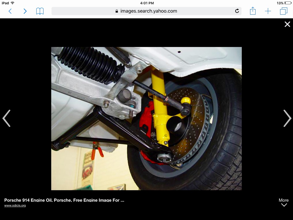

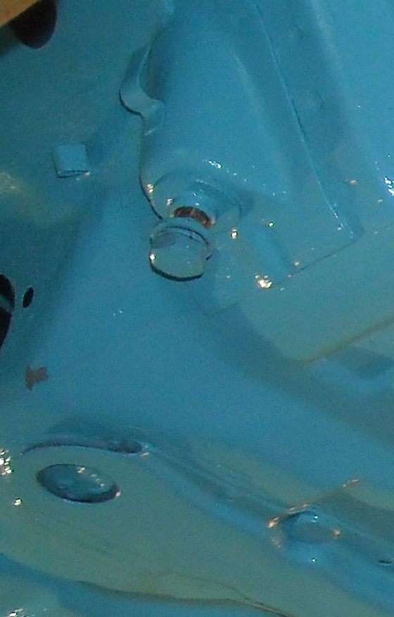

Thanks for reply. The tabs seem to have quite a large hole what keeps the bolt centeredClick to view attachment
Olympic 914
The suspension mount goes over a shoulder piece that is part of the tub.
Luke M
The bolt is a M10 x 20 mm x 1.5 , M10 lock and flat washers.

QUOTE(Olympic 914 @ Oct 15 2017, 06:12 AM) *
