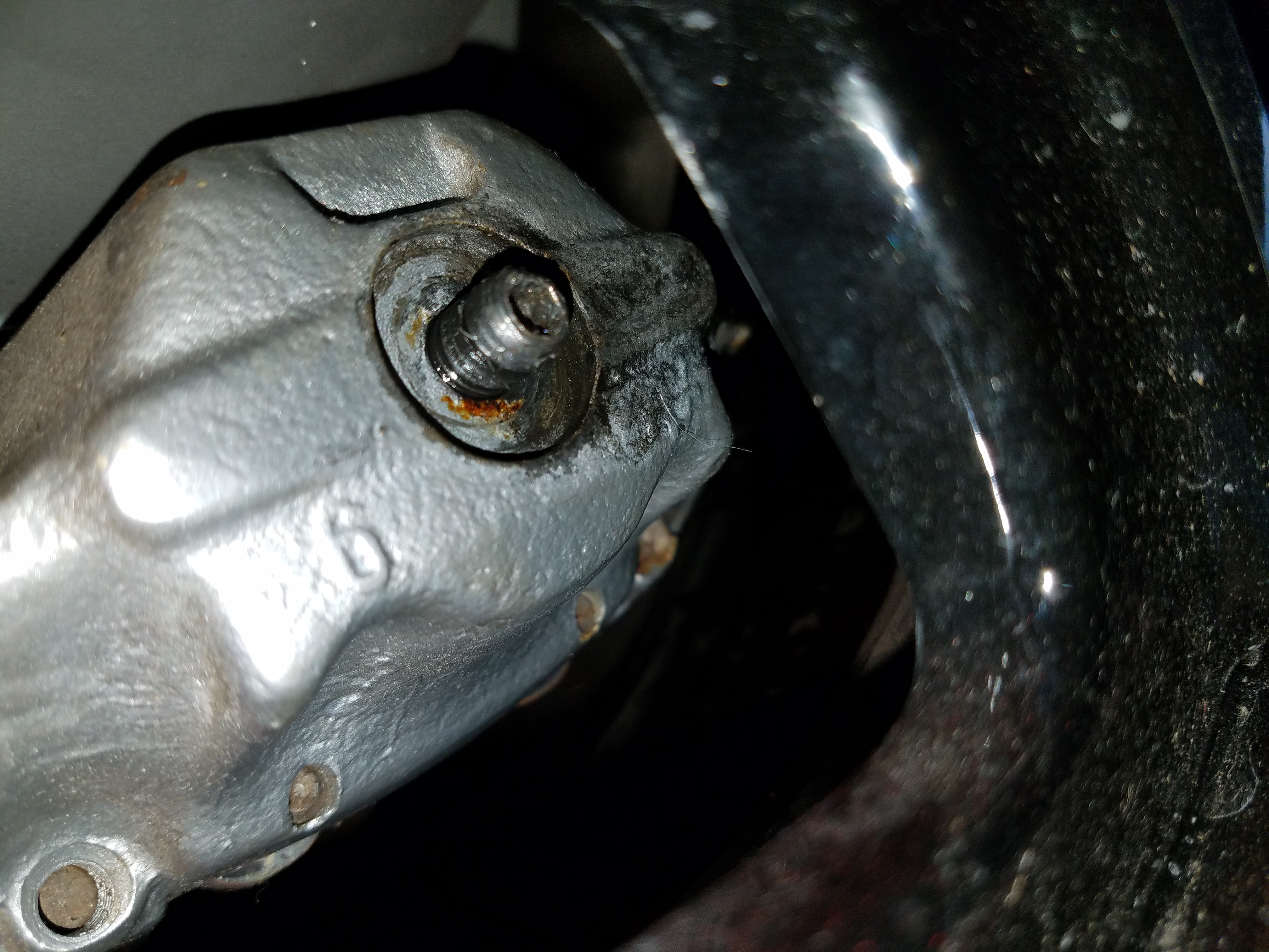

So I have a slow leak driver side brake caliper on the adjuster. It doesn't matter if I turn it all the way in or all the way out. It still leaks a little. Especially after driving. I think I'm missing a washer or something that goes around that adjuster to hold it in place and maybe also stop the leak. Any help or suggestions would be awesome.Click to view attachment
I had the same thing a month ago. Eric Shea told me the small O ring on the adjuster, inside the caliper, hardens up after 40 years. I put on a set of pmb restored calipers to solve the problem.

Looks like the small C clip on the adjuster screw is missing. That could be the source of the leak by not keeping the screw pull snug to the caliper housing.
Eric_Shea
O-Ring, 13mm (M8x1.25) Thin and a C-Clip. Give us a call and we'll hook you up.
