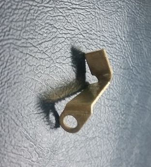

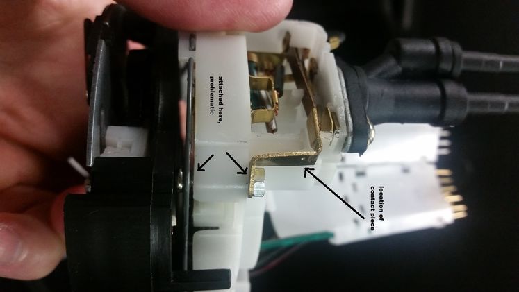

2. This guy came attached to the signal side of the stalk as pictured beneath it. The original version of the same part had no such "contact" part, and I don't know what to make of it. It is secured by a screw that if left in place, would prevent the anchor screw from securing the new stalk parts to the column. So go figure, I am completely stumped here.

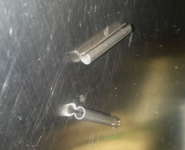

3. I have four of these cylinders which came from the old parts, but are not part of the new parts. Two are slotted, two are solid. If I were smart (hopefully I made it clear that I am not smart) I at least would have documented which corners each of these emanated from. Alas, I have no idea. I don't even know if I need them anymore. They ran the length of the anchor screws, like sleeves, kinda tying the two stalk segments together.

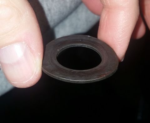

4. I was completely frustrated last night as I tried desperately to install these parts. Once I officially gave up for the day, I looked down on the floorboard and saw this. Of course I assume it came from the column, but I have zero recollection as to where exactly it belongs. Geez...I suck.

I'm pretty sure the washer in the last picture is the wavy washer that goes under the nut that secures the steering wheel.

I was told that the bolt and nut were only for shipping to keep that little contact piece in place. At this point, since I can't remember differently, I have to assume that's the case.
I also seem to remember that those cylinders are needed and are maybe inserted into the new part confused24.gif ? Might be how the signal grounds.

Those spacer tubes go through the larder holes in the plastic housing,1 of them is an earth connection to the steering column...rather important.
Their purpose also is to stop the housing being pinched up when the screws are tightened.
That bolt on metal tab should be held on by one of the 4 mounting screws.

1 & 2) I don't remember dealing with those on my replacement. But, I also moved my horn button. So my horn doesn't function in the factory way anyway and anything related to that byzantine system was ignored during my replacement.
3) BeatNavy is right and those sleeves are important for the horn grounding. They should insert into the wiper switch and the turn signal switch should sort of seat on them. The screws go through them. I can't see how the split/solid ones would make a difference as, again per my recollection, all 4 of the flathead screws are the same size.
4) Definitely the washer under the steering wheel bolt.
