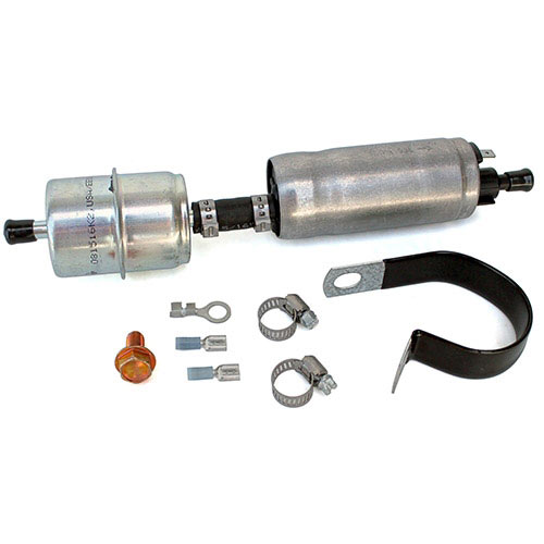

CB Performance has a rotary low pressure pump with filter, that's what i ran on my 2056.
http://www.cbperformance.com/product-p/3193.htm
IPB Image

Running that same Carter pump from CB Performance on mine as well. Constant correct pressure. I would recommend removing the supplied filter and either relocating it, or replacing the clamps at a minimum. I've seen a couple of them leak at those fittings fresh out of the packaging.
And i forgot, whatever you do, please don't hack into your wiring harness!
You can mount and power the low pressure pump in the same spot as the FI pump and even use the same wires, fuses and relays without ever cutting anything.
