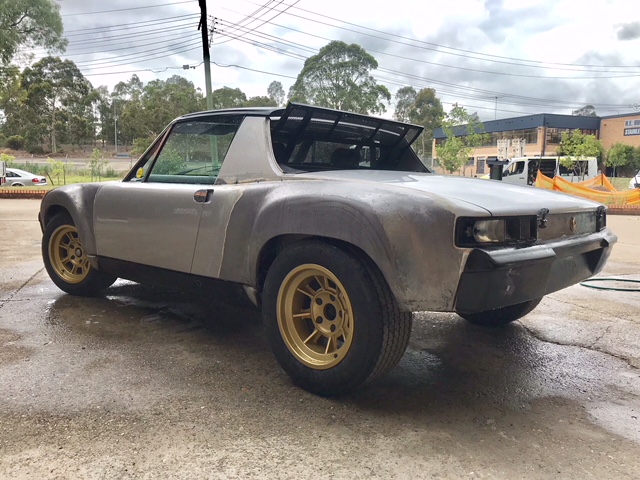

I have a narrow body 914 and I can fit 16x7's front and rear, so if you go out of your way to install flares it only makes sense to use wheels that will fit correctly with your flares. So 15x8 or 16x8 in the front and 15x9 or 16x9 in the rear should work. Otherwise, what's the point of flaring the fenders if you're going to run narrow, goofy looking wheels? And if you can fit even wider wheels, do it, these cars look best with the entire wheel well filled....
mph911
Not Fuch's but same offsets....my work in progress on 8 and 9in Group 4 Wheels with Michelin TB15's..
