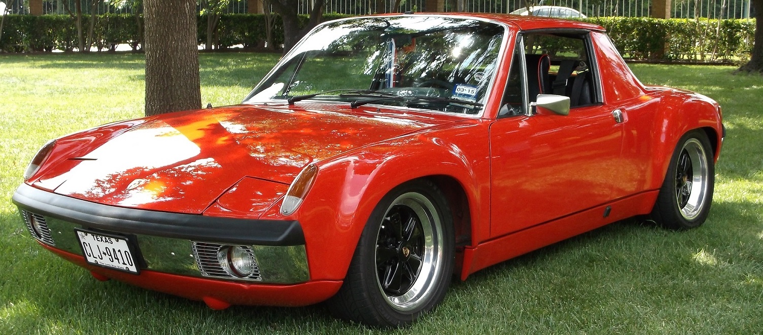

So far I’m the only 7X16 front 9X16 rear. My rears are actually custom built Weidman 8.5X16 but that isn’t a poll choice. My reason for going with these is tire option availability and the fact that it perfectly fills the wheel well in the rear.
What's with the smoke screen? Great looking car.
Diesel powered?

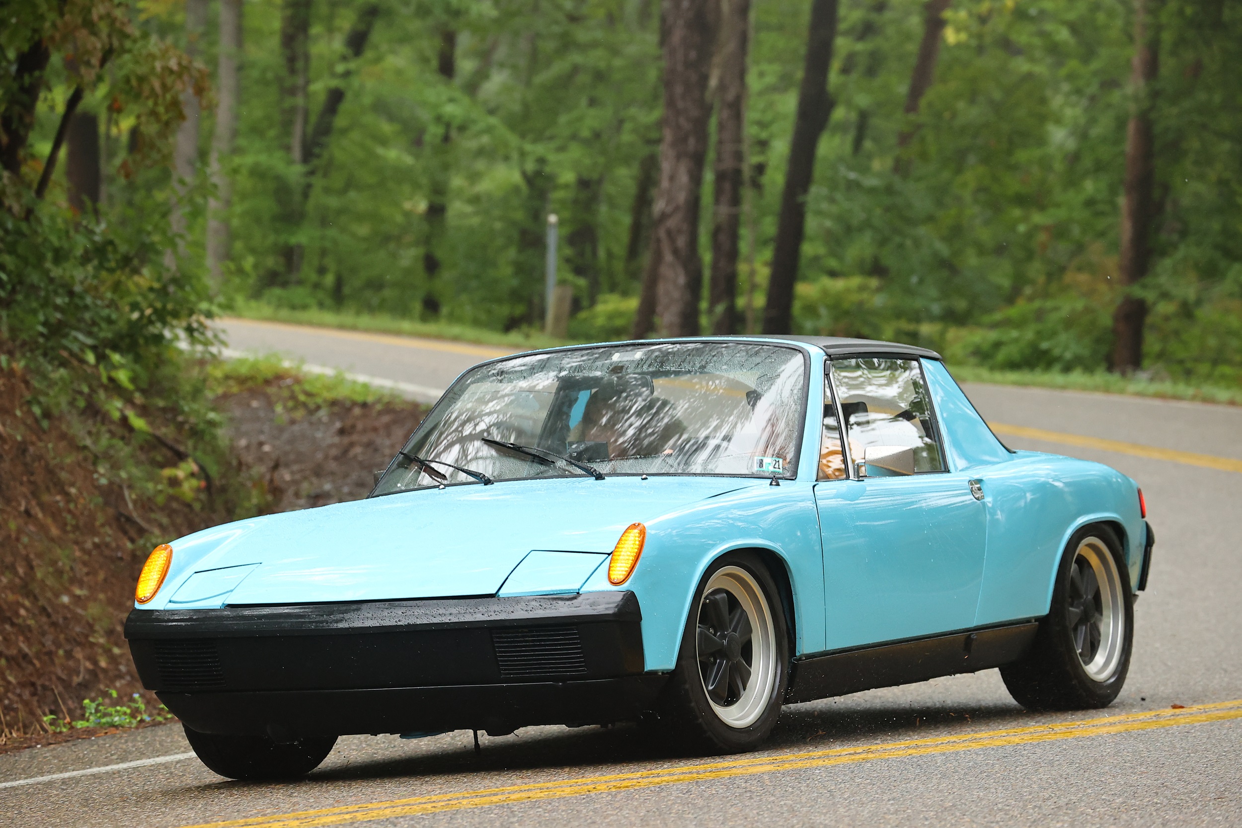

Looks like 6s & 7s x 16"

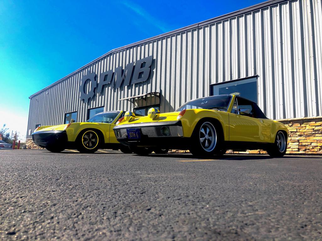

a nice new pic below! this car almost makes me wish I went with yellow unsure.gif

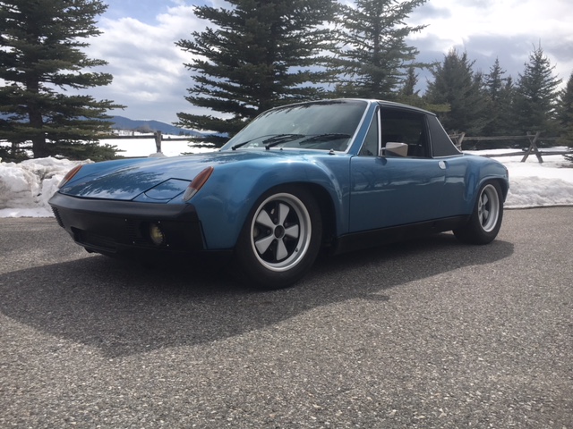

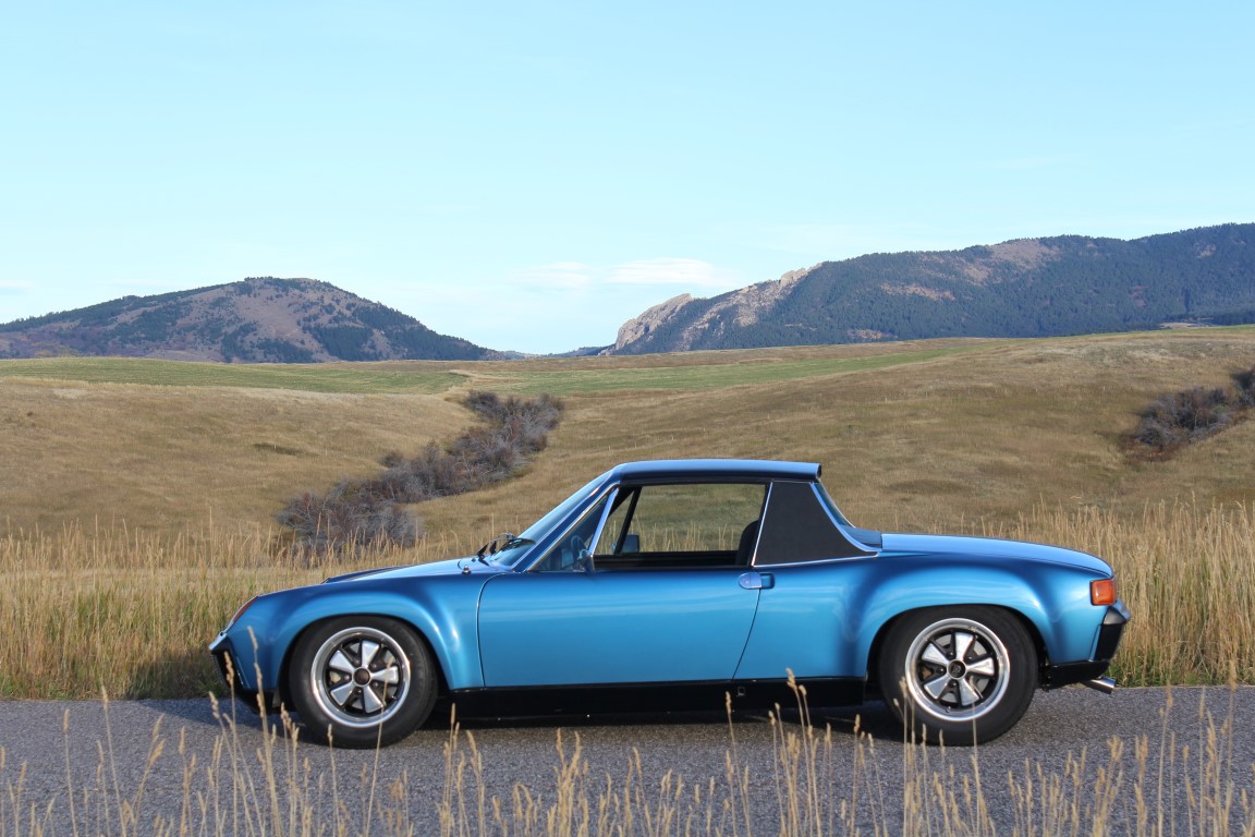

7s and 8s x 15 with 206 60 and 225 60
gothspeed
QUOTE(mtn flyr @ Apr 28 2018, 09:45 AM) *
Any side view pics of your car?
QUOTE(mtn flyr @ Apr 28 2018, 12:45 PM) *
I used to like slightly lower profile but now I think the 60's are the perfect size.
mtn flyr

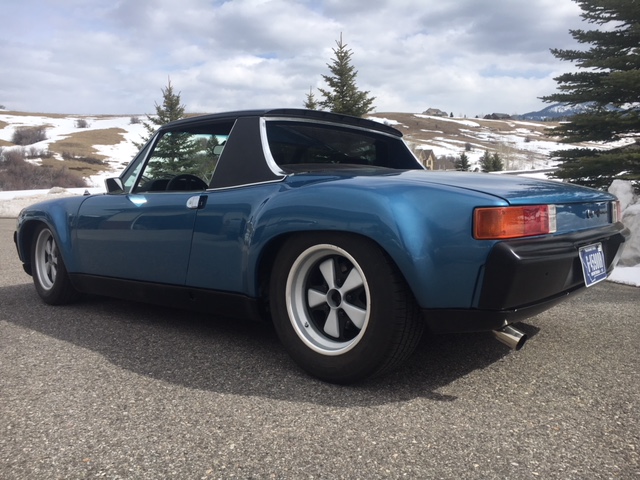

QUOTE(mtn flyr @ Apr 30 2018, 06:50 PM) *
Are you running BFG Radial T/As? Been wondering how T/As are on a 914...as they look super right because their design goes so far back. I have long wondered if their compounding has been improved, and how they stack up against other "vintage look" options out there (Pirellis, Avons) as well as some of the more modern options.
Thanks for posting, and any feedback you've got would be more than appreciated!

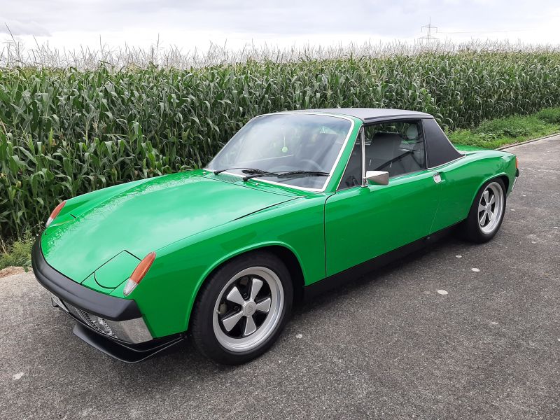

HaraldD
Hello,
these are exactly the wheels on my narrowed body car like above, from 944 Turbo
7x16 with 195/50-16
8x16 with 205/50/16
Harald
Olympic 914
7 x16 8x16 944 Turbo wheels same as above.
But with 205/50-16 F
225/50-16 R
Speedo reads 5mph high at ~70 mph

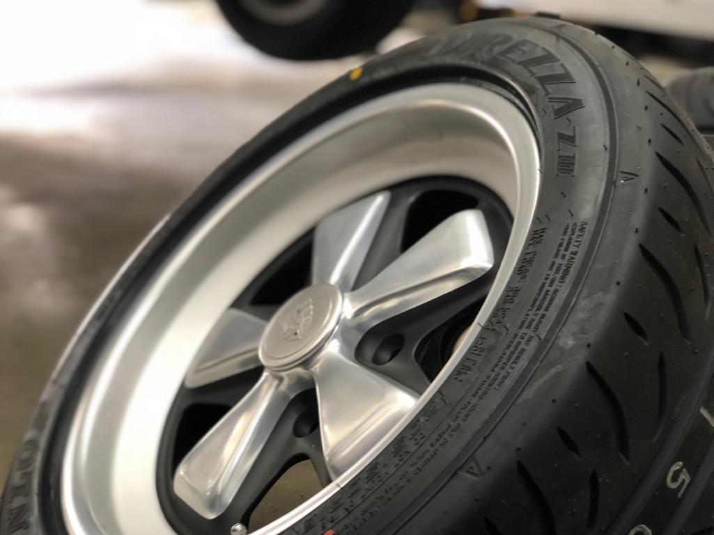

No spacers. Sorry it took so long for me to post the size of the new tires that Eric picked out for my 16s. I think they look very good.
Size and brand.
Misc.
225/50R-16 DUNLOP DIREZZA ZIII SL
Misc.
205/50R-16 DUNLOP DIREZZA ZIII SL
Well, this is the first day I was able to get a feel of these tires and I think that they are outstanding. That and the Elephant suspension up front and in the back.
