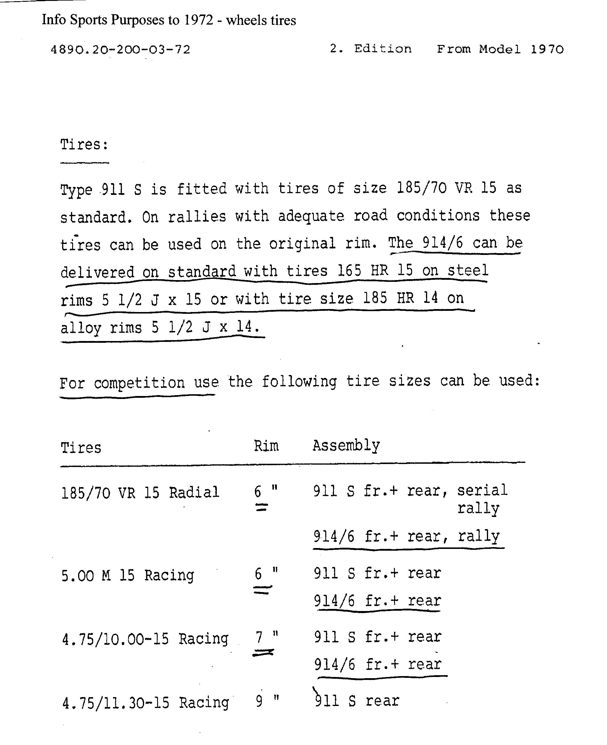

Factory specs - for those intent on duplicating originality
Click to view attachment .

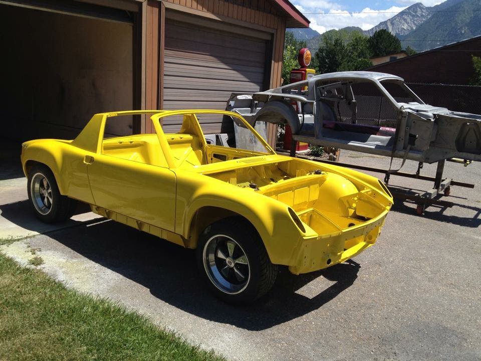

Just thought I'd post some pics of the # 2 option above.
Edit: just adding a quote of a later post that mentions tire sizes for this yellow tribute
QUOTE(johnhora @ Jan 25 2018, 07:09 PM)
I "talked" to Eric Shea and he is using 195/65/15 F and 215/60/15 R on his beautiful yellow 914-6 GT...this was mainly because he had some 7/8x15 Fuchs with tires on them from a 911 and they worked and no added extra expense....I'm all for that.
Jan 22 2018, 02:10 PM
Even better in person.
