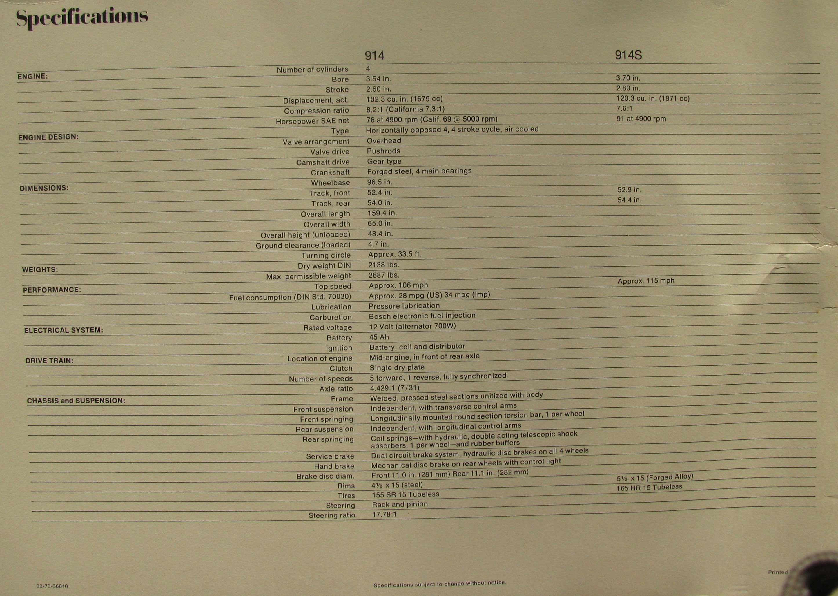

No Dave - that is incorrect, except regarding the badges.
The "914S" was used at ALL dealers throughout the USA up to sometime in early 1973 by VW of America (VoA), who owned Porsche+Audi back then (deja vu to VW's ownership now) - not just by "some dealers" as you said. It was also used by Canadian dealers too IIRC, as well as similarly in Japan as "S"/"SL", & in the UK as "914SC" during all of the 914-2.0 73-76 MYs - but Japan & UK were never told to stop by Porsche AG. it was in fact printed as "914S" on ALL of the USA Porsche+Audi 914 sales brochures & materials for about the first half of the 73 MY - see pic of just one of the brochures back page below (also IIRC on Canadian marketing materials) It was likewise definitely used for Japan "S" or "SL" & UK "SC" markets as noted above), as I've also seen sales info for the Japan market using "914 SL" (see my 914S" topic in the O&H Forum for documents etc.).
However, the "914S" was basically only a "trim package" - wherein you got both the Appearance Group & Performance Group of options "for free" within the base price of the car (ergo "N/C" shows up on the window stickers for the AG & PG & any listed "included" options), but "2.0S" nor "914S" generally won't show up on the COA (but a few have). They included those extra AG & PG option packages in order to attract the former 914-6 market for the also 2.0L -6 - over to the "new" Mezger re-engineered 2.0L -4 engine, after cancelling the -6 after the 72 MY, & notably the AG & PG were added cost options on the-6's for 70-72 MYs.

914 USA Dealer Sales Brochure, Back Page:
