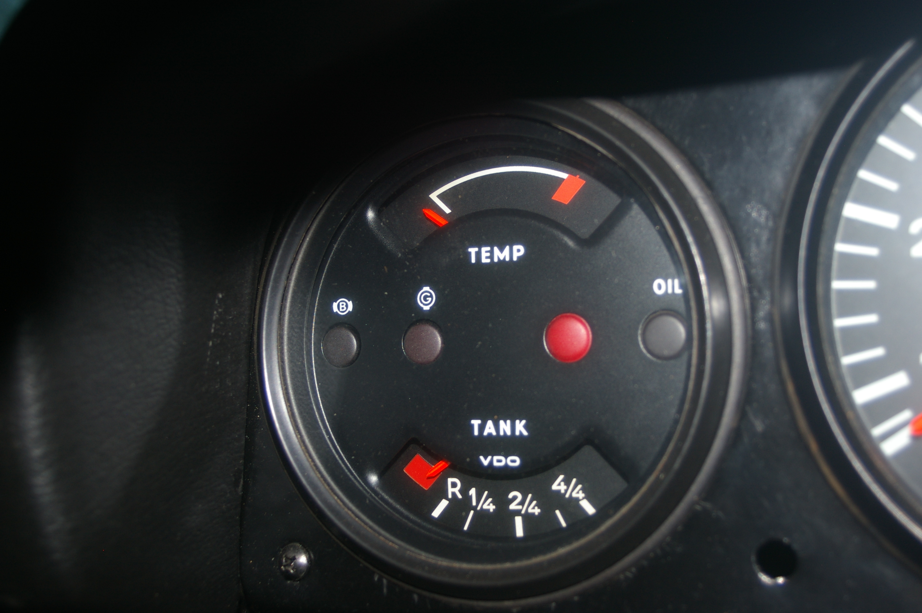

I assume you are talking about oil temp. I also assume your temp gauge is the OEM set up at the Taco Plate? There are 4 or 5 different gauges, none have numbers. You can tell the difference by where the RED is. Just curious. You might try to find another way to check the oil temp. Do you have a Laser temp gun?

The car starts and idles no problem at normal temp but won't idle when oil temp climbs just short of the red. That is, only when it is quite hot.
It is a 911 style gauge using standard taco plate mounted temp sender. NHS restored the gauge and I sent them the sender to calibrate the gauge.

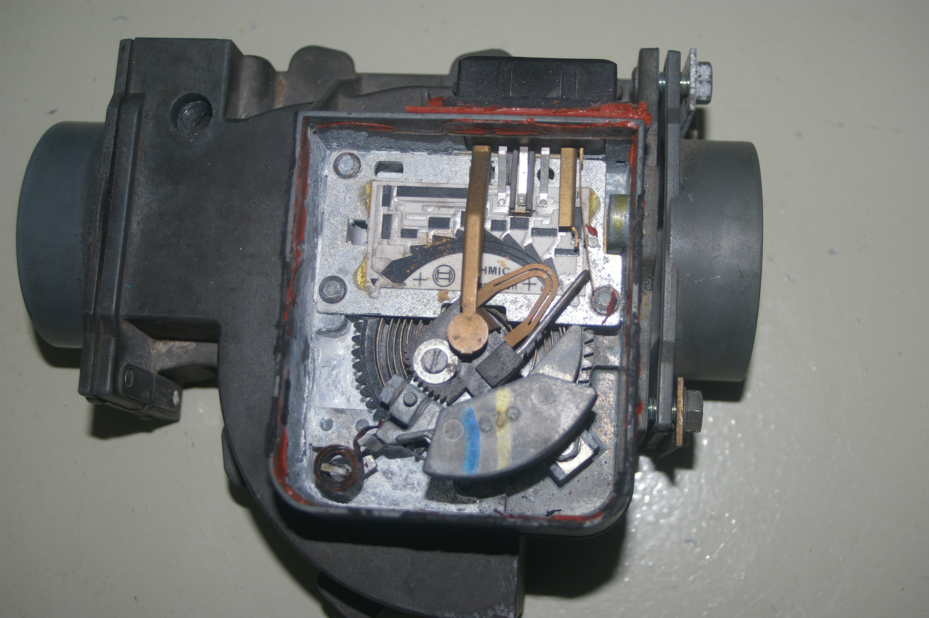

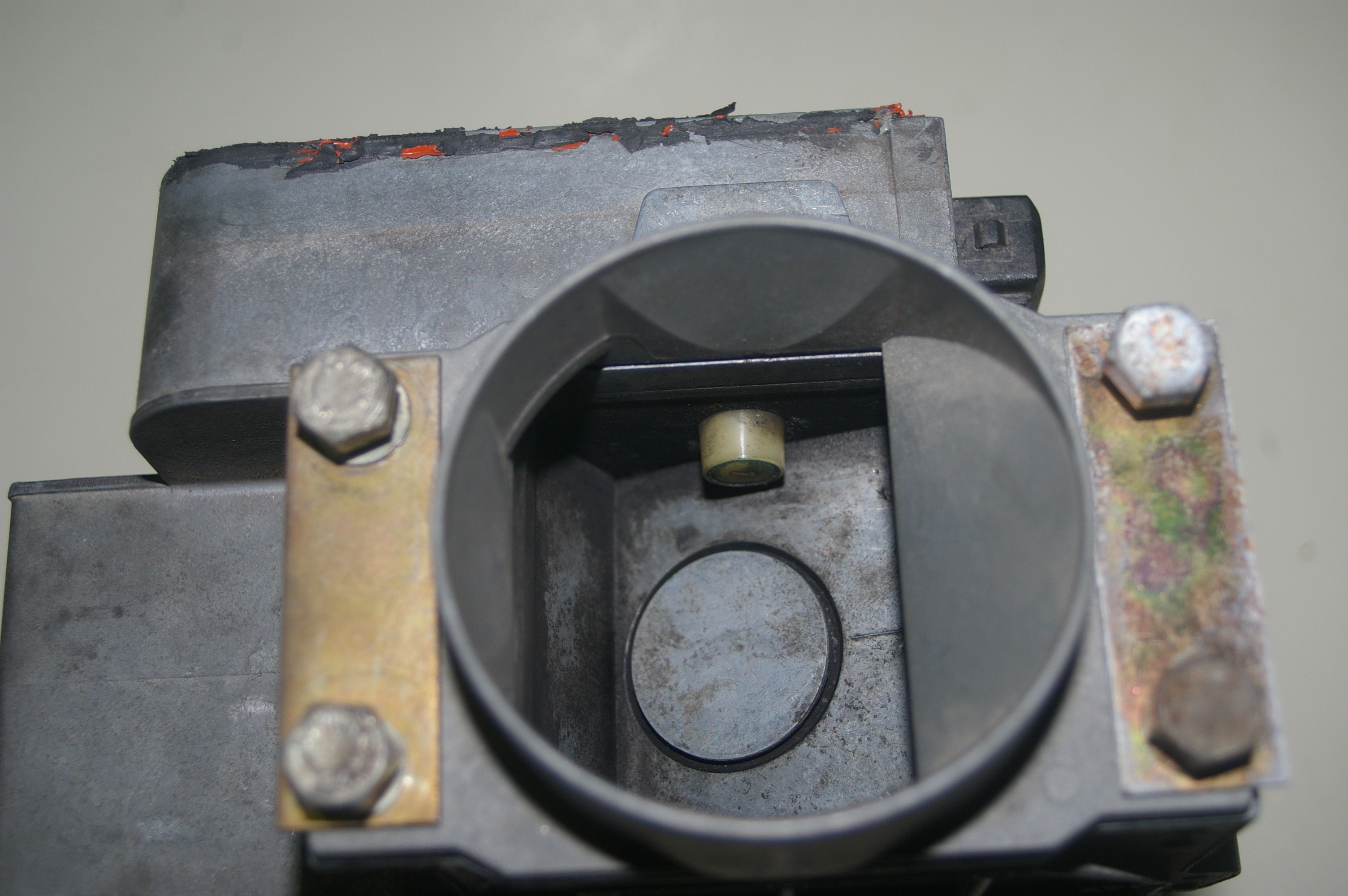

Got an old AFM and looked inside but couldn't find the cone shaped sensor.
Could you please help identify it.
Click to view attachmentClick to view attachment
nihil44
Temp GaugeClick to view attachment
djway
QUOTE(nihil44 @ Feb 15 2018, 04:33 PM) *
Look inside the air intake end of the assembly. Some I have seen are cone shape and others are cylinder shaped. They have all been an off white plastic

Got it.
Thanks
Will check on the car.
