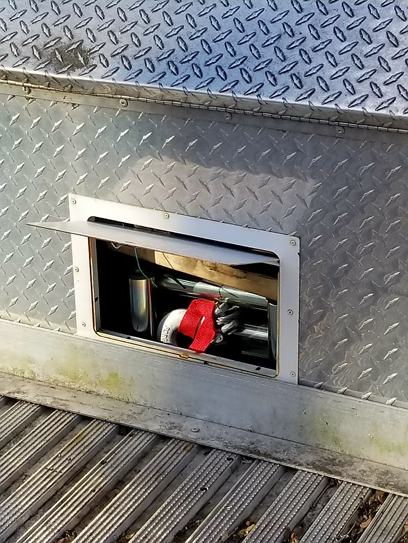

I have a featherlite dual axle. Great trailer, exceptionally well built.
I do remove fenders to get in / out of 914. Fast and easy, they are very light.
I also added a cargo box with winch mounted inside. Comes in handy if you need to trailer a dead car home.

Yes, HF. Badland 9000 I believe. It has effortlessly pulled up the 914, a minivan, a 68 Oldsmobile, an SUV, etc.
To get the height I mounted it on top of a steel I-beam.
