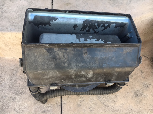

Here's a pic of the airbox after cleanup. This had paint all over it before.

even just sitting there on a rug, the air box taunts with its evil ways

Yeah, not looking forward to putting that back in the car.

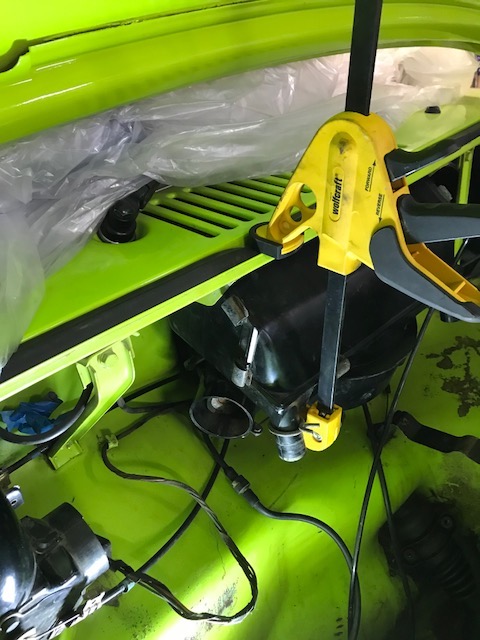

A clamp reduces f-bomb use by at least 50%. Also way easier with the tank out

Great advice on this thread that I obviously need unless I want to keep it two tone: Marathon Blue on Black Plastic.

Click to view attachmentI wasn't smart enough to take a before pic of mine, but it was even worse that that. Took about a week to get off with the brake fluid. A few times a day I would slobber it on with a cheap brush and then lay plastic wrap over it to keep it wet. Less fluid used that way.
Installing.... I'm afraid if I use Ian's suggestions to reduce the f-bombs, my wife will worry I had a stroke if she doesn't hear them.
