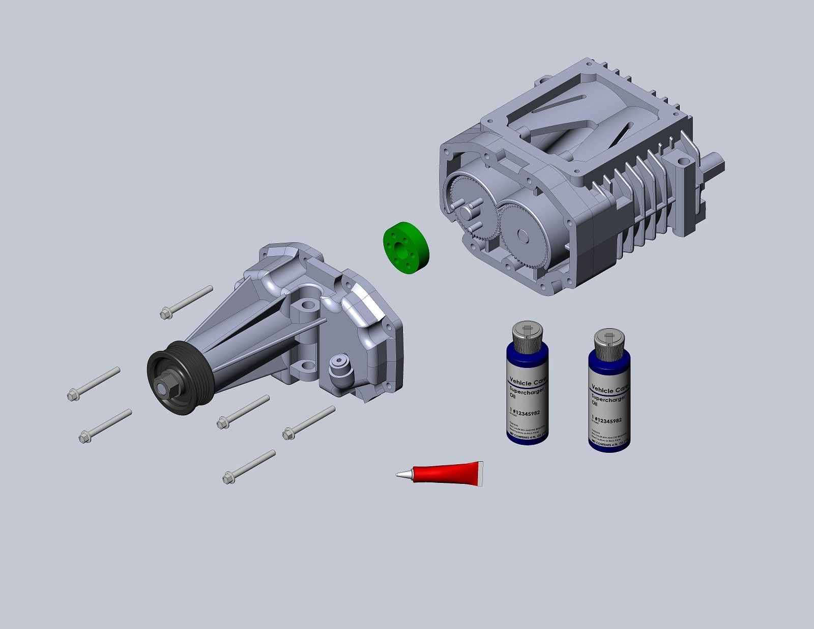

burton73
SC oil for TBird
Dr Evil
That green coupler piece was also included in my kit. The one possible plus of the mini SC is that the output is ducted to exit the rear rather than straight down. I am not sure, but it may turn the wrong way as I was considering this in the past. Or I might be thinking the MBZ one on their small Kompressor cars.
