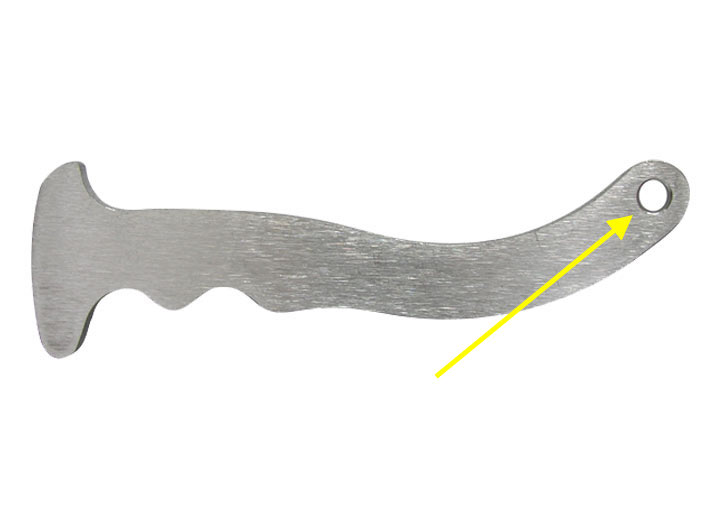

What I've found in my case is that the very loud popping is coming from the 914Rubber aluminum arm.
The holes that are drilled for the door pin are just too large.
You can see it easily as you open and close the door.
The aluminum arm is moving in and out quite a bit.
This was happening on both doors for me....both were popping loudly.
So unfortunately in my case the holes in the arm are the issue.
Like I said on my car the pin fits quite tightly into the bracket on the body so that's not the issue.
My fix (at least what I will attempt to do) is to install a very small bushing into the 914Rubber aluminum arm that will take all the slack out.
If I get this ironed out correctly, I'll post my procedure and results later this week.
I've had to order a 6mm drill bit to accomplish this.

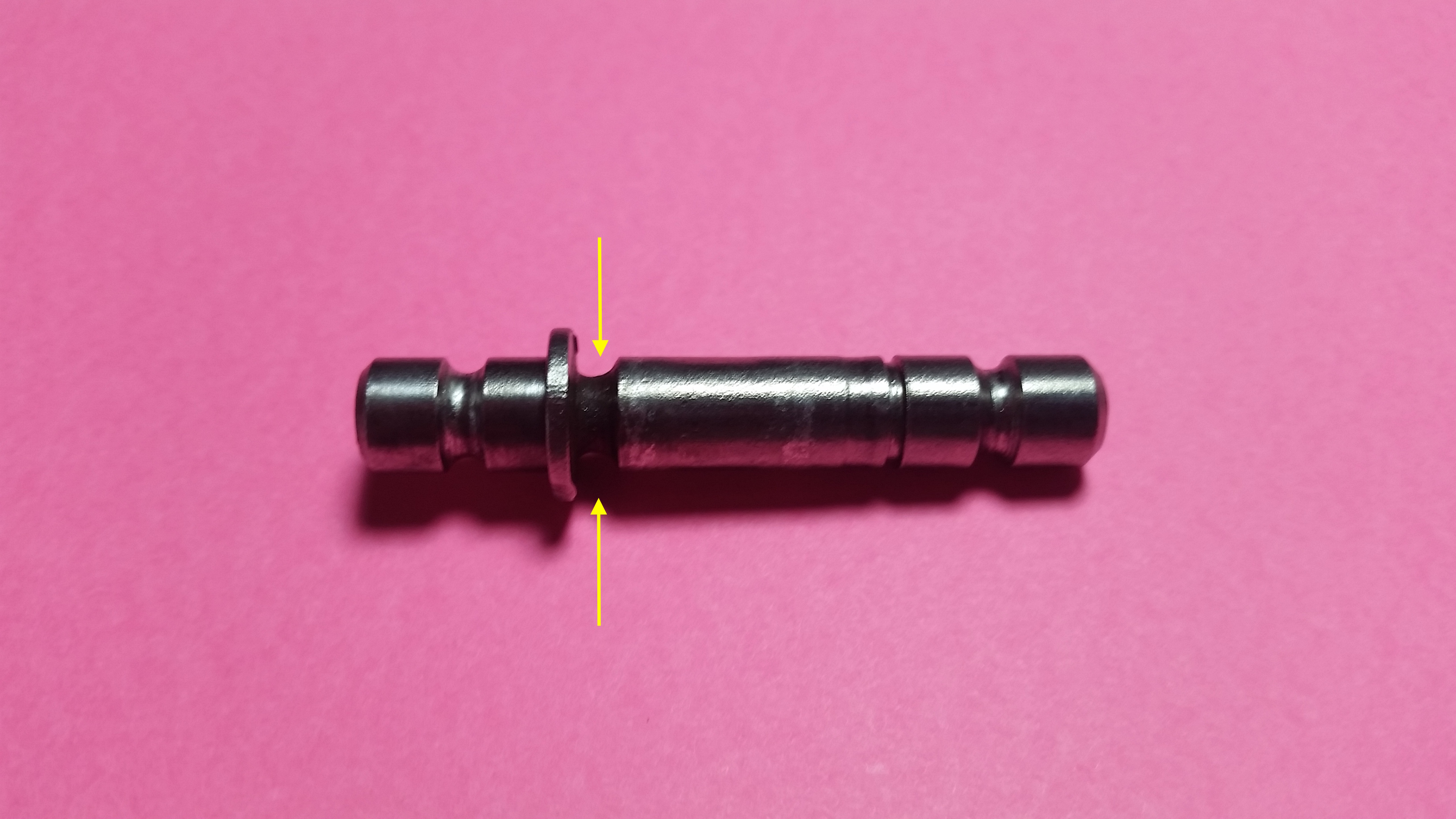

raynekat
If any of your pins in the door stop assembly look like this.....you'll never get rid of the popping.
Repeated opening and closing of the door over many years with likely zero lubrication has worn a big channel in one end of the pin.
Best to get a better set of 2nd hand assemblies if you can and rebuild those.
So a tip:
Best to lube these door stop assemblies every couple years at the very least if you want them to last.
Pull them completely out, clean them thoroughly, lube and reinstall.
This should get you many, many years of service from these much used assemblies.

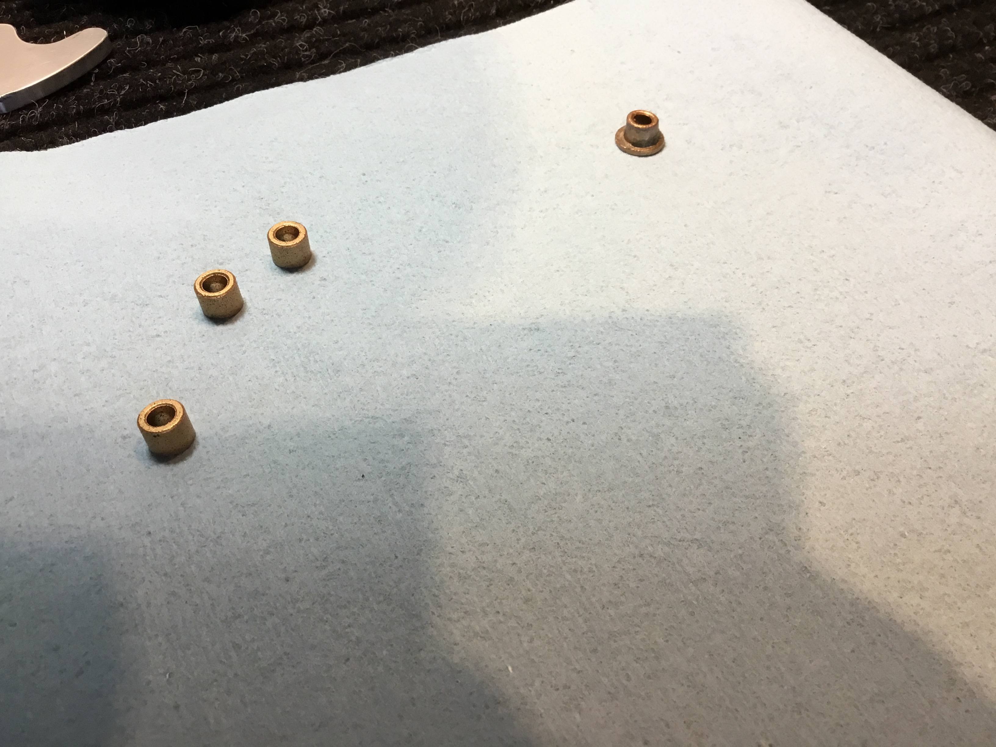

Attacked my door stops today to rid them of the loud snapping when they are opening or closed.
Again in my case, the door pin fits snuggly into pin receivers in the door jams on both sides.
My issue was that the hole in the end of the arm was too large.
See pic above.
Found some Oilite bronze bushings on-line that were 3/16" ID by 5/16" OD by 1/4" long.
Seemed like this was the size I needed to start with.
I found that the bushings w/o the collar worked better or easier.
First I enlarged the hole in the end of the arm with my 5/16" drill bit.
Then took the arm and bushing over to my vise and beat the bushing into the hole, and continued to beat on it with the hammer to try and flatten out the bushing a bit to really snug it up into that hole that was enlarged.
Seemed to be in there very tightly.
The pin's OD is right at 6mm.
A 15/64" drill bit is right at 5.95mm, a hair smaller than the pin, so perfect.
I used progressively larger drill bits starting just small enough to go into the ID of the bushing.
Slow and patient here as you don't want to dislodge the bushing from the end of the arm.
After working my way up to the 15/64" drill bit, I used that to barely open up the hole enough for the pin to snuggly fit inside.
After this I dressed up both sides of the bushing so that it was flush with the arm.
You don't want any of the bushing sticking out on either side of the arm or it won't fit into the receiver in the door jam.
I used my dremel with a sanding drum to take care of this and followed it up with some very fine sandpaper.
The bushing still looked quite seated in the arm.
The bronze bushing was quite tough to drill, so I think it will be very durable and last many more miles.
The end result is no more snapping noise when opening and closing the door.
Job done!
I dressed up the end of the arm to look much better than what you see in the pic.

We actually machine these parts. The tolerances are within a few thousands. I'll double check to make sure we don't have anything messed up on our side.
Mark
Mikey914
Guys I've checked the tolerance on the parts our holes are .01mm oversize but well within tolerance.
The problem I believe is the pin It's a 6mm pin. It appears to have worn down from its 6mm shaft size to 5.75 on my car, and it wasn't popping.
As you can see the nominal is 5.95 for the shaft, however the area that interacts with the pin is 5.75.
We did make our stays for the pins when new, so I think this may be where the popping is coming from.
