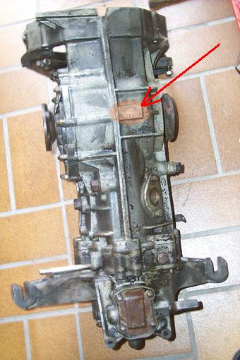

serial number and linkage in the end cap.
Serial # is a 75xyyyy where x is the year digit 0, 1, 2 and type # is 914/01 applies to five speed as opposed to the very rare Sportomatic
bottom; notice no long cast extension for gearshift connection
side; notice pivot on intermediate plate for throttle
Dr Evil
The numbers are located here rather than on the spine.

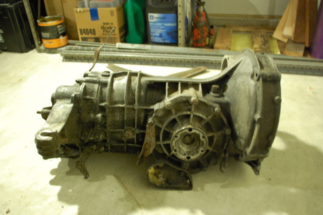

Will look for the numbers thanks for your help, regarding the gearbox are they any different or just the same gearbox with different numbers??

The parts are a bit different. The main casting may be the same as 911 transmission from the same year, but different from the 914/4. You can see a protrusion on right side of case at the bottom of the bell housing that is not present on the 914/4. The intermediate plate is drilled for a pin acting as a shaft for throttle pivot. The rear casting is unique to 914/6

The boss in the intermediate plate for the throttle bell crank is present on many tail shifters, just not drilled. The tail cone is unique and not the same as a tail shift 914/4. The gears will be different from a 914/4 as well.
Stock 914/4 is A, F, N, V, ZD
Stock 914/6 is A, GA, O, V, ZA
Sometimes, the holes in the top of the bell housing are round (early model 911, 914/6, some earlier 914/4) instead of square (later models).

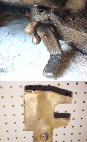

shift linkage on the end of transmission looks like the top picture
and the end of the shift rod looks like the bottom picture.
Minus dirt and grease of course.
QUOTE(gandalf_025 @ May 14 2018, 03:03 PM) *
the shift rod under the car is different as well.

QUOTE(Dr Evil @ May 14 2018, 11:36 AM) *
The serial number is on the spine of the early 1970 914/6 transmissions, the change occurred somewhere between car 300 and 400
