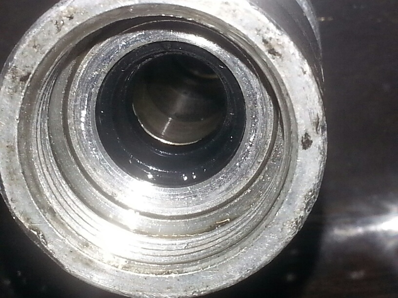

So before I try and damage something, what's the best way to extract this seal?
Also I assume that's a sealing washer on top and cannot be reused?
Mikey914
A pick will do it.
I have the seals if you need them. The seal yes replace. The aluminum washer you can reuse if it's not damaged.
The "new" part with all the seals is $65 if you want one. It has an extra seal so it will not leak.
https://shop.914rubber.com/searchquick-subm...keywords=speedo
UROpartsman
It might be too big or overkill for removing this particular seal, but a puller like this Old Forge 7019 (available on Amazon) is a handy tool for getting seals out of smaller bores.
Dr Evil
I use a cheap set of dental picks, $0.99-2 at harbor freight. Easy and cheap to replace. Oddly enough, the 914 transmission seal kits do not come with this seal, but do come with the O ring. The 911/912 kits come with both o ring and seal.
