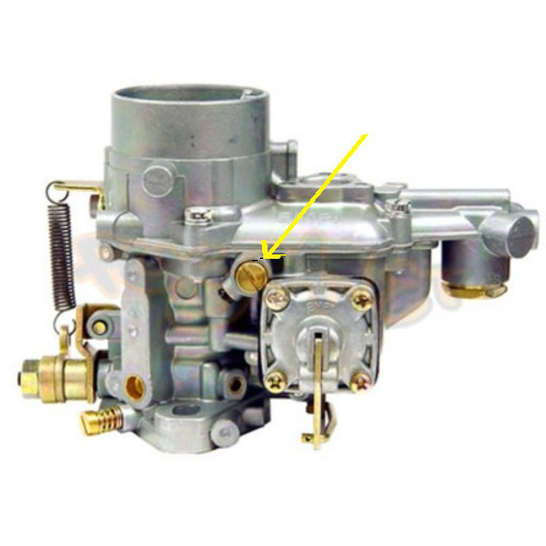

So I pulled the carb and gave it a good cleaning again. No change... Pulled is again and inspected the screw below which is actually the idle jet. Cleaned it up and ran a pin through the holes. No change, but I did notice that the holes could be lined up with the circuit. Turned it out a bit and the idle circuit started to work again.
Thanks for all your help. I'm glad this was an easy fix.
