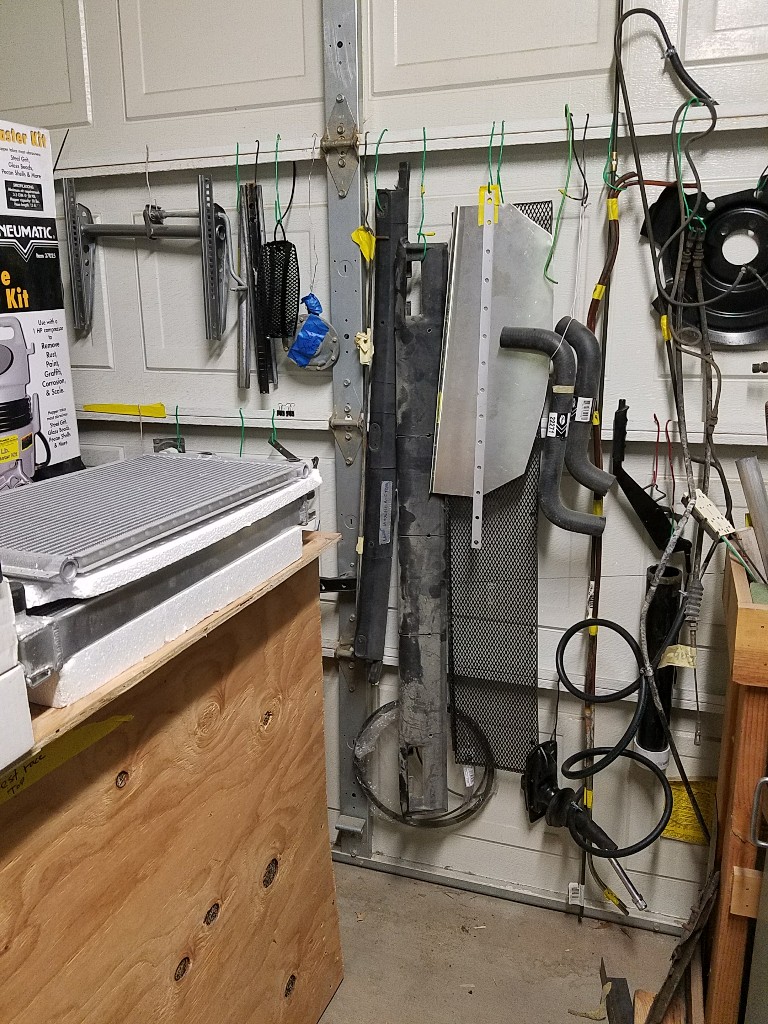

Costa05
I completely understand the space issue you mention. I do have a third car garage door that i resorted to hanging parts from with wire hangers which works well. Wide shallow boxes the same size stack boxed parts well.

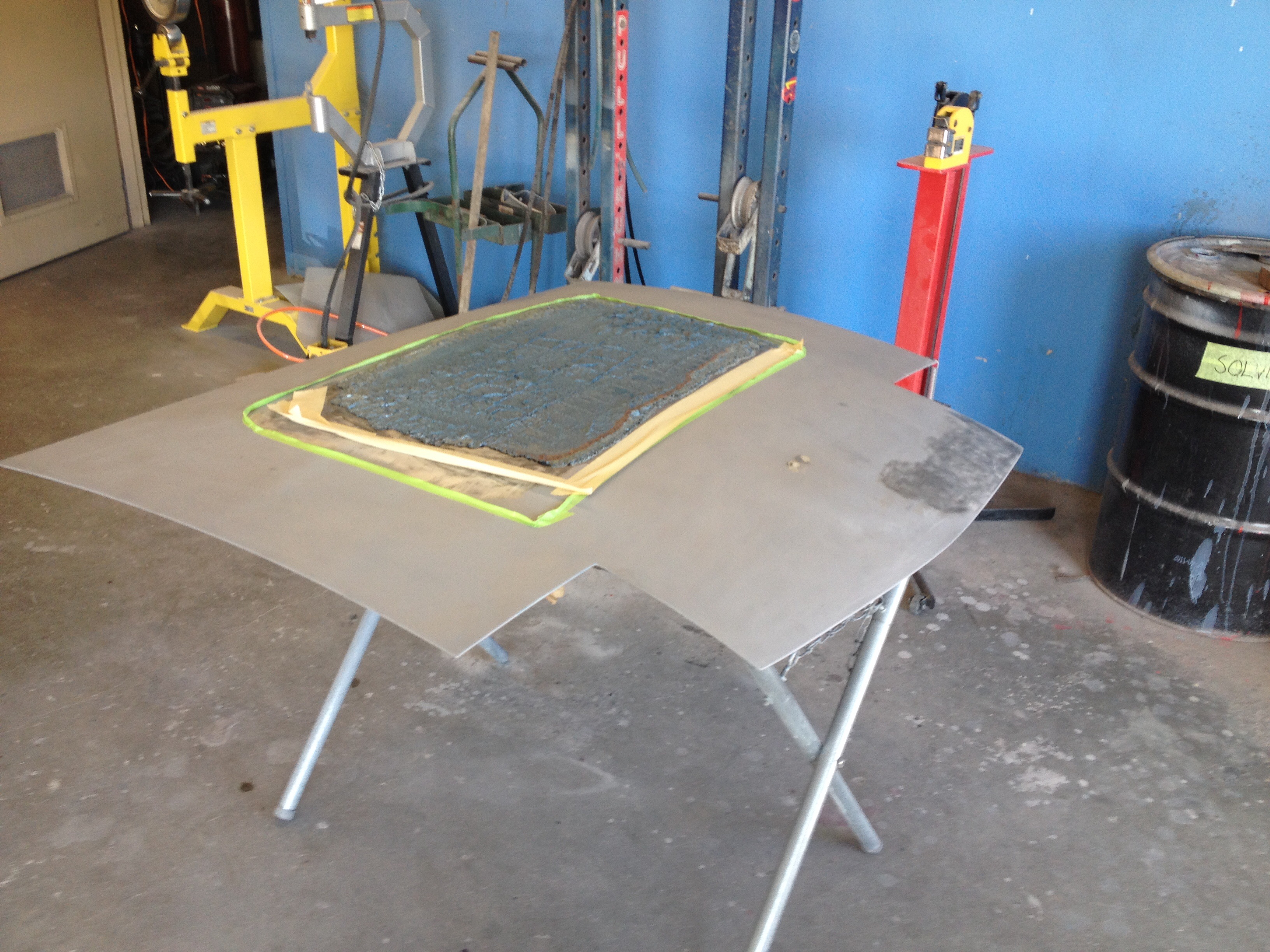

mgphoto
I wouldn't sand blast the entire door, metal will overheat and warp, sand blast the edges where the strength is, than chemical removal with aircraft stripper, the center sections.
Did this to my front lid worked out great.
Actually garnet blasted.
