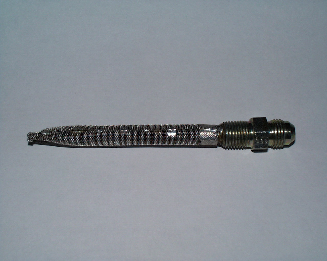

I tapped my tank for a 1/4npt pipe tread / -AN6 fitting and then fabricated a metal mesh sock to it
