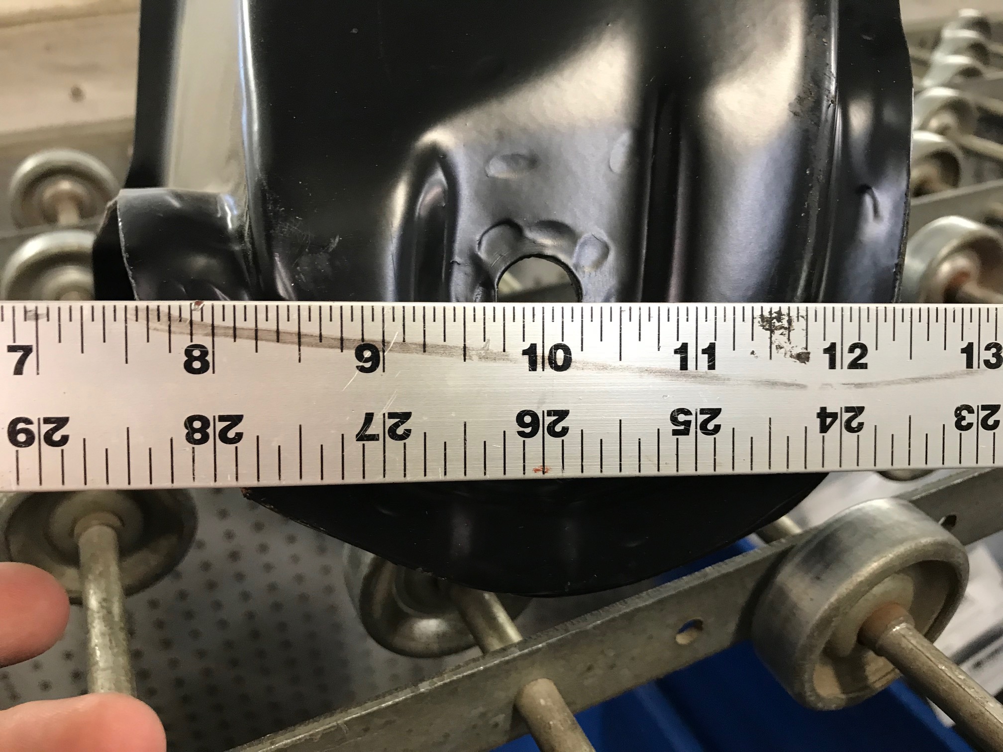

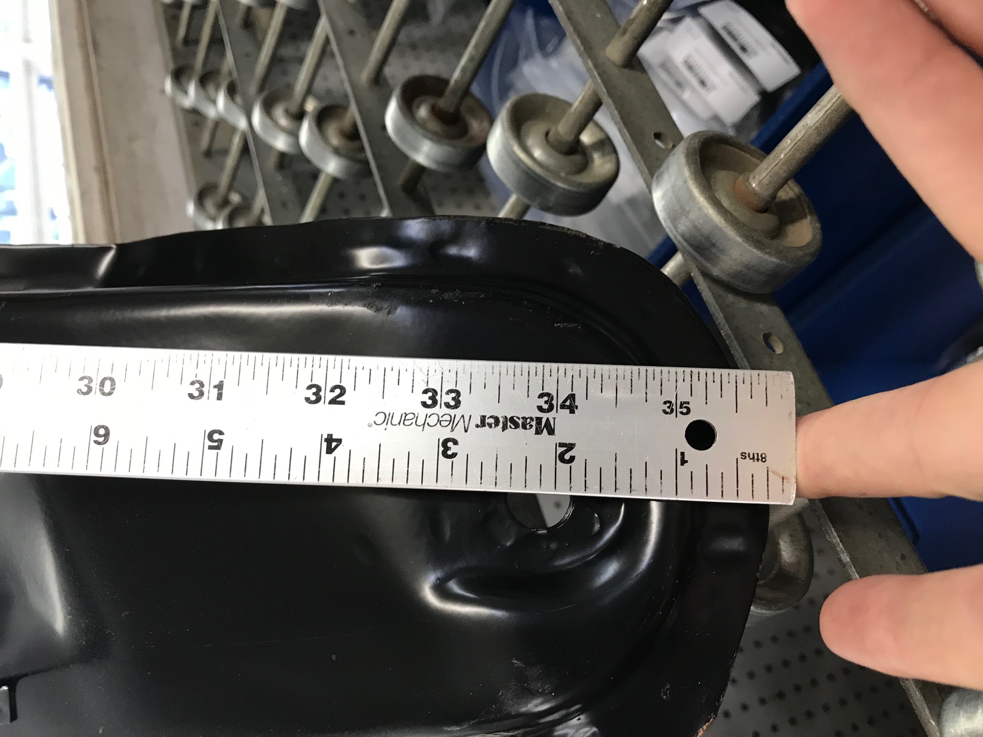

Does anyone have a measurement for the distance between the two rear suspension console ears/pickup points?
Im looking for the spot where the trailing arms attach to the chassis, the distance between.
Should be easy enough but I cant seem to locate it here.
Thanks
Andrew
dr914@autoatlanta.com
Click to view attachment Click to view attachment
BPic
Inside to inside I have 33 1/4"

Alapone
Thanks guys I appreciate it. I will take a measurement tonight.
