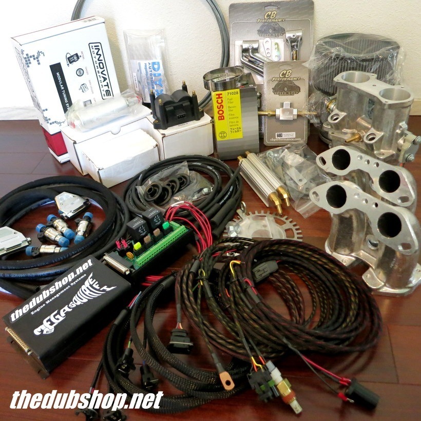

Anyone using this Magasquirt package from the Dub Shop? http://thedubshop.com/dual-throttle-body-f...gnition-type-4/
Looks like a nice complete package but seems a bit pricey.
Kelvin

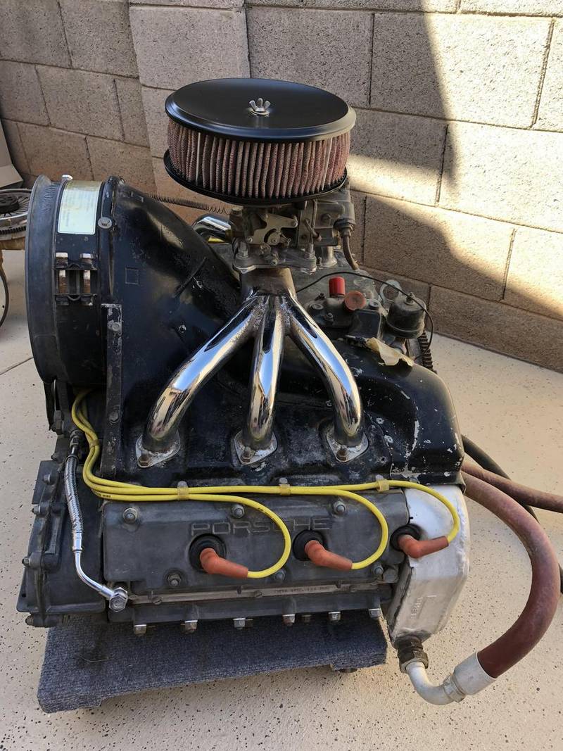

I saw this motor on Hemmings today, I bet one could adapt the Holley EFI to this:
73-914
bet it doesn't run to well
mb911
QUOTE(Mueller @ Aug 10 2018, 01:15 PM) *
Yes and I agree I bet it runs reasonably well though probably not got for Hi performance apps..
I considered that as a option using FI tech injection..
horizontally-opposed
QUOTE(Mueller @ Aug 10 2018, 02:15 PM) *
Mark Henry
