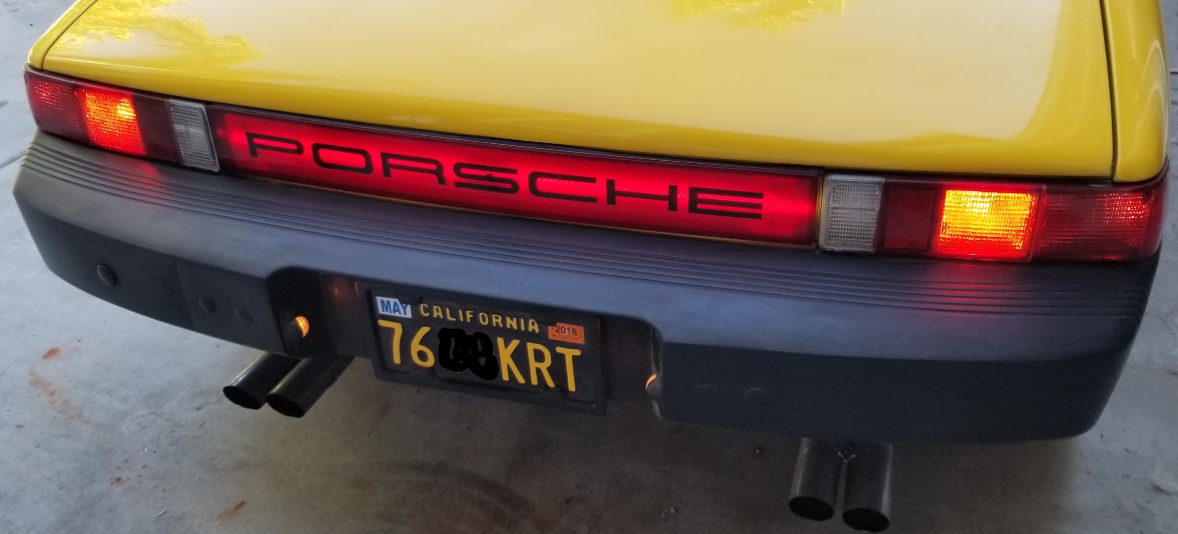

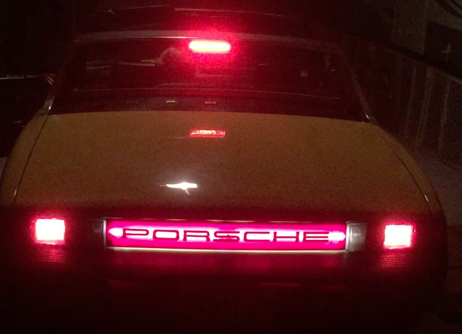

oakdalecurtis
Aug 15 2018, 01:16 PM
Here's what LED strip behind reflector plus third light looks like lit up....
ValcoOscar
Aug 15 2018, 01:40 PM
QUOTE(oakdalecurtis @ Aug 15 2018, 12:16 PM)
NICE!!!
Photo I took a few weeks ago.

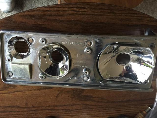

If you decide to use bulbs or LEDs that use the reflector, try reflective tape like this stuff from 3m. Here's what one guy did to improve the reflective property of his dull TR6 reflectors.
3M Scotchlite Reflective Tape, Silver, 2-Inch by 36-InchClick to view attachment

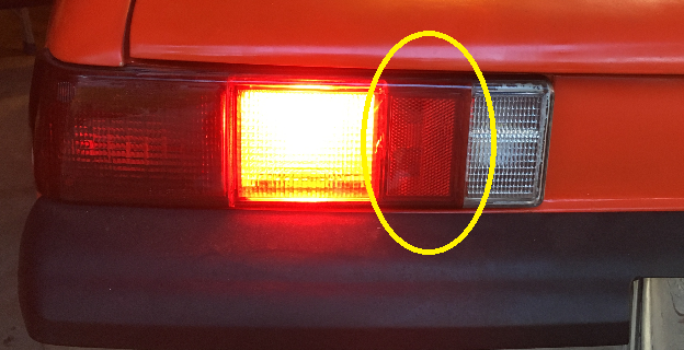

7TPorsh
Aug 18 2018, 05:24 PM
Actually referring to this reflector. LED behind here double the light in your line of site.
bandjoey
Aug 18 2018, 06:13 PM
QUOTE(7TPorsh @ Aug 18 2018, 06:24 PM)
Click to view attachmentHow little things get overlooked. LEDs on tail and stop. Adding one in the reflector box does give more visibility. I think the 3rd light up high is the best thing you can do.
ClayPerrine
Aug 19 2018, 07:41 AM
QUOTE(bandjoey @ Aug 18 2018, 07:13 PM)
It is also illegal. US DOT requirements mandate a rear reflector on all cars. If you convert that to a tail light, it will no longer be a reflector. Now if you have the big Porsche reflector between the lights, then you would be legal.
Don't give a cop a reason to pull you over just because you look like you were going to speed.
7TPorsh
Aug 19 2018, 10:18 PM
QUOTE(ClayPerrine @ Aug 19 2018, 06:41 AM)
J didn't remove the reflector. It's translucent thin plastic and the light shines through at night. Lights up and reflects.
