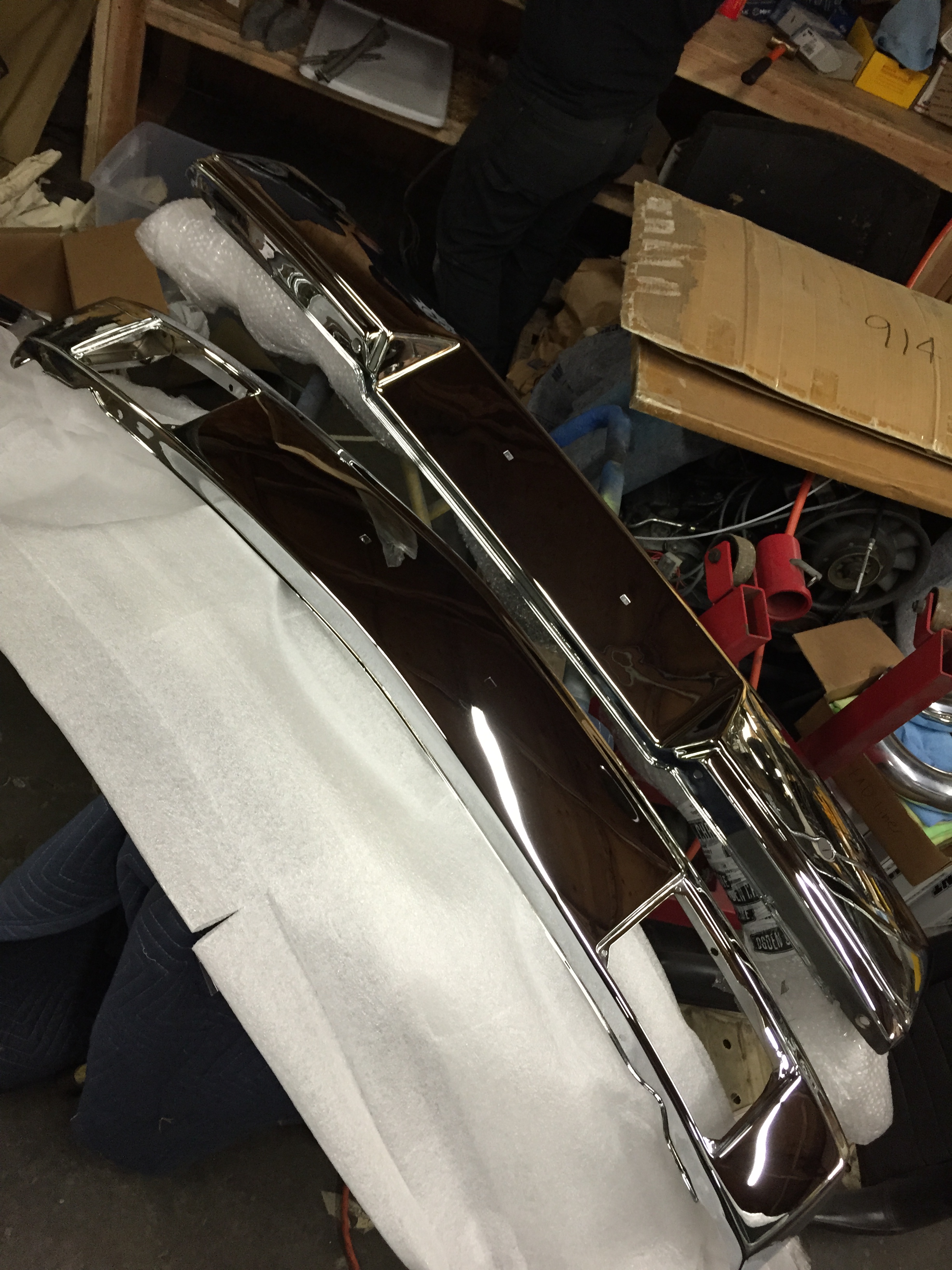

Back in 2014 I bought a set of early painted bumpers here in the classifieds. I took them to Mark/Tim at Original Customs and they filled holes and straightened them AMAP. They then sent them to Ogden Chrome. $700 each for the chrome job. No problems with fit. Note the rear bumper is from 70-72.
Thanks, Steve!
