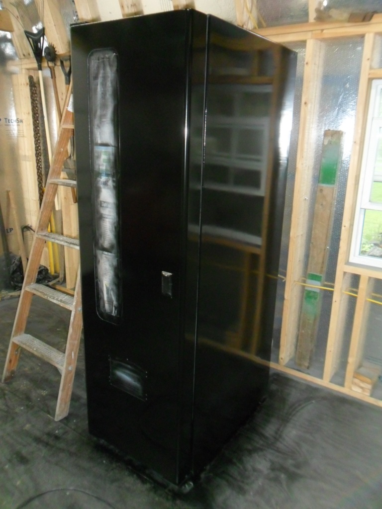

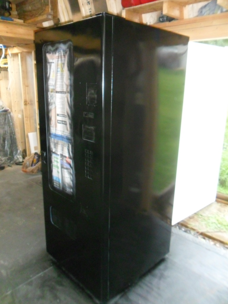

I went down to 220 grit on the bare metal with the DA sander and blew them off with compressed air. Next was two wipe downs with denatured alcohol, using a fresh microfiber cloth each time.
I applied two coats of primer and HAND SANDED with 220 grit. I hand sanded because my air compressor tends to "spit" when operating in humid weather. I may invest in a good air drying system. I believe this is what has contaminated more than one paint job for me.
After two wipe downs with a damp microfiber cloth I shot two coats of gloss black. The first coat was very light. The second was a full coat. I kept the light on it during the 2nd coat so I could move as soon as it flashed.
Overall, they turned out well. There is one small spot on one side where the paint is rough - but I can hide that. I suspect I didn't shake the can long enough. headbang.gif

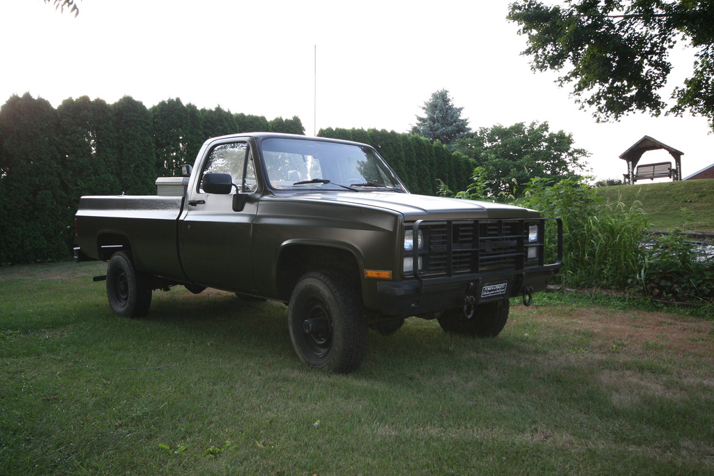

If you do a lot of painting, the HF HVLP guns aren't horrible, and you can get rustoleum in gallon buckets and mix it with xylene (IIRC). Probably cheaper in the long run the rattle cans, and you can get a better coat of paint that way too.
I painted a friends farm truck this way (about 8 coats of paint) and it worked well.
