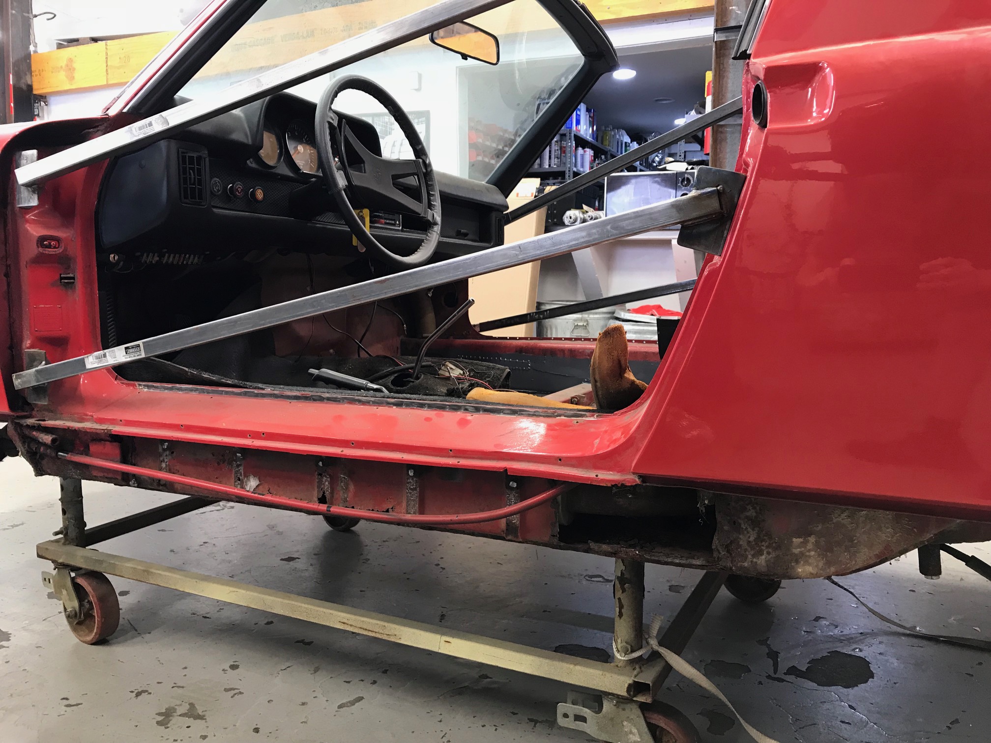

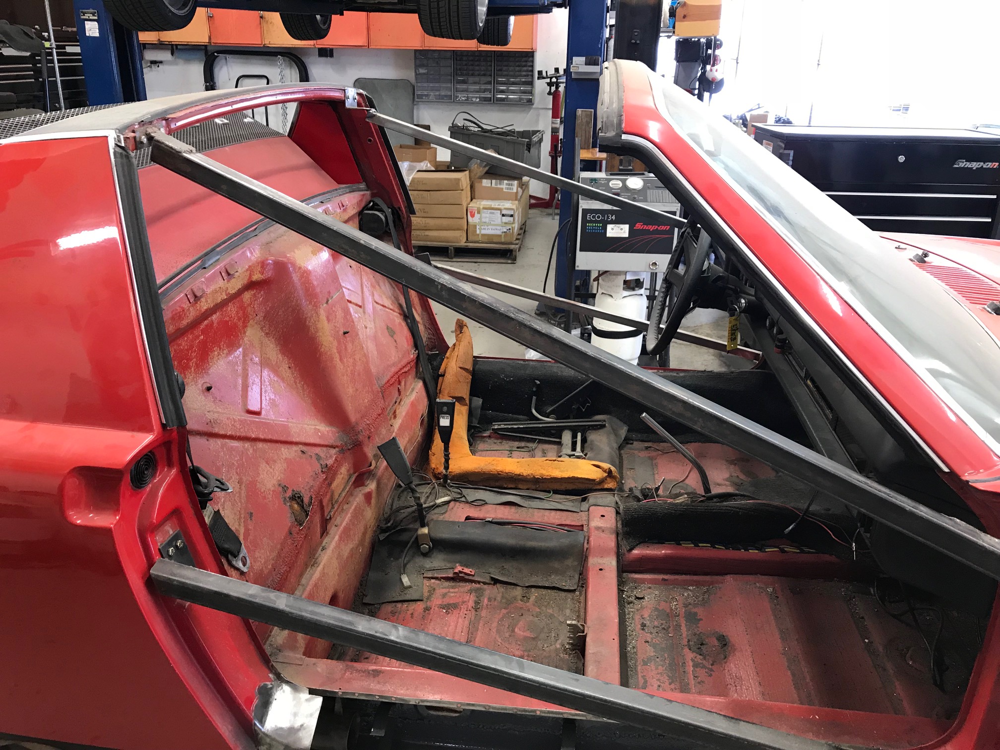

IronHillRestorations
Yes.
More than likely you'll find more corrosion once you dig in, it's rare to find less. That said if you have to repair a section of the longitudinal, you'll need the reinforcement to keep it from moving
dr914@autoatlanta.com
Click to view attachment Click to view attachment
