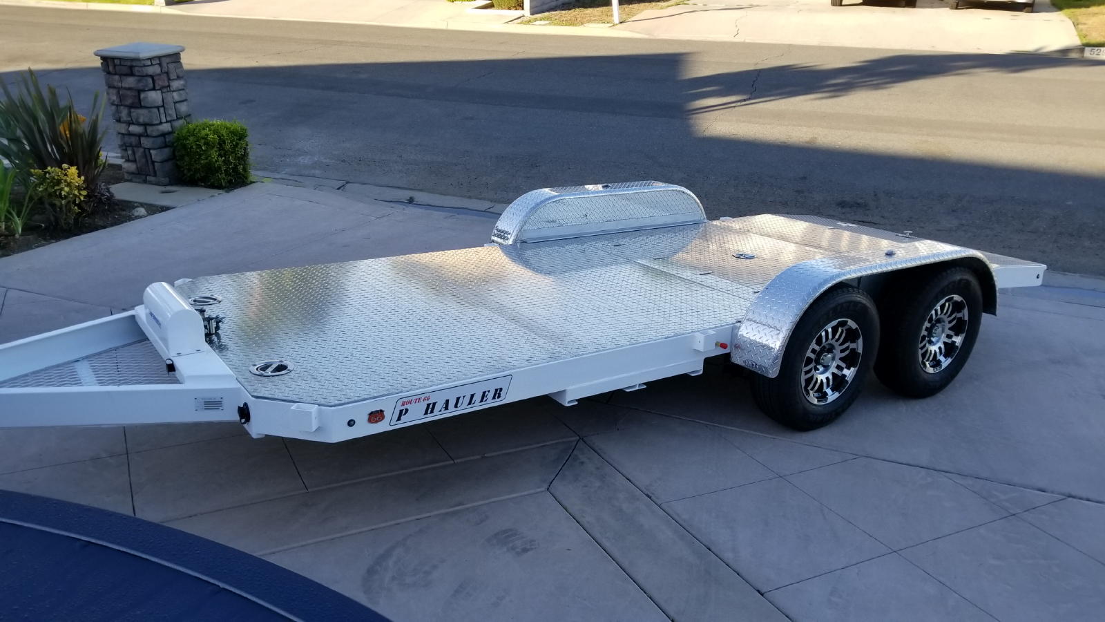

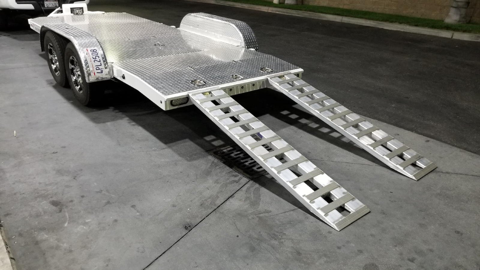

I wish you were closer. I'd lend you my
P HaulerPerfect match
It's available to local members here in SoCal.
Oscar
Click to view attachment Click to view attachment
