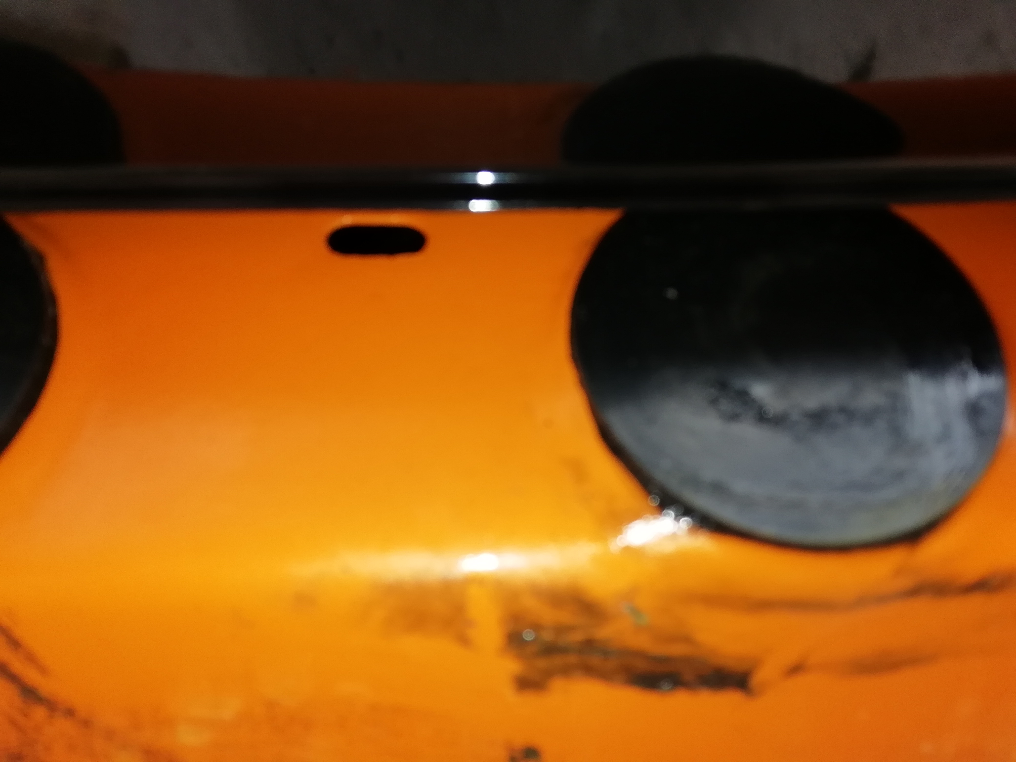

in the front valance there is an elongated hole or 2, what fixes here?
ClayPerrine
QUOTE(JFG @ Sep 21 2018, 10:17 AM) *
The screws to attach the valence to the front of the car.
JFG
i have a le air dam copy from 914 rubber. does it attach to these same holes?
ClayPerrine
QUOTE(JFG @ Sep 21 2018, 02:34 PM) *
Yes.
I just took a fiberglass LE air dam copy off my six and replaced it with a stock valence. They attach the same. And the screws come from inside the trunk.
JFG
is there anything used between the mating faces, like a rubber washer?
ClayPerrine
QUOTE(JFG @ Sep 22 2018, 02:54 AM) *
Nope. But there are clip nuts on each of the valance holes.
