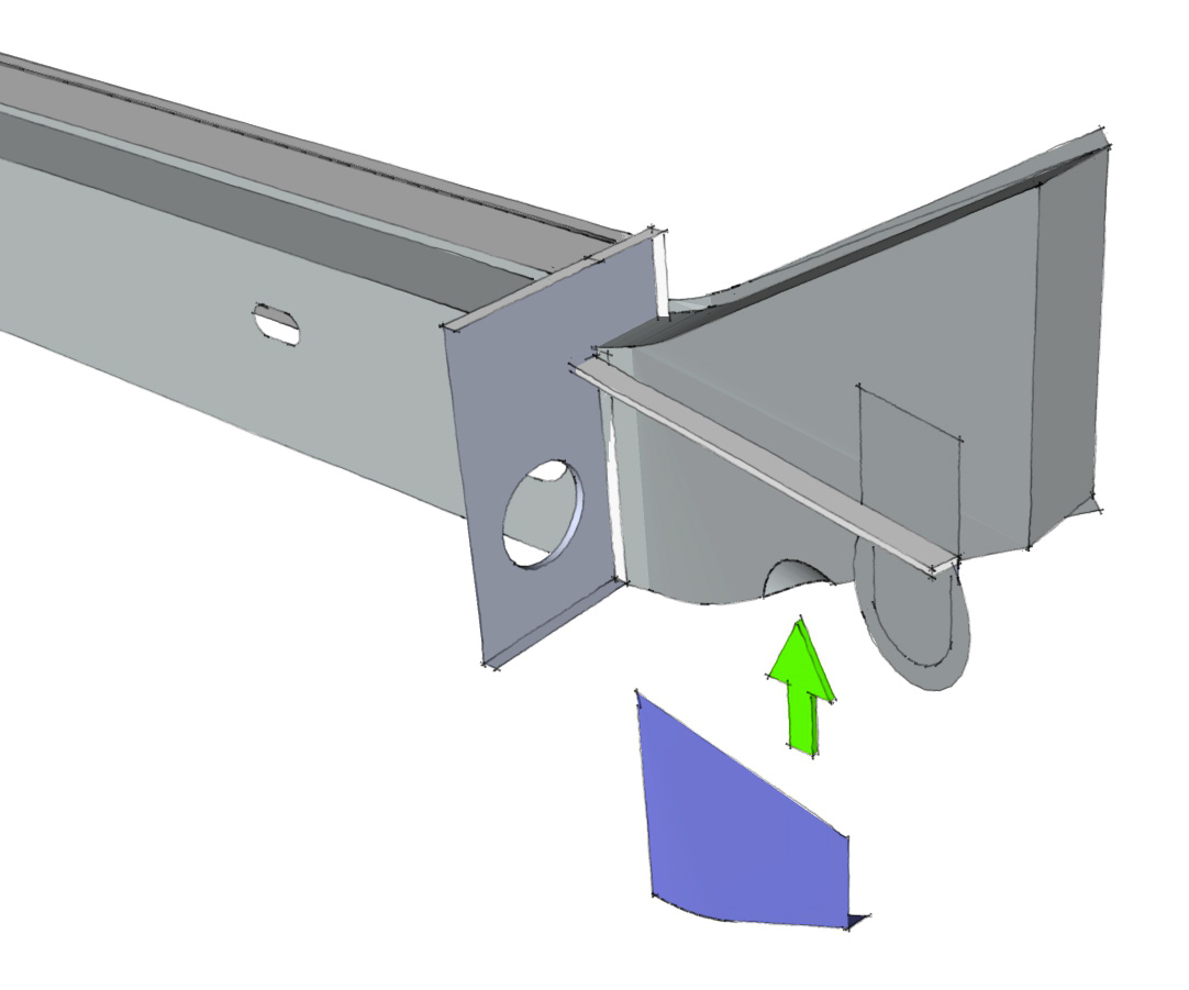

The dimples to which I was referring are not the ones in the firewall. I mean the ones on the edge of the long. See the rough picture I drew of it below. I was thinking of putting a reinforcement piece (shown in blue) which would cover the dimple.
I think the dimple is for the four engine mount, is there any reason to have it on a six?

I don't know off hand what the dimple is for.

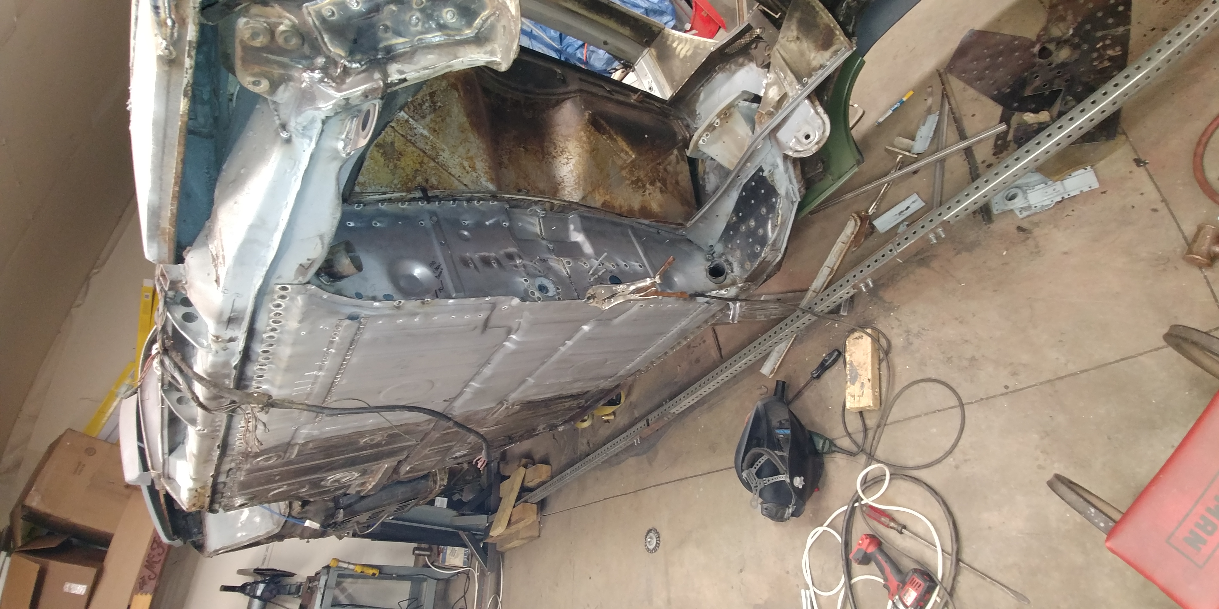

This is how I reinforced this area.

Click to view attachmentThanks Ben, that is basically what I was going to do—although I can't see from the photo if you moulded it to the dimple.
I have a piece of Maddog inner long reinforcement laying around that was gonna cut up and use there because it has the right radius bend and the holes already drilled. It will wrap around to the bottom of the long a little. I think I can stretch it to make the bend.
My only concern was eliminating the dimple, I know the dimple is needed of the four mounts, but is there any other use for it on a six, like to help route oil lines on the drivers side or anything?

I left the /4 engine mounts intact, I think that they strengthen, reinforce, and square up the chassis there. I ran my oil lines through the driver's side opening on it so it acts as a hanger too.

I actually used 14 ga and molded it to the dimple.. It just looks more factory that way.
