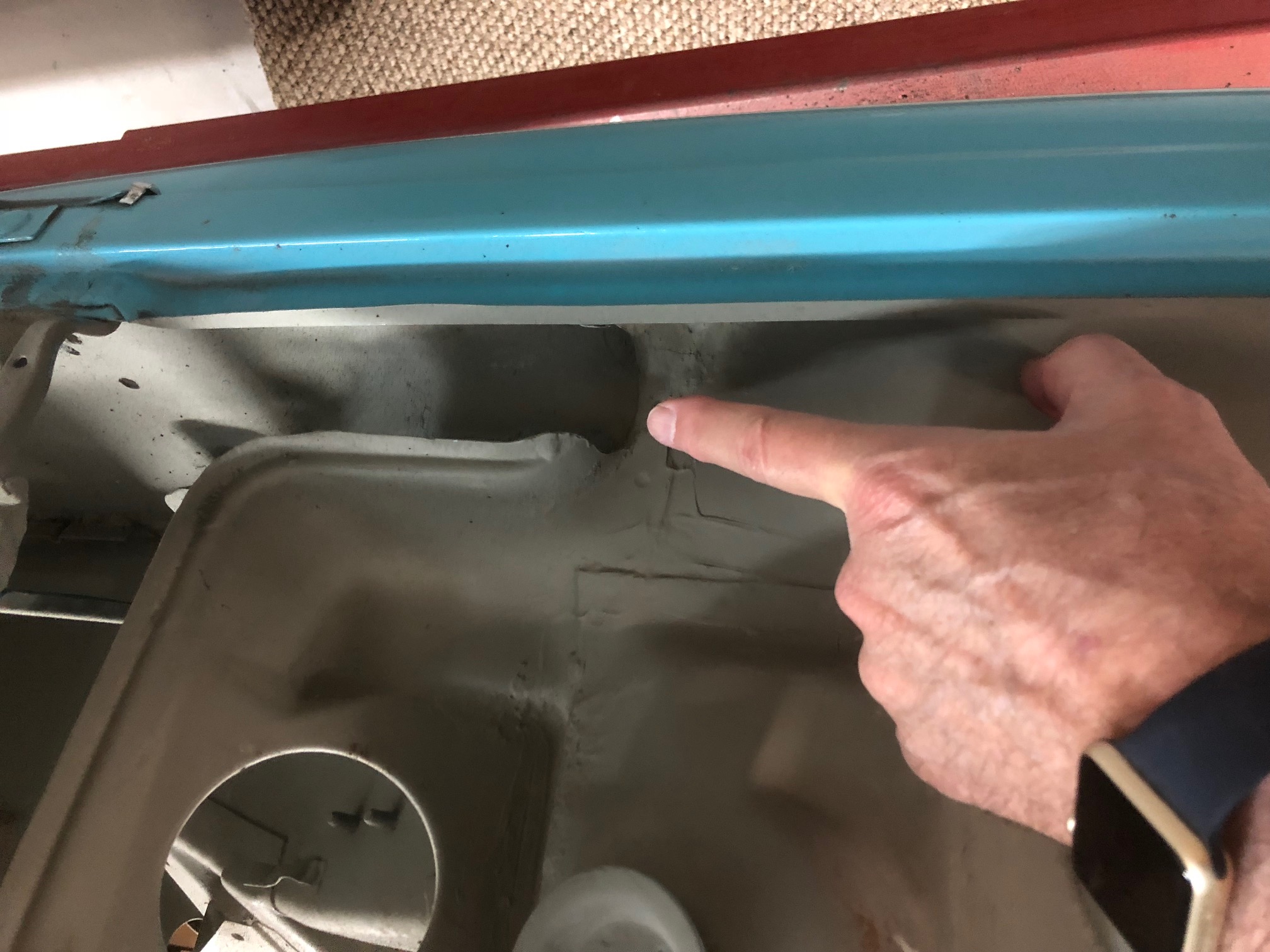

burton73
I just happened to have one close by to take a picture of. When I bought my roller for my V8 from duc and Craig at Camp 914. my car had them in.
