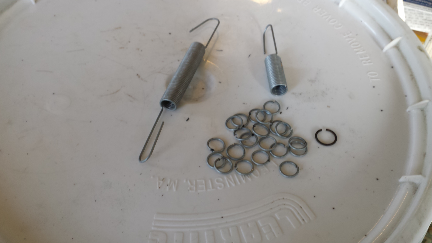

Hadn't given up on these clips. Easy to find in wholesale quantities but couldn't find anything within reason for small quantities. Then I had a flash of genius. Ever wonder what happens when you cut a coil spring lengthwise? I grabbed the closest match I could find in my parts bin and gave it a go. Wire diameter matches but spring diameter is a bit small (the rusty dark one is an original), but hell yeah it works! aktion035.gif shades.gif
Took about 30 seconds to make all these clips. Correct dimensions are 0.49" spring OD and 0.049" wire diameter. McMaster-Carr has a very close match that should work https://www.mcmaster.com/9654k398 Just need to source, cut, and send off for plating. piratenanner.gif
Wonder if you could find a plated spring.

Brilliant!!!! I was just going to twist some wire around the ones that were missing. But now I’m getting a spring and doing it right Thanks.

Brent the Mad Scientist....nicely done.
cary
Well done Brent.
I'll hit up ACE for a couple springs this week. Cut them up and drop them in the plating bucket.
