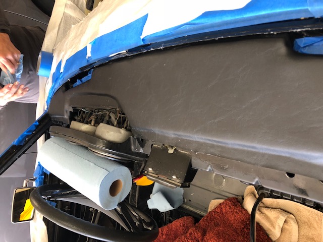

I recently did this and I used a kit. The foam was ruff cut, but needed trimming on the the curved section and around the vents. Getting the foam cut exactly I thought was maybe the hardest part. My wife did most of this and we tried to get the foam to fit the top of the radius exactly where the metal bends down. When we glued the vinyl we only did half at a time and started from passenger side. If I was doing it again I would stop at middle of vent openings. This would be only a third at a time, but it is easy when only one edge is glued to get a good start again. We trimed and did the vent openings a week later. The glue used was HH-66.
When you are at Walmart go to the craft section and pick up a bag of different size brushes for 5 bucks.
