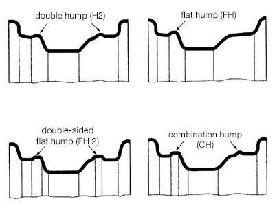

johnhora
Early 911 wheels like the deep 6" Fuchs didn't have the tubeless "hump" formed on the inside of the rim. Supposedly this keeps the tire bead from slipping to the inside of the rim and sudden loss of pressure. This could happen with low pressures and severe cornering. So they used tubes like most early cars.
go hear for all you want on the patent
https://patents.google.com/patent/US4606390A/en
Mark Henry
QUOTE(johnhora @ Nov 30 2018, 09:31 AM) *
All rims without an inner bead should have tubes. Yes you can get away without tubes but you're definitely taking a gamble.
