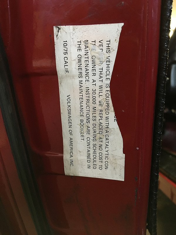

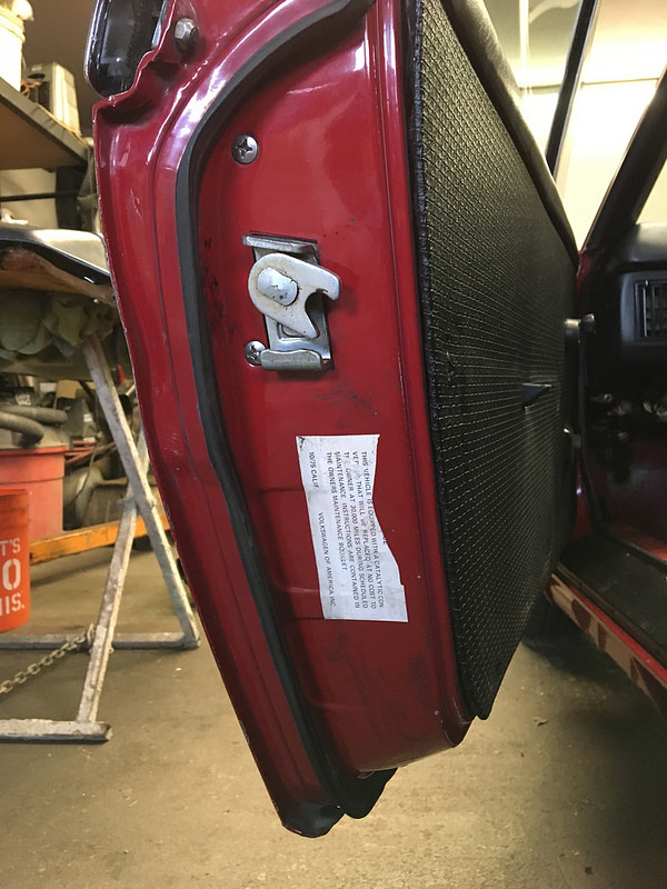

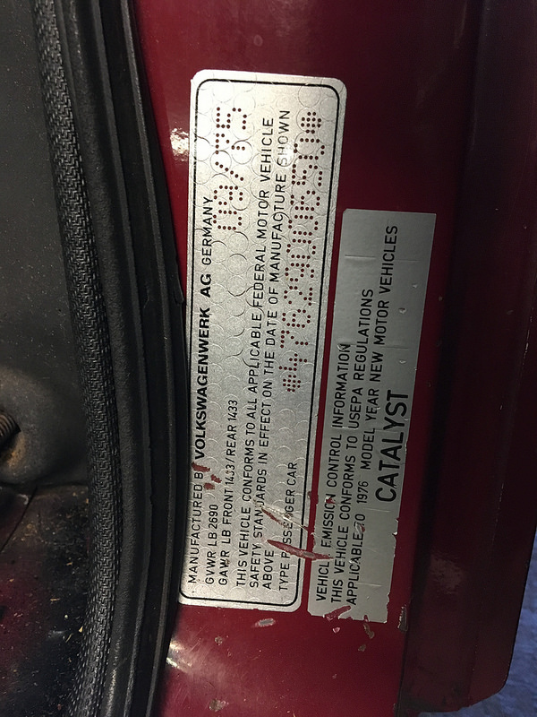

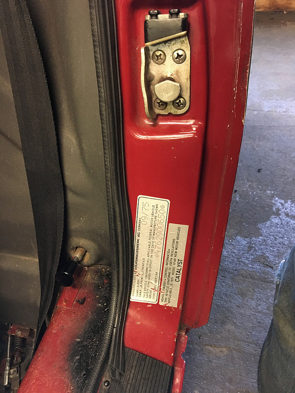

DickSteinkamp
I have these emissions stickers on my 1976 MY (at least it is registered as a 76), September 1975 production California delivered 914. Original paint.
IPB Image
IPB Image
IPB Image
IPB Image

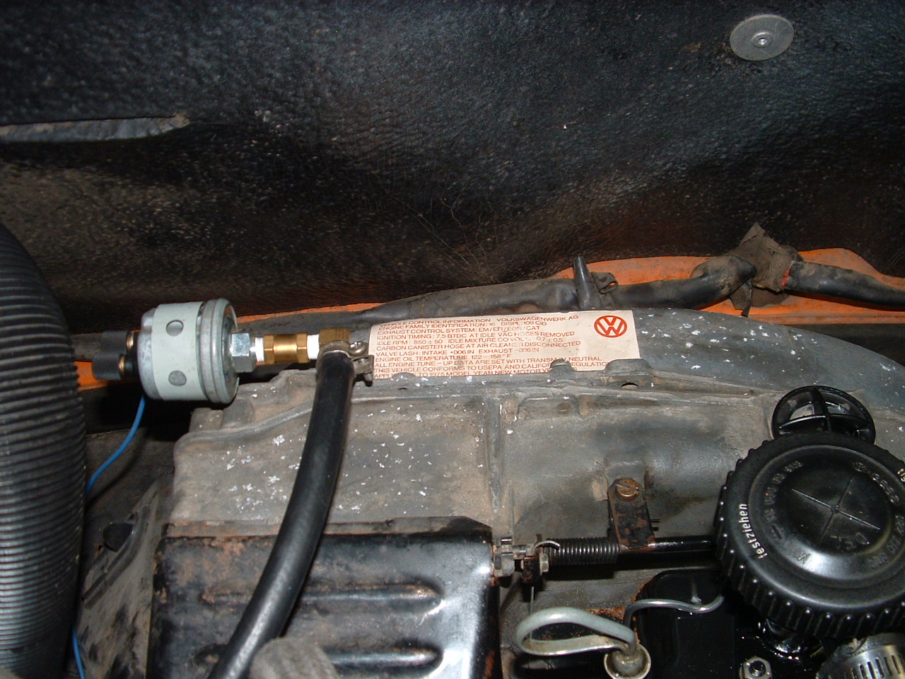

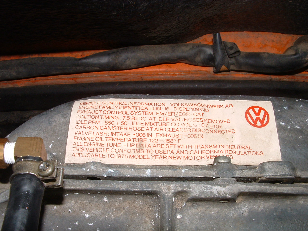

bretth
The repo decal linked to that AA is selling is the same as my 75 1.8 has but mine is located on top of the cooling fan shroud near the alternator.

QUOTE(bretth @ Dec 1 2018, 01:57 PM) *
Yes, my '75 1.8L has the decal on the cooling fan as well.
