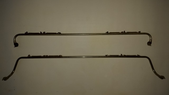

Dear 914world members,
I'm new to this community and looking for help regarding KARO ski rack, which was (according to bowlsby.net) original factory accessory.

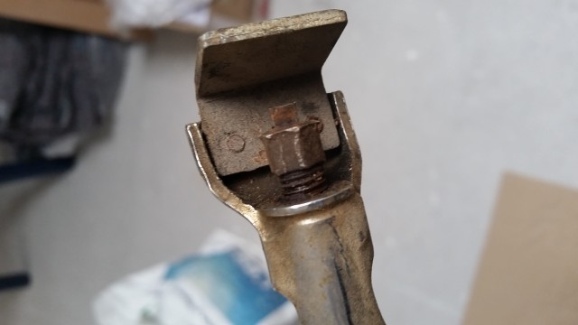

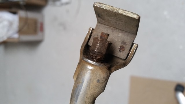

I purchased this rack on ebay, but it lacks front mounting points/plates as is seen from the attached pictures.
Can anyone help me with detail photos of front mounting points with all the dimensions to re-fabricate this mounting points.
Before I start to restore the rack I need to solve this detail.
Any help would be appreciated.
Pics...

Missing detail...front part of the rack...
IPB Image
IPB Image

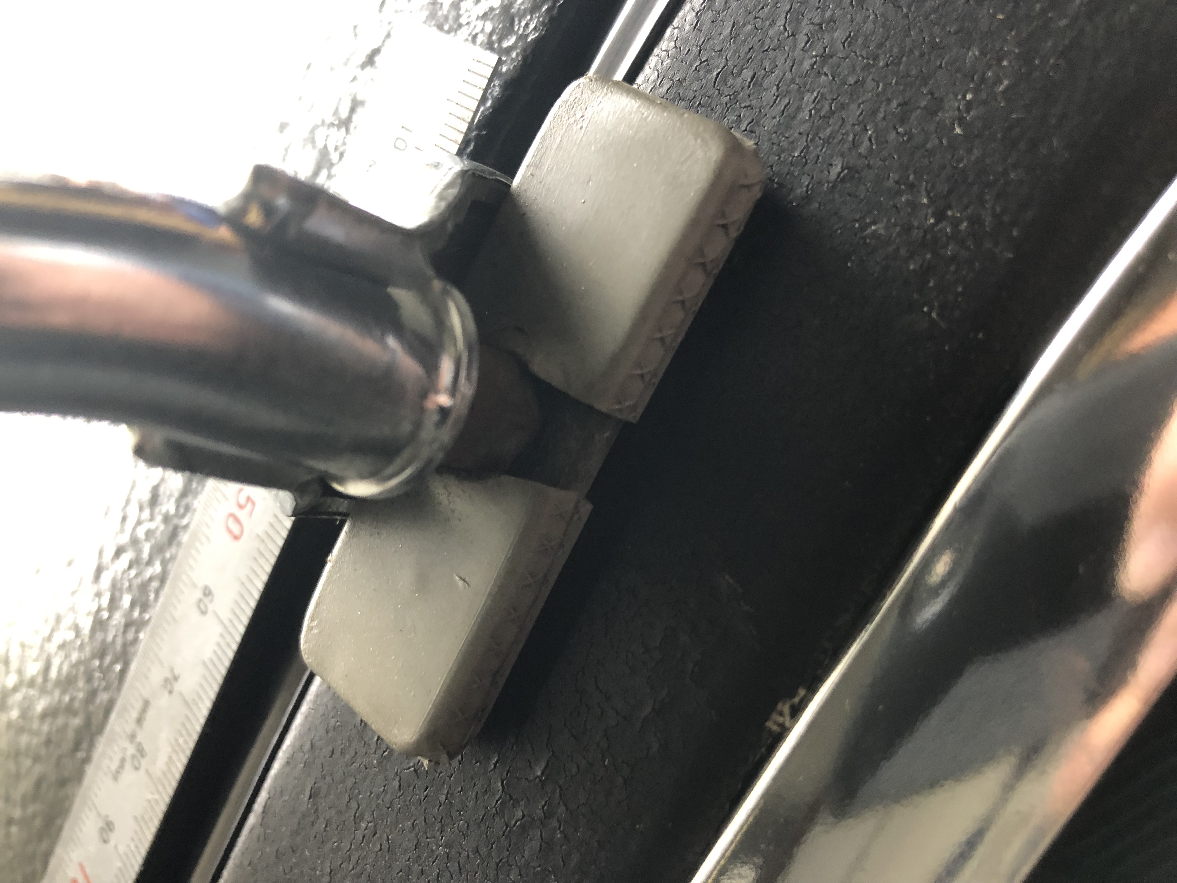

You are missing the screw-down feet that actually firm up the clamping action of the front rack. Those "L" brackets pictured above are what goes into the A pillar slots, but the steel/rubber coated/sleeved feet are what you need.
The picture Bowlsby posted has a pretty good shot of what you are after.
Kudos that you at least have what you have. My racks are installed on my car in the garage, I might be able to take more photos of them for you tomorrow.

Yes, my rack has the L-brackets like posted by @Chi-town .
Detail on @JeffBowlsby picture is great, but to recreate this part I would need different angle photos and dimensions.

Larmo63
The feet are approximately 50mm long x 15mm wide.
Nothing fancy.
You really just need two pieces of flat stock, slightly rounded on the ends, fitted to the screw down parts.
You could then Plasti-Dip them in grey?
