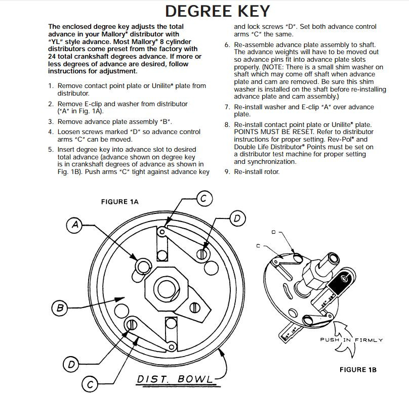

If you can find an old Mallory distributor they have an advance mechanism that is easily adjusted without having to use a distributor machine.
