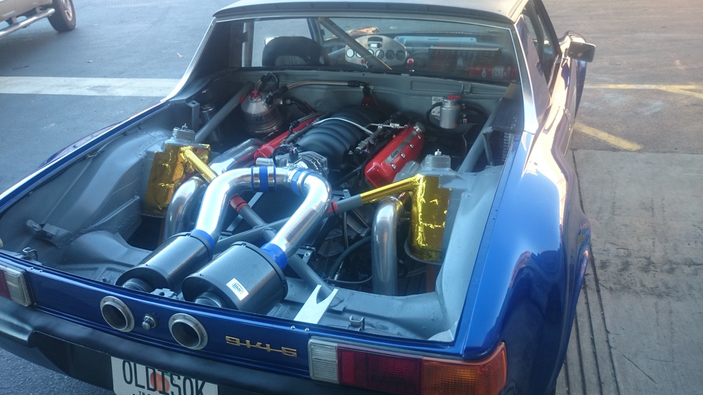

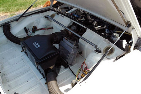

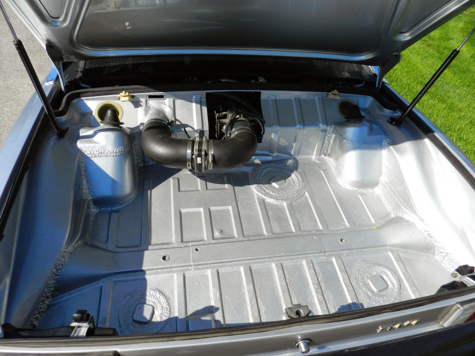

First I just want to say that these cars I posted pictures of are all beautiful works of art. But has anyone used an Individual throttle body (ITB) manifold on their LS swap? Low restriction, looks cool and you wouldn't have to cut the cross member at the front of the trunk. Thanks for looking. Click to view attachment Click to view attachment Click to view attachmentClick to view attachment

I have the white one in the first picture.
I've considered ITBs for looks. Chris's LS with ITBs looks stunning.
I wouldn't do it for additional power. And if you look at a cross section of an LS6 manifold it looks very much like ITBs. Plus I would have to redo my firewall to make it fit. But, it would look killer.

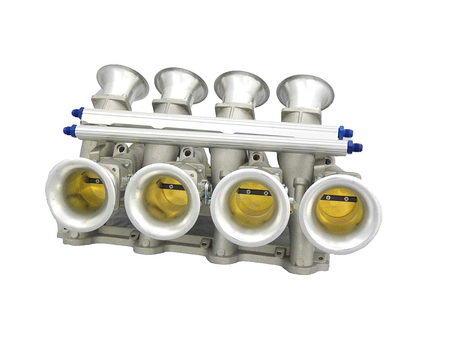

Be careful and do your research on the "inexpensive" ITBs. I did ahead of getting the Borla set up. The cheap ones are cheap for a reason. Alignment issues with the shafts, very hard to get them to sync.
And depending on what room you have and orientation of the intake runners, check out the Jenvey's, too. They make a nice product, as pictured.

Thanks for the tips guys. That Jenvey's set up seems like a nice compromise between quality and price. ITB sure do look good on an engine.
