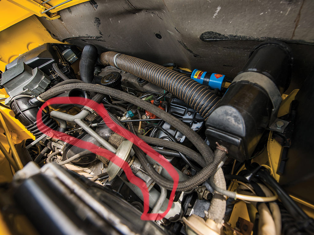

troth
Apr 12 2019, 05:57 PM
Is this some sort of plumbing? Looks like it goes to the thing underneath the AAR. I have a ‘75 1.8 as well but don’t have anything resembling that. Is it something for the blower motor? That’s something else I’m missing.
JeffBowlsby
Apr 12 2019, 06:05 PM
That's the EGR valve and its plumbing. CA-only models, 49-state cars did not have it.
