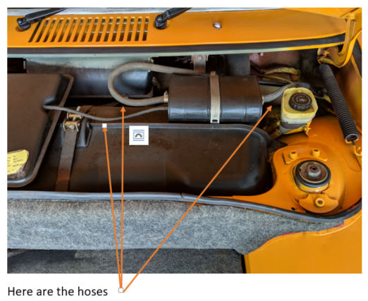

Hi All. My 1973 signal orange is out of winter storage and I am ready to start this years projects. Making a list of parts needed and trying to figure out what I need.Not sure what the part numbers are or where to find them. Didn't find on 914rubber or AutoAtlanta but did find these on AA AAA20100074 but they are for lower fuel lines.I plan on replacing the blower motor and already have the refurbished one and will get the 914rubber air grill and gasket kit "while I'm there".Anyone know what the part numbers are for those three hoses? The skinny one and the 2 fat ones and where to find them? Mine are looking a bit old and I expect them to fall apart when I take things apart.

Look here:
Bel-MetricCompare ID and OD to what you have. They have lots of stuff that's applicable to our cars.
John

porschetub
Apr 14 2019, 10:35 PM
Measure all your I.D.'s and check on Pelican ,they have a huge range of cloth covered hose for various cars they list parts for,cheers.

All the vw suppliers carry those hoses. Even vw shops will have an inventory on hand.

Click to view attachmentThe large ones should be 12mm and the small 4mm. Pelican carryies both fabric brain and smooth cover hoses in those sizes. As I recall the 12mm is about $12 a foot for fabric. If you do not care about originality the smooth rubber cover hose is better.

we have all of the individual vacuum lines for the evaporative system individually detailed in our factory authorized hard parts drawings.
Since we restore 914s here every day, it is very important that we have every part we need here to do a thorough job and or a solution to any 914 stock problem
