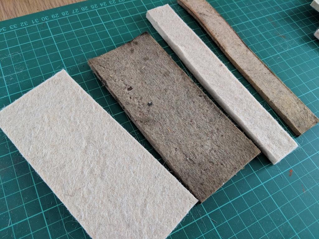

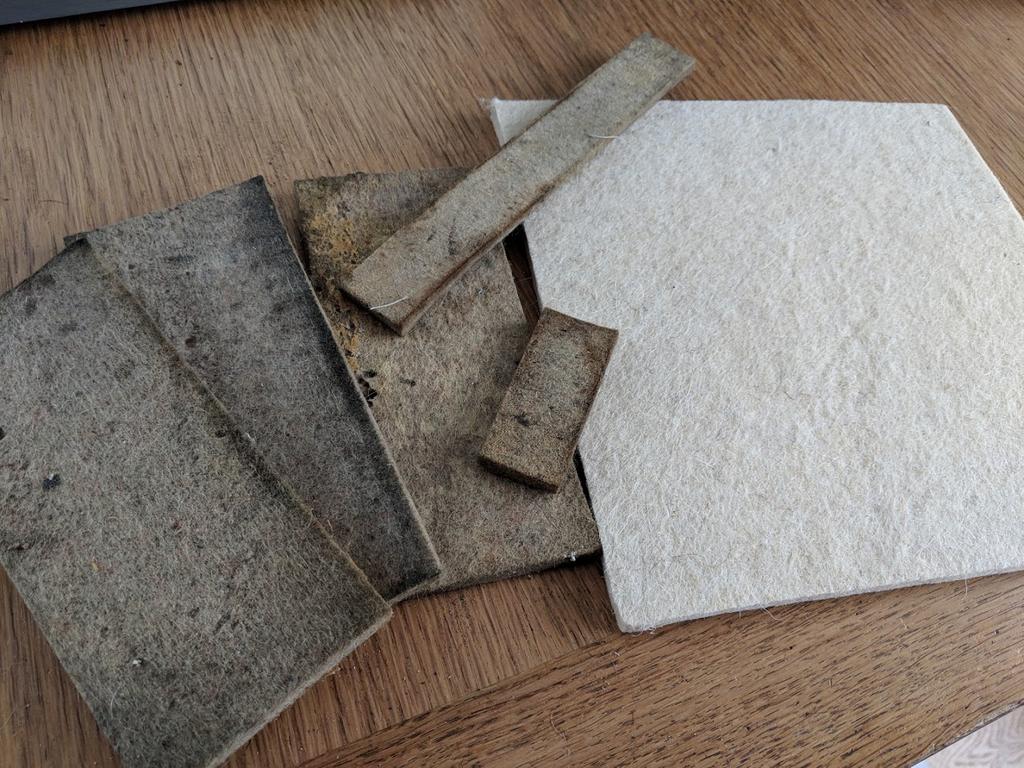

defianty
I decided to replace mine with as close to original as possible. After 45 years there was no sign of rust on my car and after it's restoration is complete it won't be left out in all weathers.
After a search around I managed to find a very close substitute felt in Germany ironically.
IPB Image
IPB Image
https://www.ebay.co.uk/itm/Wool-felt-fabric...872.m2749.l2649
One 6mm thick 20x20cm square piece is enough to replace it all. Once measured out it cuts well with a sharp craft knife.

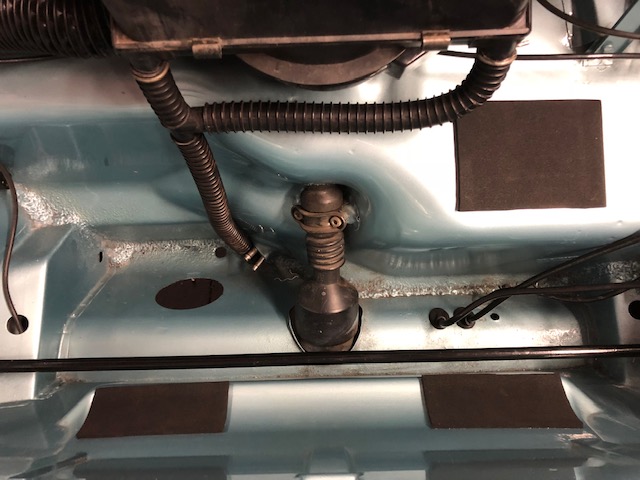

shane
Thanks for the link, I was at Walmart and found these there. Not exactly the same they have a thick self adhesive back Side that’s kinda stiff and doesn’t want to bend much but they were $2.88 and in front of me so I bought them to try. There just under 5mm thick and might be good enough to do the trick.
