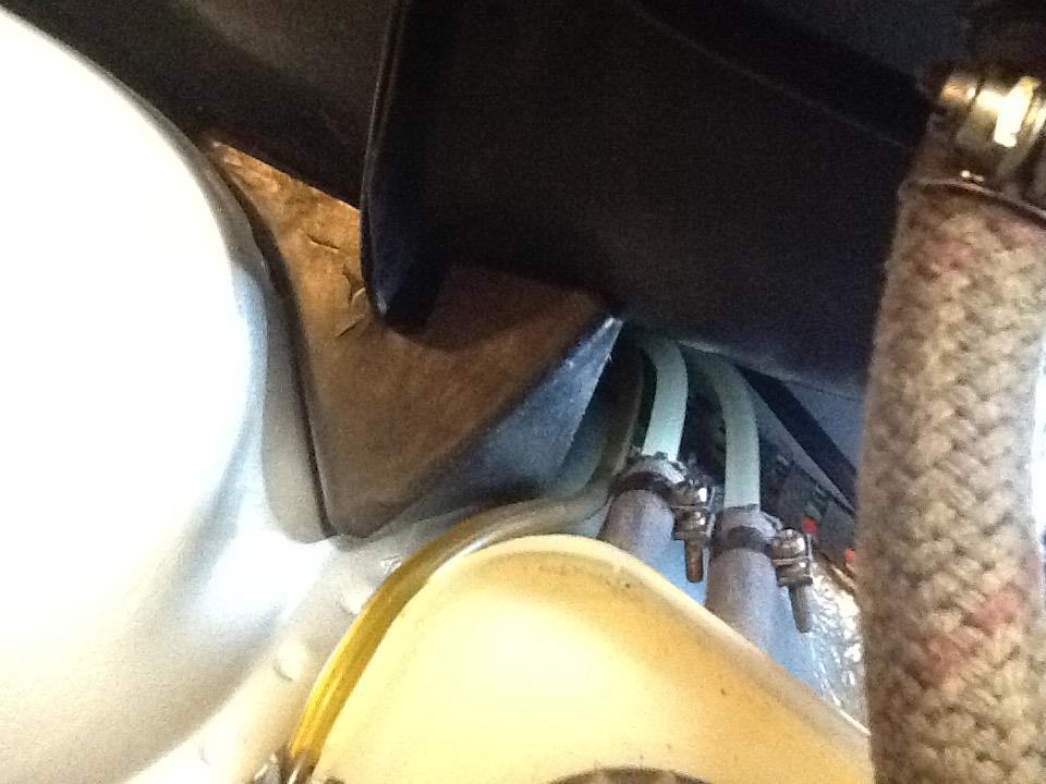

Garland
Here’s a few pictures,
Gatornapper
Garland -
Thank you! I finally figured it out looking at wear marks after a guy told me the went on the sides - I earlier concluded the slots meant they went on the rib/seam....the one on the driver's side will even sit in place on its own.
But you've confirmed my thoughts - thank you so much for taking the trouble of taking the pics and posting them.......
