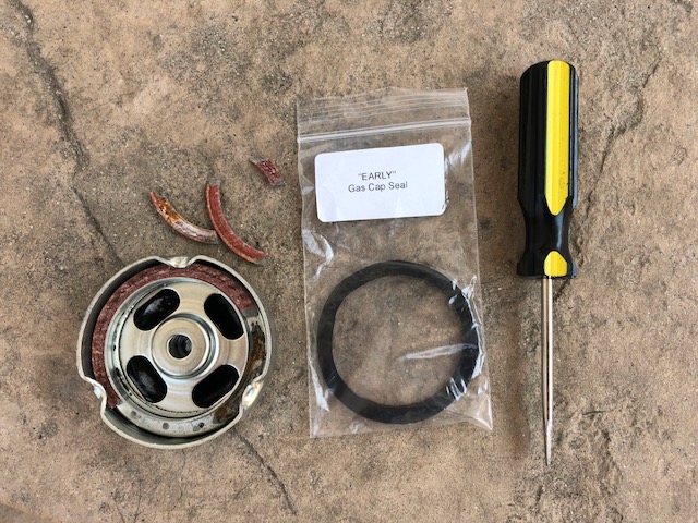

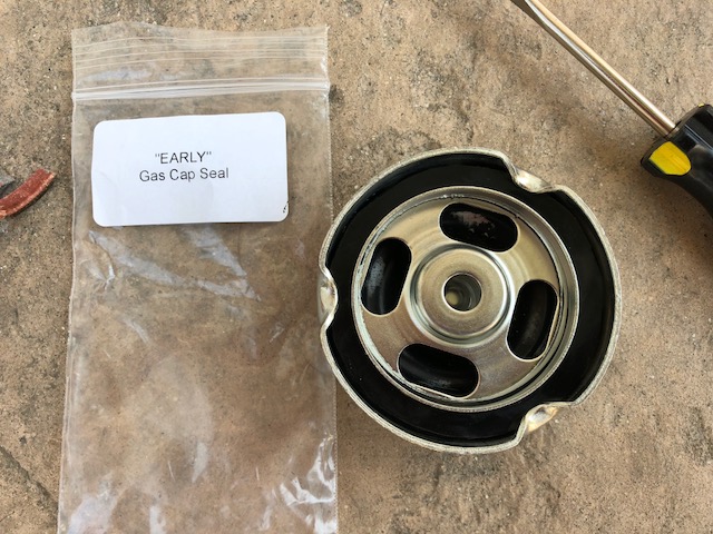

914_7T3
914Rubber Seal is the way to go!

I had bought one of these a few years ago, and was surprised how thin it seemed. I was told that it was meant to go over the fiber gasket. Is this still the case (I saw in the previous post picture the fiber gasket was being removed).
Did not know that, what say you @Mikey914 ?
I'f that is indeed the case, I'll try and pick up a second one and get that corrected. Thank you.

I haven't installed mine yet because I had this same question. popcorn[1].gif

I removed the fibergasket on my car and it works great.
I will work on updating the installation instructions on the site.
