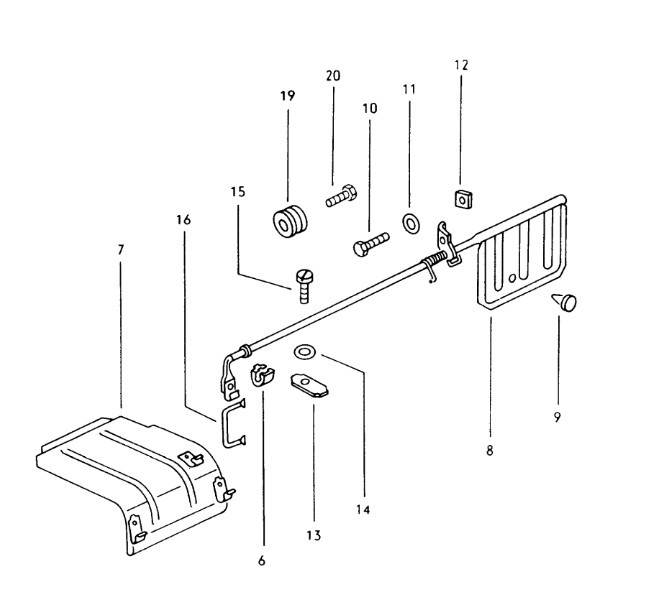

I was proud of myself for finding #13 in the diagram below in my miscellaneous parts hoard, but now I see there is supposed to be two of them so I need to find another. Anyone reproduce these or know where to buy one? If not, I may try to scrounge up a piece of spring steel and cut one myself.
914Sixer
Diagram only shows one but two is better. I picked up a second one on WTB in classified. Probably real easy to duplicate with any thin metal.

Yep, diagram shows one and IIRC all the engines I've owned just had one over the flapper spring, but the PET lists a quantity of 2 required in the catalog. The original is .025 spring steel and a hacksaw blade would be a perfect match for thickness and temper but is just a few mm too narrow. Same goes for a utility knife blade but even closer to being wide enough. I'll keep scavenging and post a WTB if I don't come up with anything. It will be easy to make if I can find the right stock.

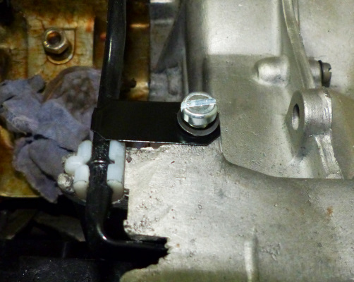

@bdstone914 the banding worked like a champ. Thank you! FYI for anyone who needs to do this. Metal banding has gotten kind of hard to find. After striking out at all the big lumber and home improvement stores, I found some at the local farm and ranch supply used to bundle fencing materials.

Superhawk996
@bbrock
I can't believe you took the easy route and painted it. Would have expected plating.
I'm going to need to do the same someday - some joker completely yanked my flaps!
bbrock
QUOTE(Superhawk996 @ May 7 2019, 02:23 PM) *
@bbrock
I've been known to plate parts before painting so how do you know I didn't plate these? Okay, I didn't. Just trying to match what the Germans did so painting is correct and plating would have jacked up the coefficient of friction poke.gif
