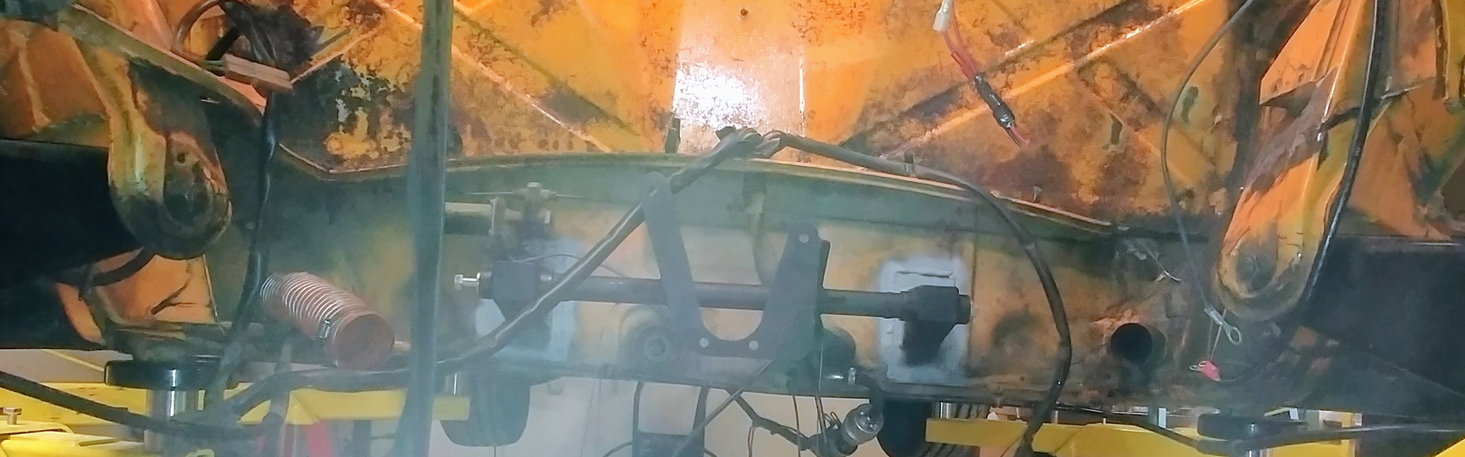

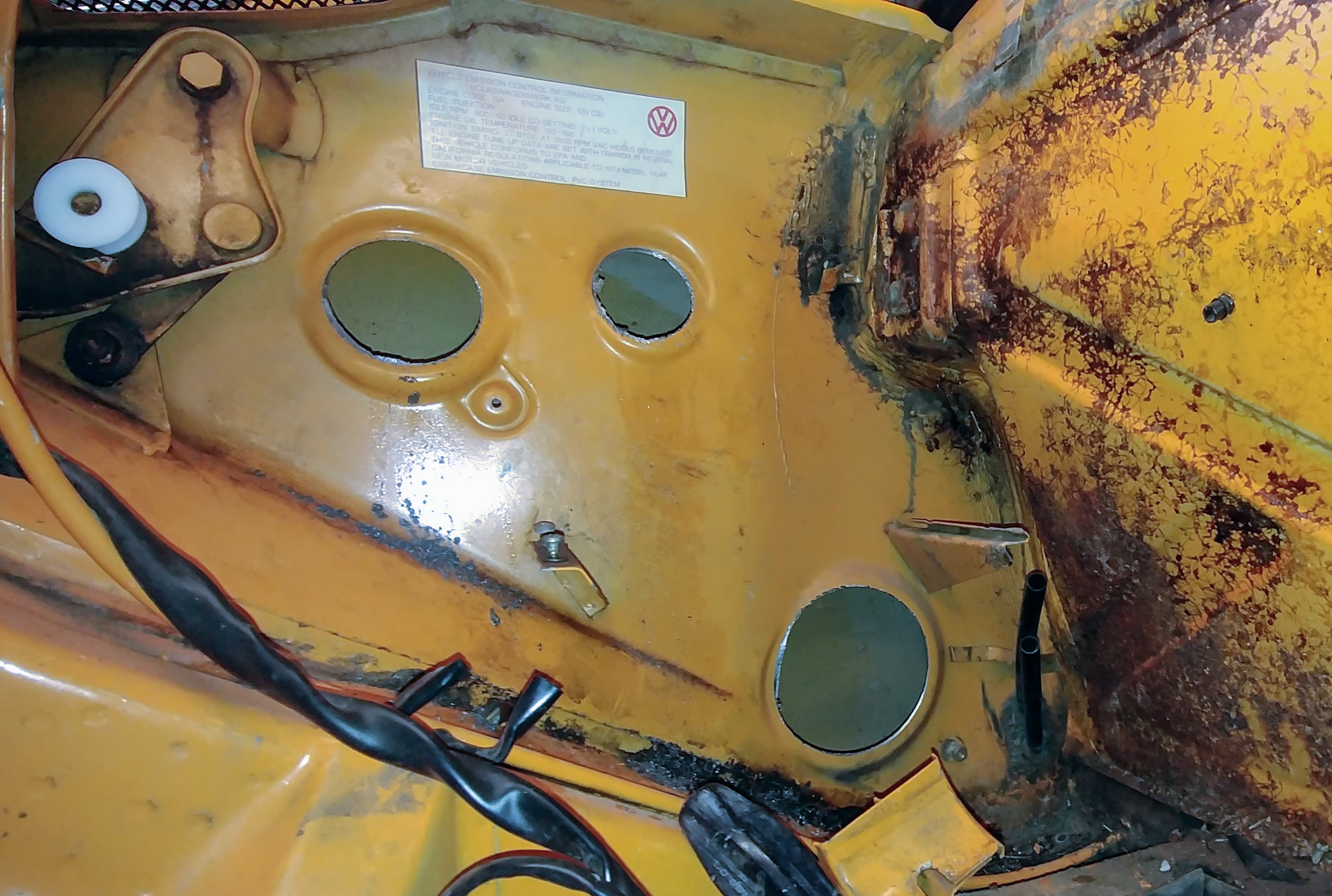

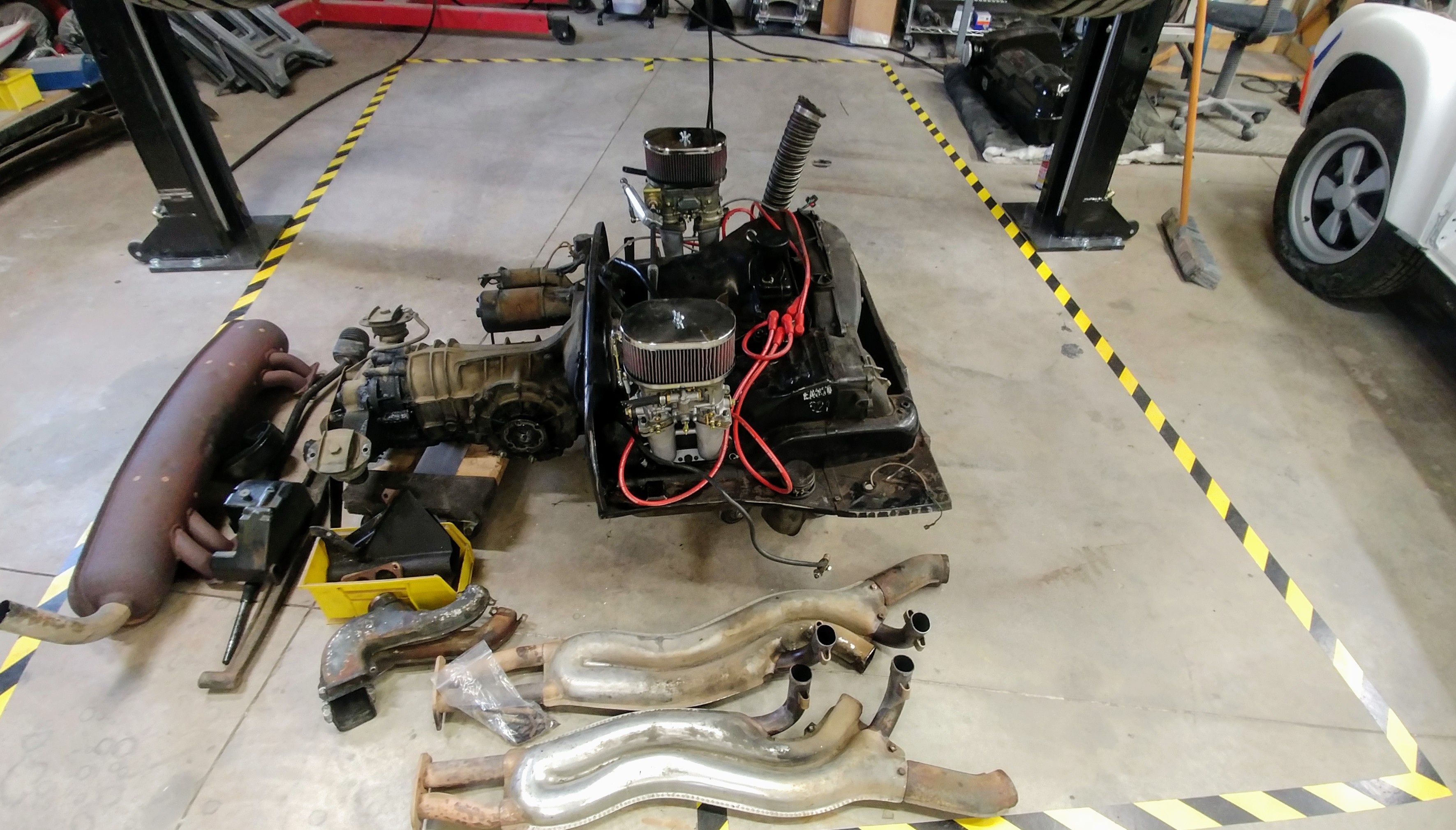

Here is the engine prior to my removal.. Hopefully today it will come out.

mb911
Apr 27 2019, 12:39 PM
Engine out took me longer then I remembered at 1.5 hours. Now it's time for all 4cyl parts to leave. I need the room.

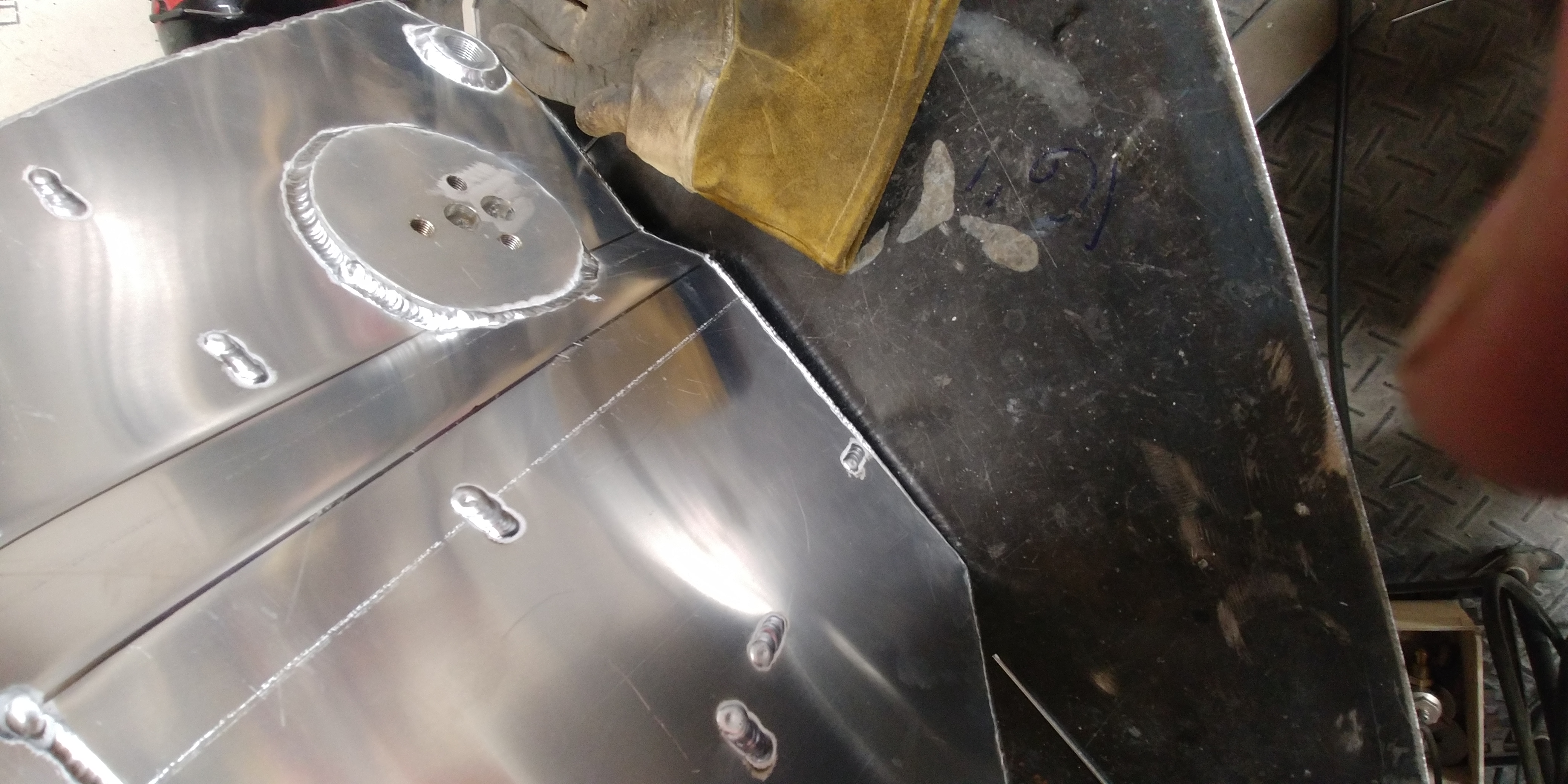

On another note welded the tank today.

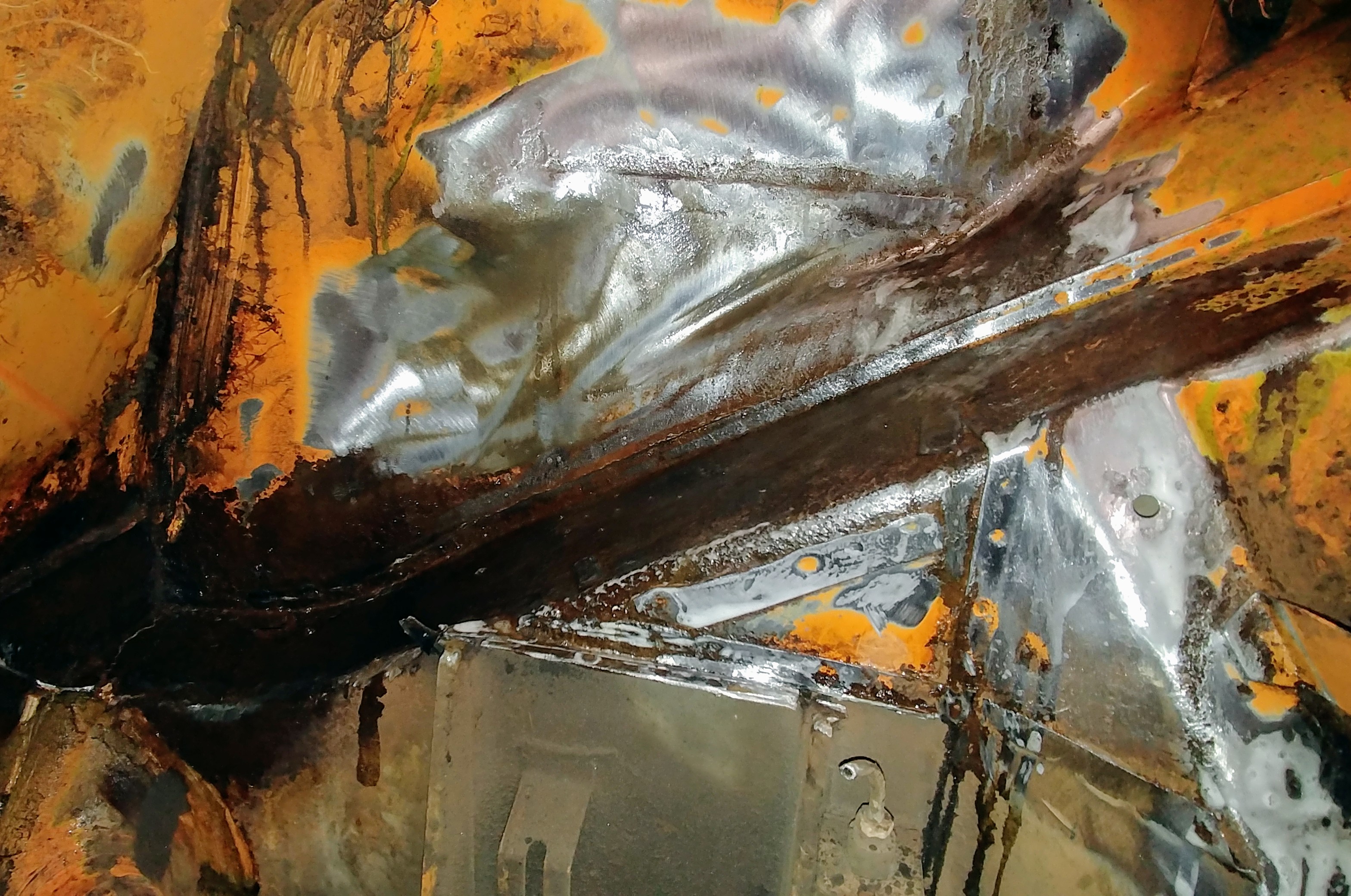

May 5 2019, 08:14 PM

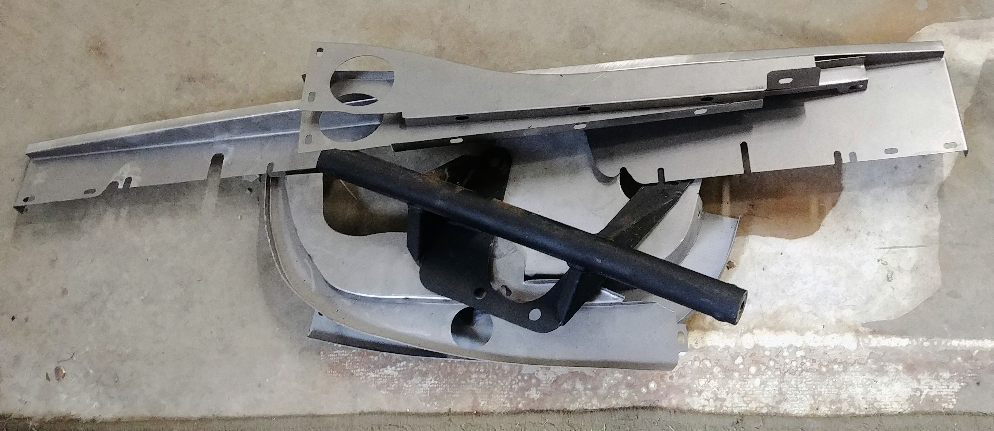

Spent some time drilling holes for the tank and then making the decision to replace the engine shelf. Also the battery tray is out along with engine mount in.
Click to view attachment Click to view attachmentClick to view attachment

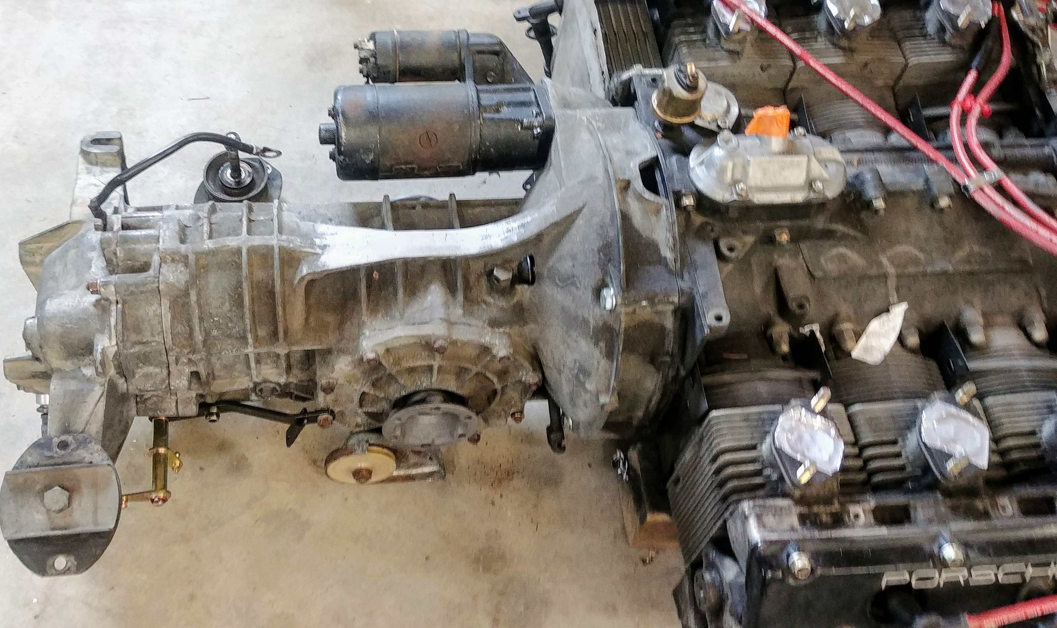

Engine is here , new clutch, trans rebuilt
@914ltd and throttle linkage

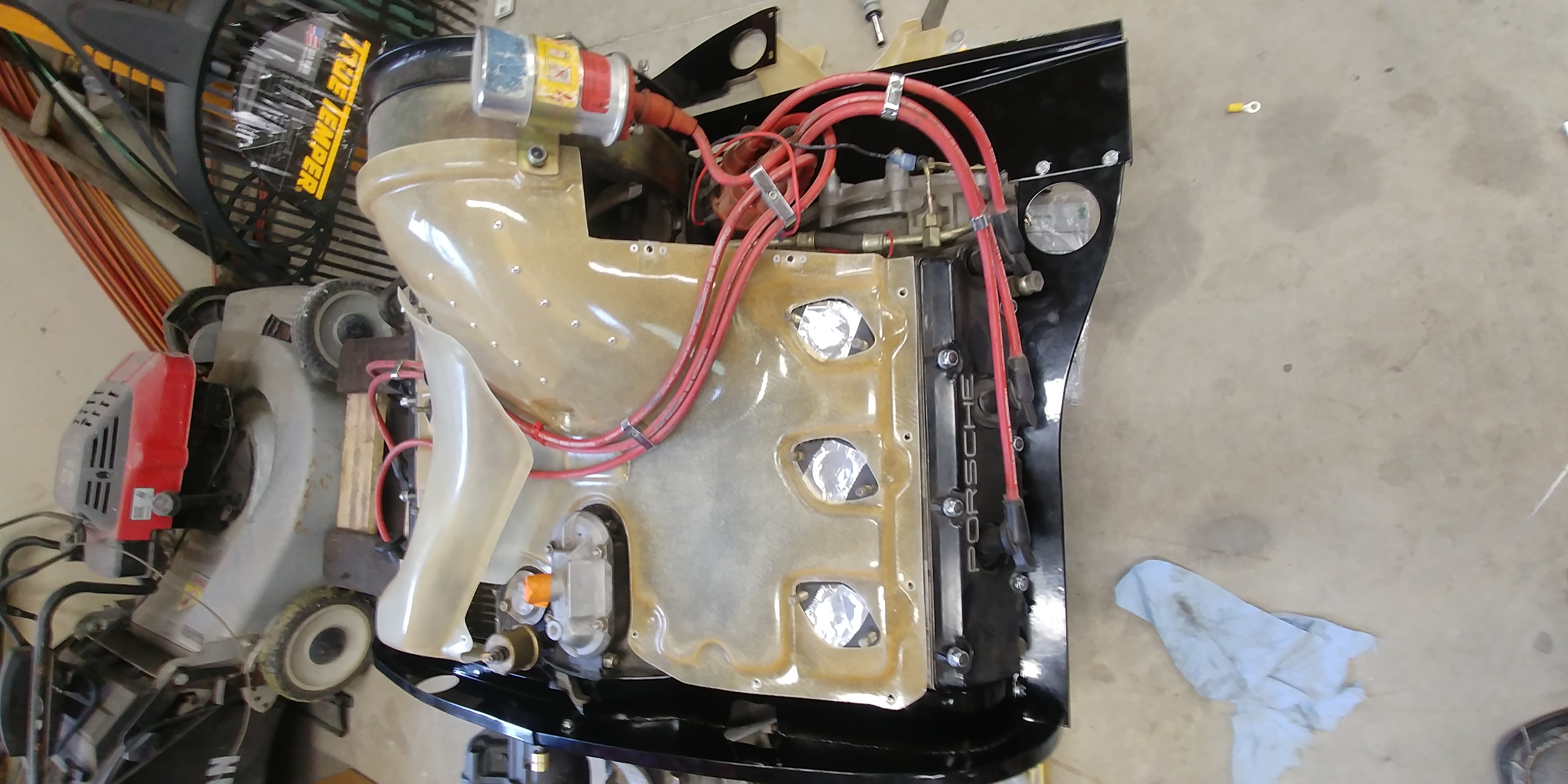

Jun 11 2019, 05:50 AM
mb911
Jun 11 2019, 05:52 AM
Tdskip
Jun 16 2019, 07:11 AM
Nice work Ben.
Is that plastic translucent.
mb911
Jun 16 2019, 07:47 AM
QUOTE(Tdskip @ Jun 16 2019, 05:11 AM)
Nice work Ben.
Yes it is.. Called "Amber" cooling shroud..

Jun 21 2019, 07:36 PM

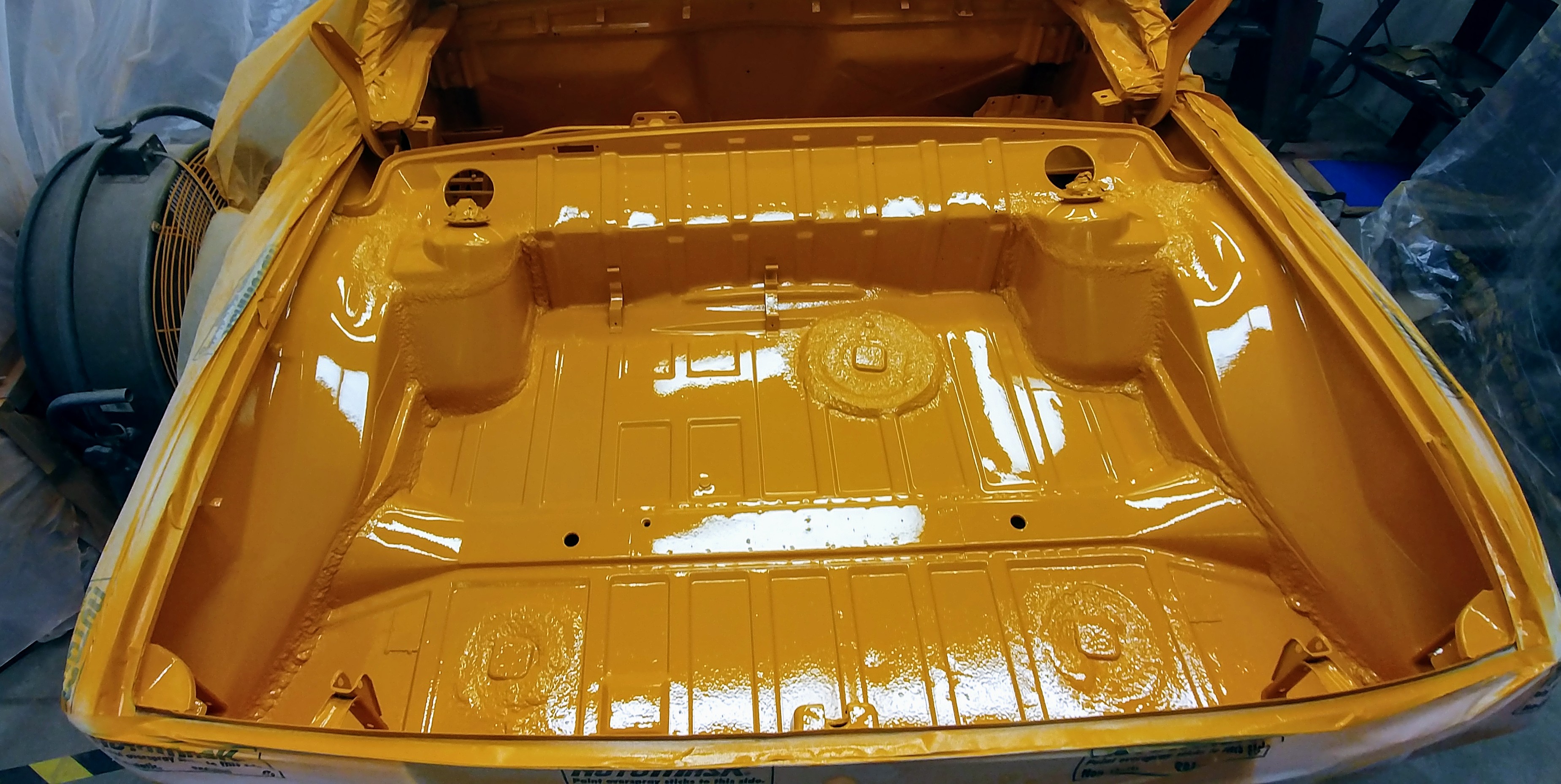

Underside of the trunk painted.. I just cleaned up what was there previously /scuffed and painted..

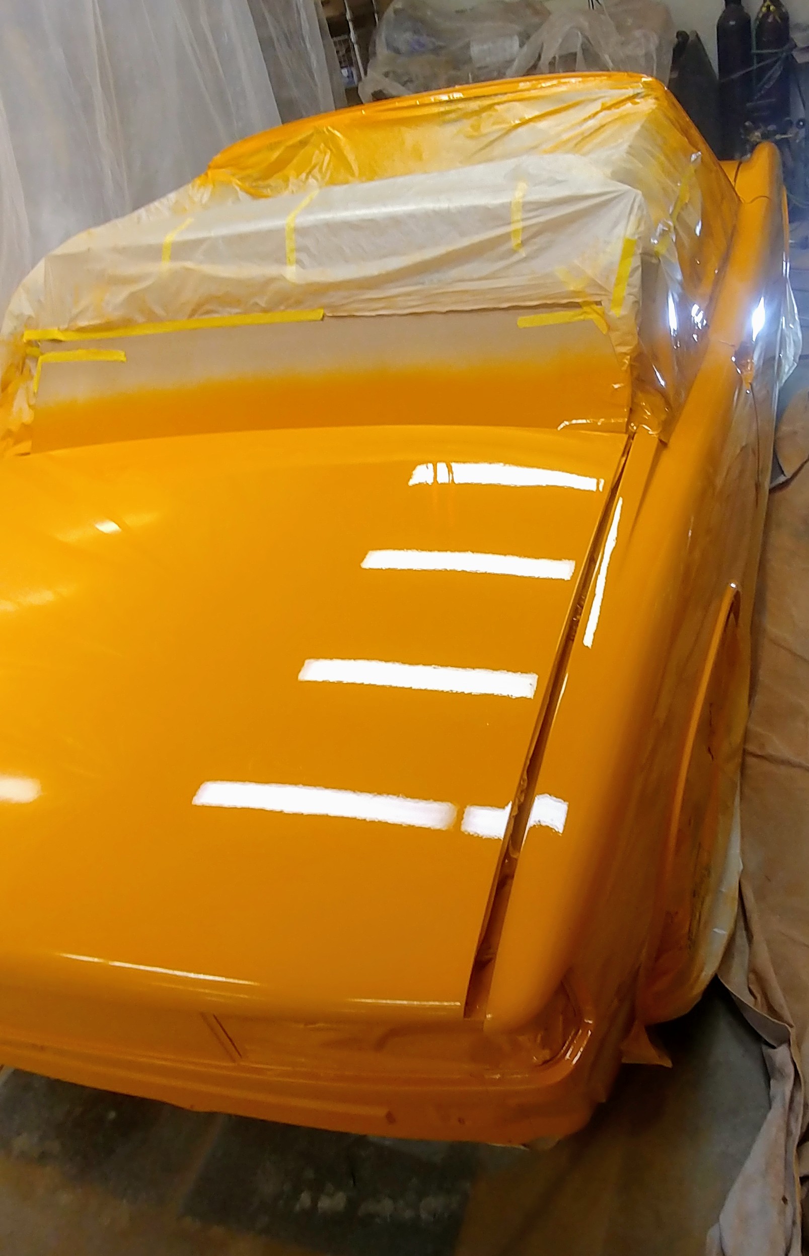

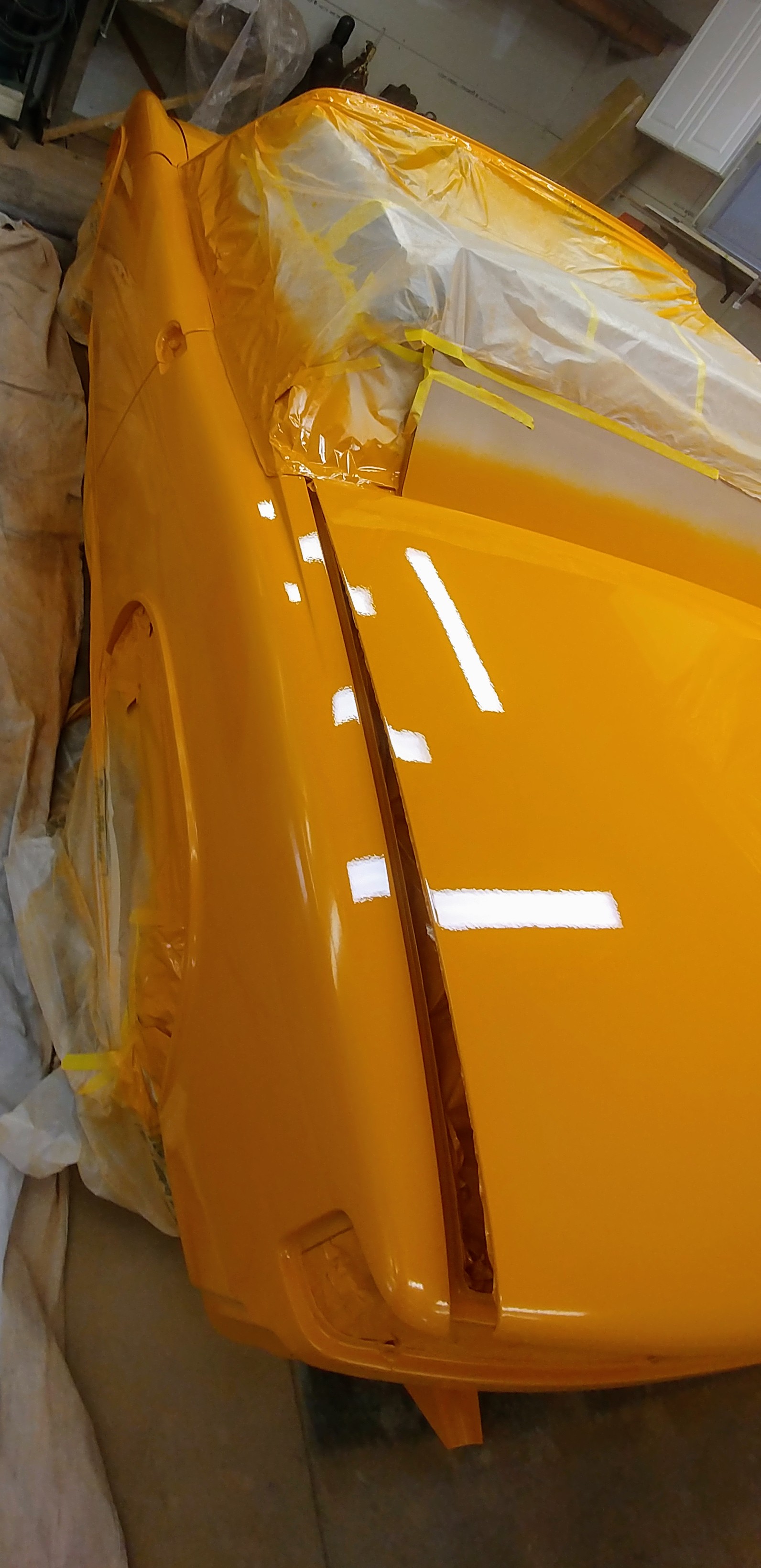

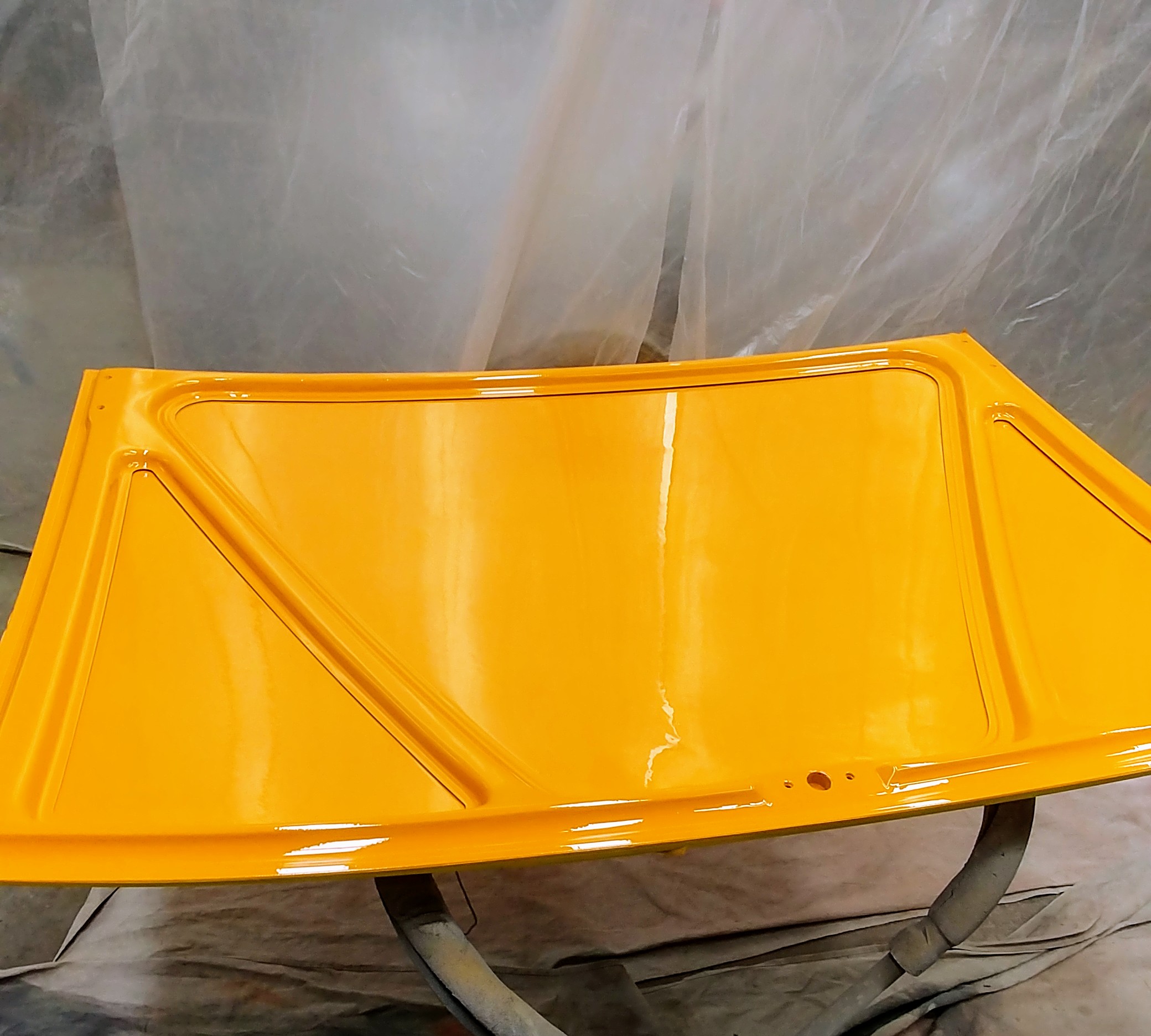

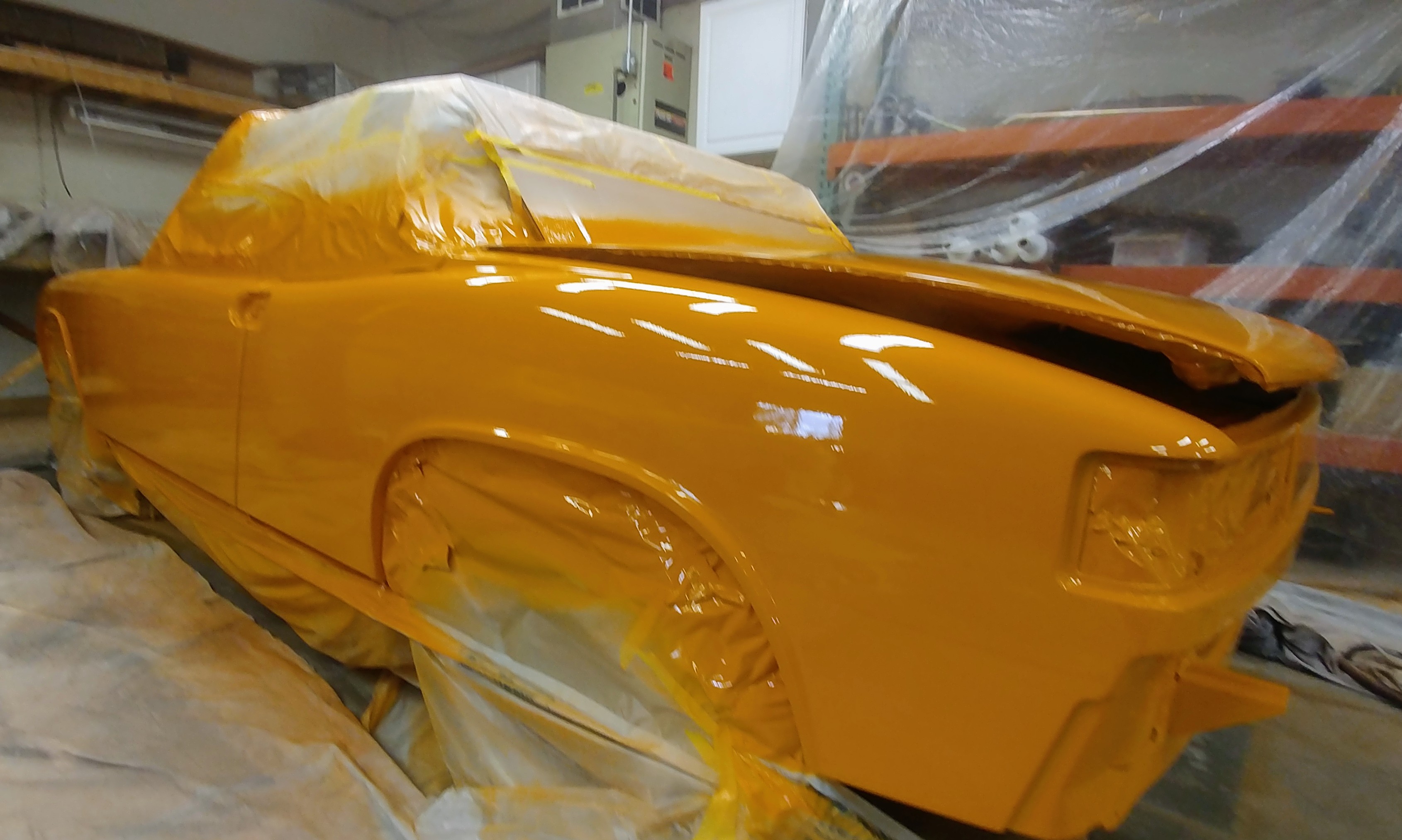

Aug 12 2019, 02:04 PM

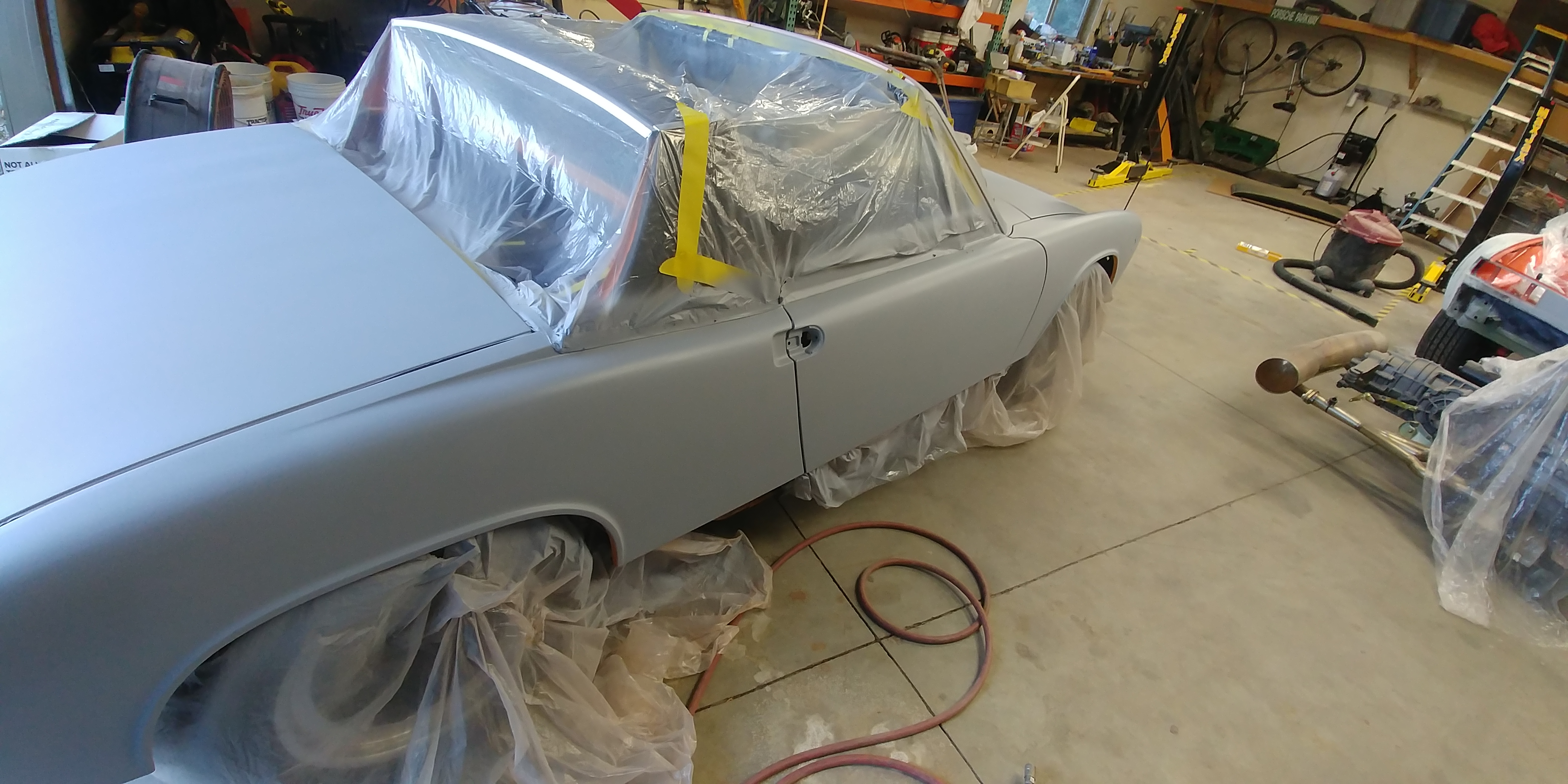

Blocked then sprayed 3 coats of primer surfacer.. Then sit and do any shrinking.. Will block this week and then a once over next week before paint.

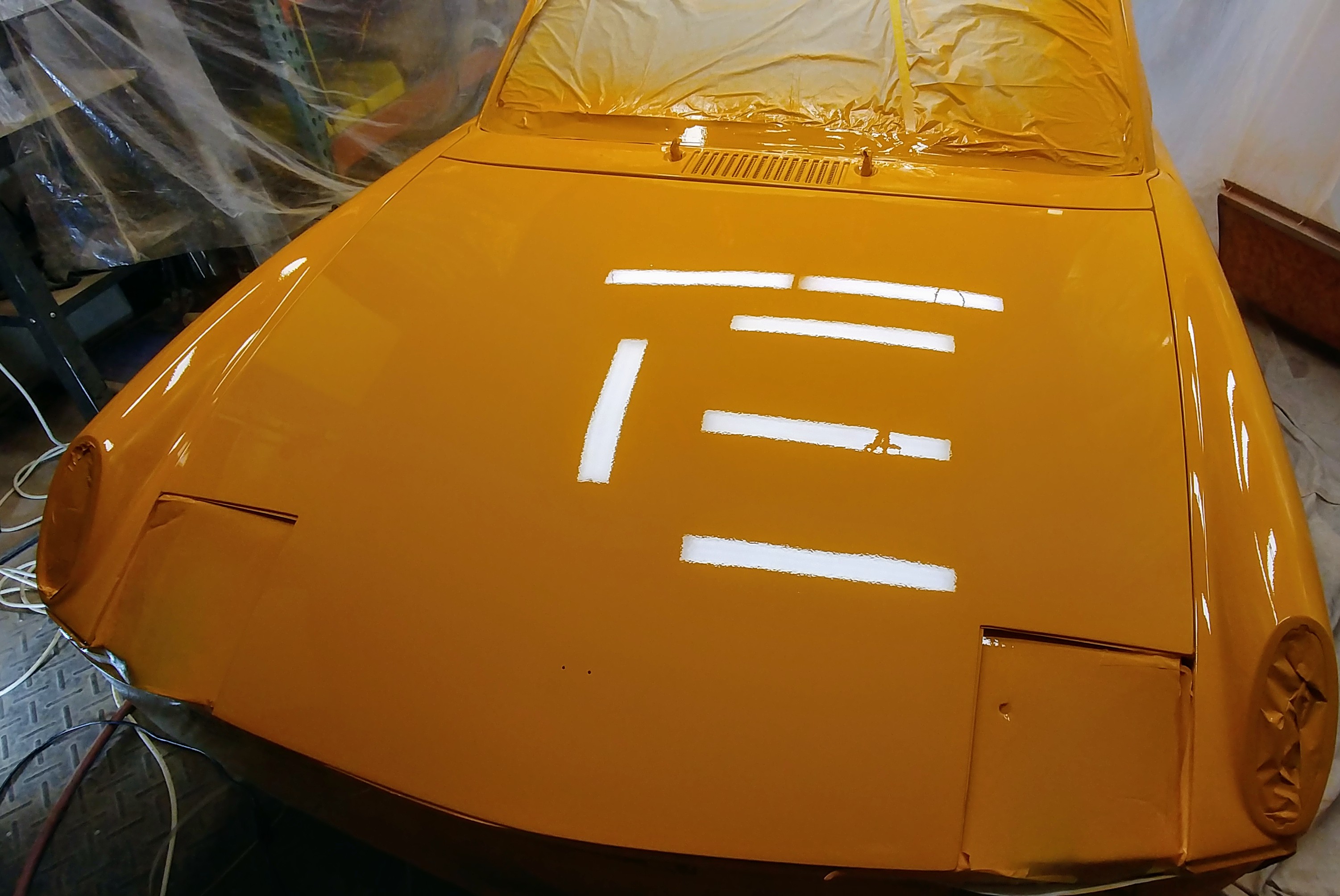

Aug 21 2019, 09:39 AM

Aug 21 2019, 09:43 AM
That is going to look fantastic Ben, nice work.

mb911
Aug 21 2019, 11:04 AM
Need to finish his project so I can finish mine, and we are planning on moving soon so allot going on..

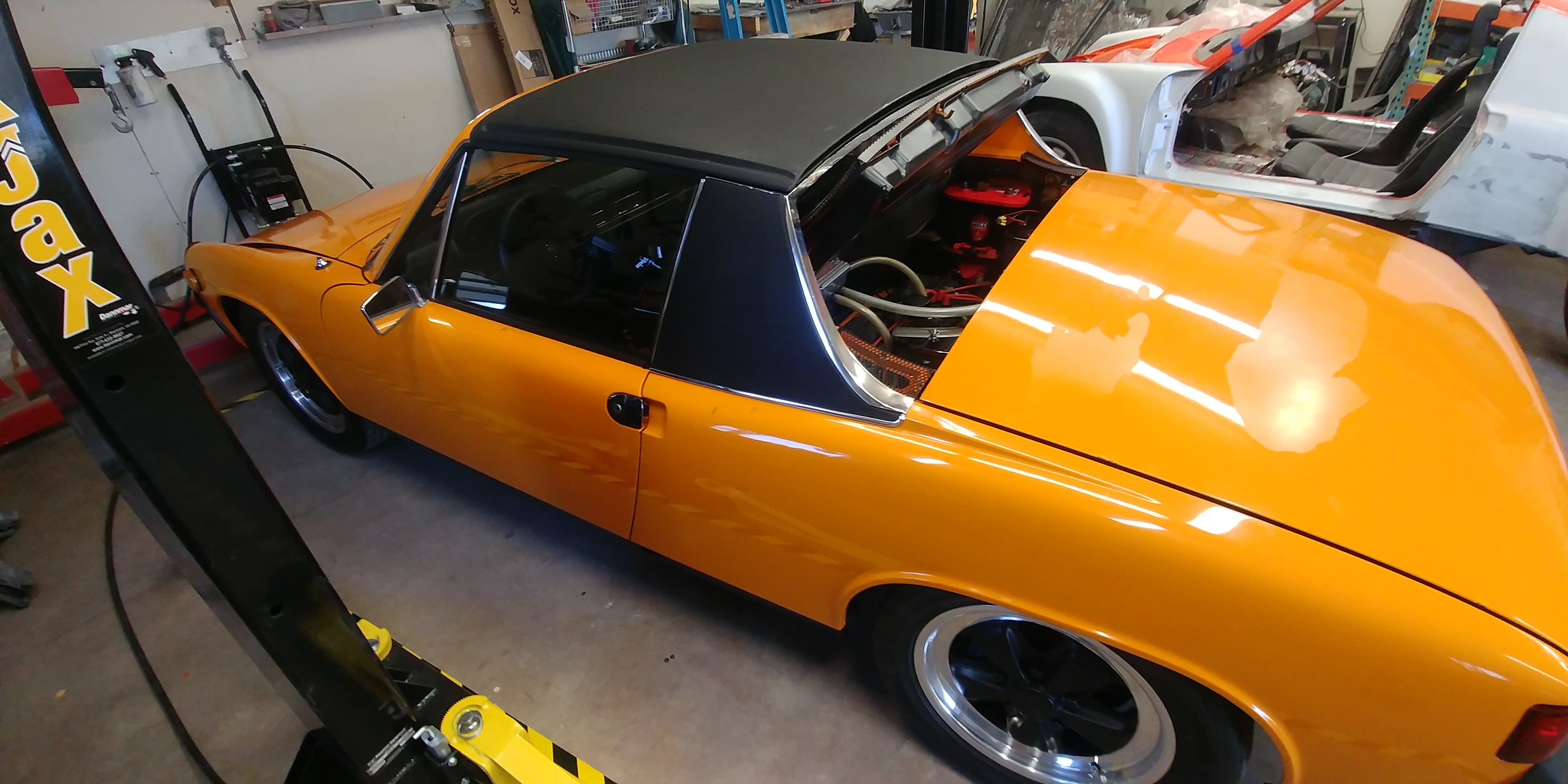

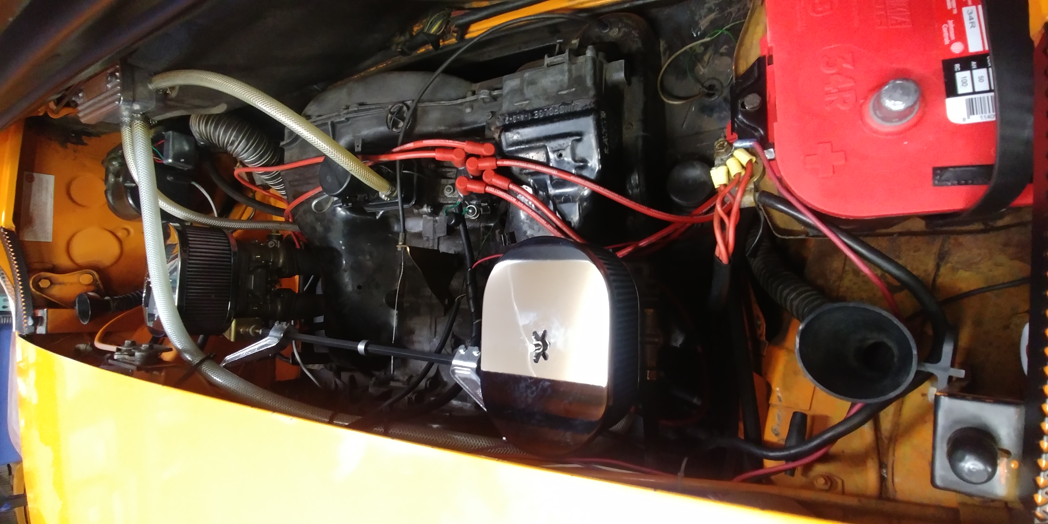

mb911

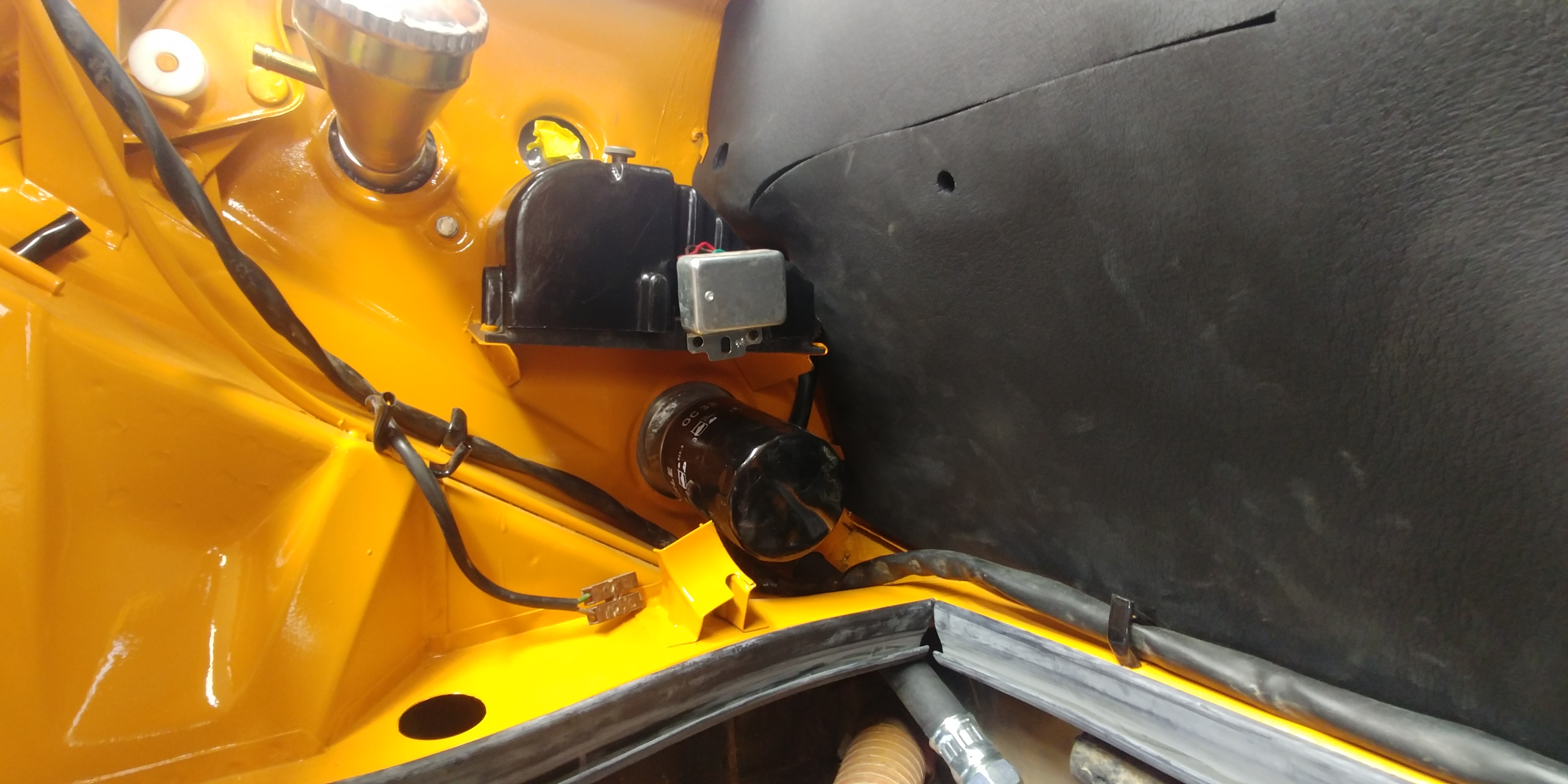

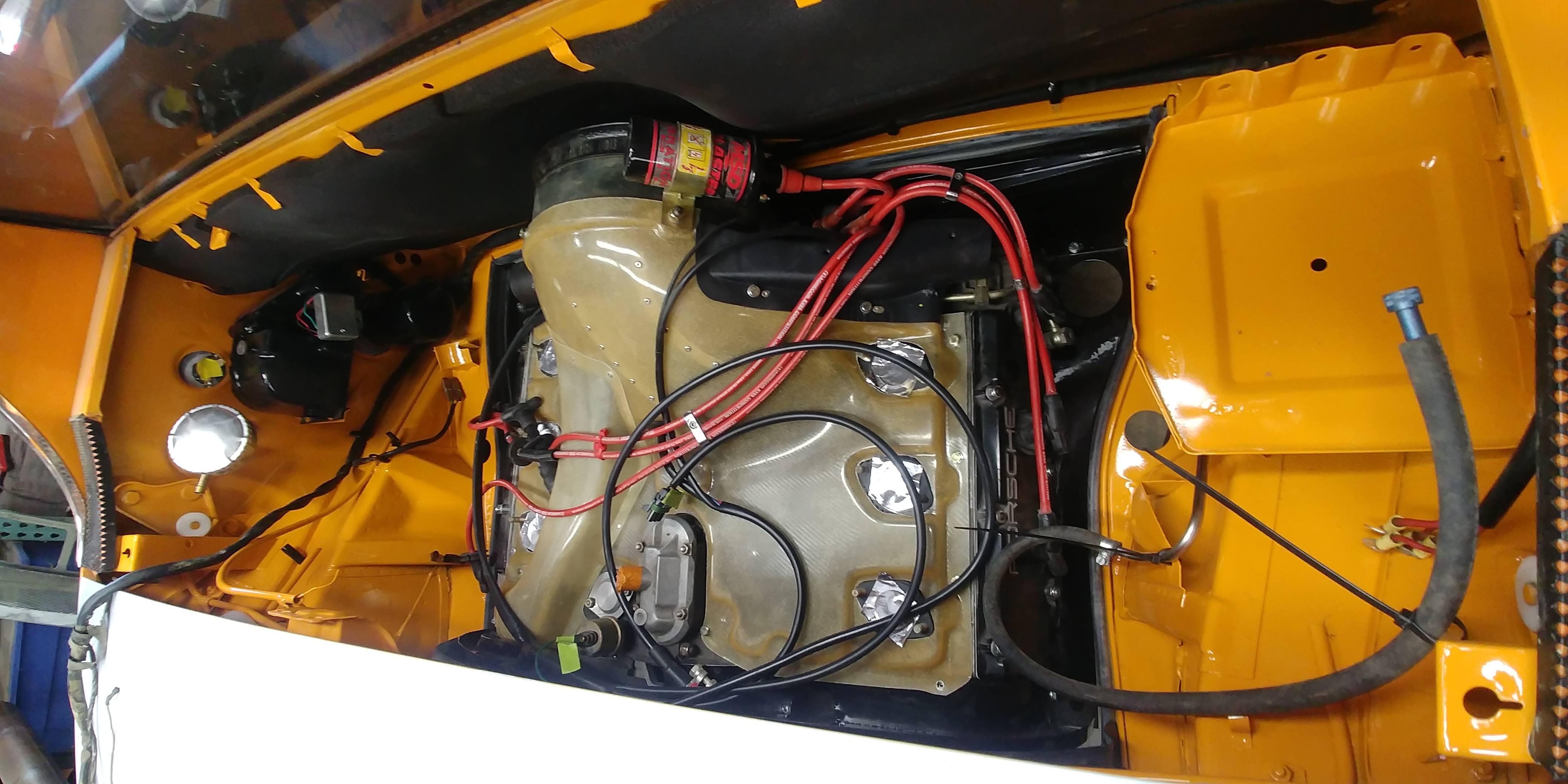

Sep 2 2019, 06:36 PM
Car is running.. Yeah.. Just have to finish some odds and ends and this will be a wrap.
