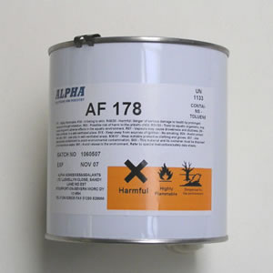

defianty
I spoke with the painter who confirmed the paint is dry enough to stick on the vinyl so that will be my next job.
I've been using this glue on the car for the carpet and interior vinyl and will use it again for the sail panels.
IPB Image
https://www.woolies-trim.co.uk/product/1263...istant-adhesive
It's a high heat adhesive used in the trim industry and widely used to install vinyl roofs on classic cars.
