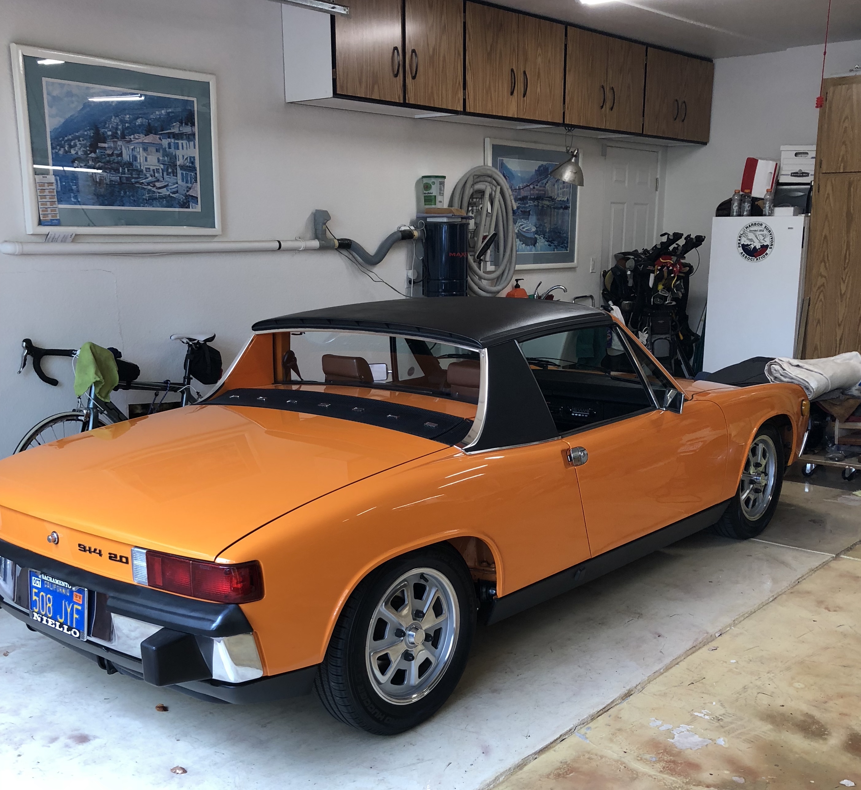

I was able to get back to car this weekend and installed a new two port fuel pump. I’m happy to report that the car is running again! Tomorrow I’ll mount the pump and hopefully take it for a ride after i set the timing.
I want to thank everyone again for all your suggestions. I learned a lot through this process and will be better able to tackle the next challenge when it comes.
Jack
Minerva's 914
Jun 30 2019, 12:25 AM
Great news!
Thanks for posting the photo of your 914, she's a beaut
