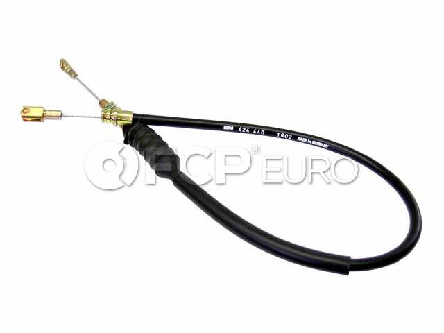

I would like to get some of the rubber bellows that 914 Rubber has, but how in the world do you get them on. Both ends of the hand brake cable have fittings swedged on and both bellows have 1 very tiny end.
This cable from FCP euro has a bellows on one end.... The caliper end has an even bigger connector, how in the world do you get a bellows on that?
fcp EURO part
